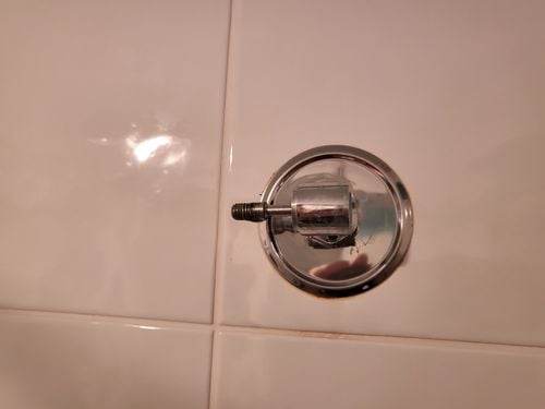

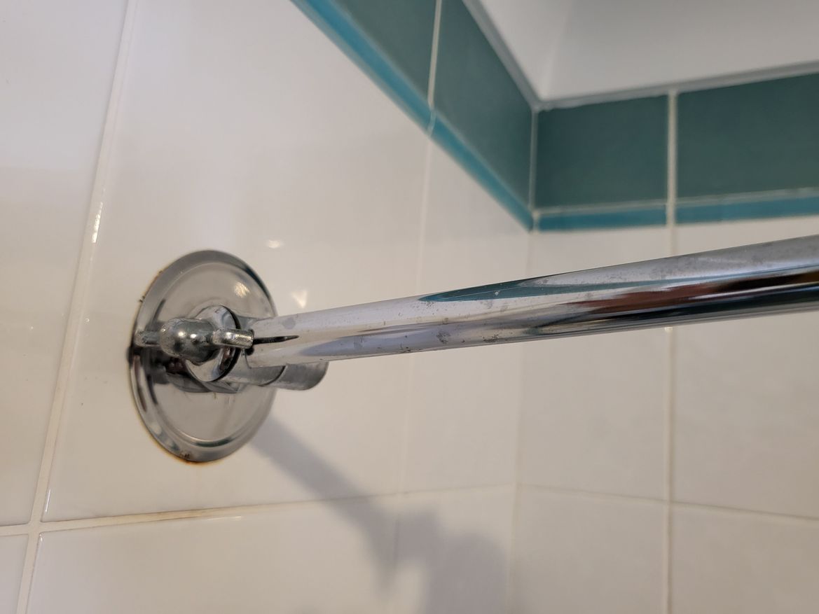

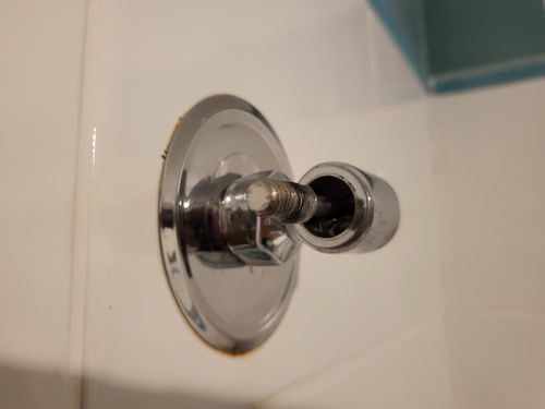

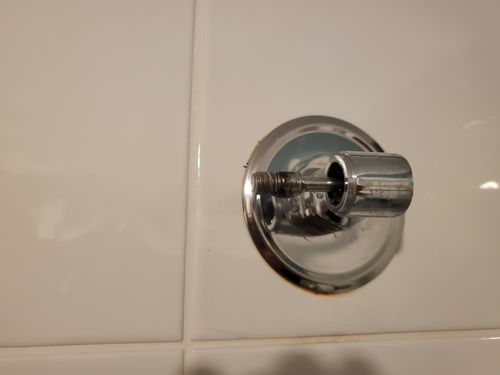

I just moved in a new property as a tenant and would like to change the fixed shower head which is leaking and very old fashing. When I unscrew the current shower head this is what I have (see pictures). Not sure what can I buy at Bunnings that would fit this. If possible I'd rather go with a flexible shower head instead of a fixed one. Thanks for your help!

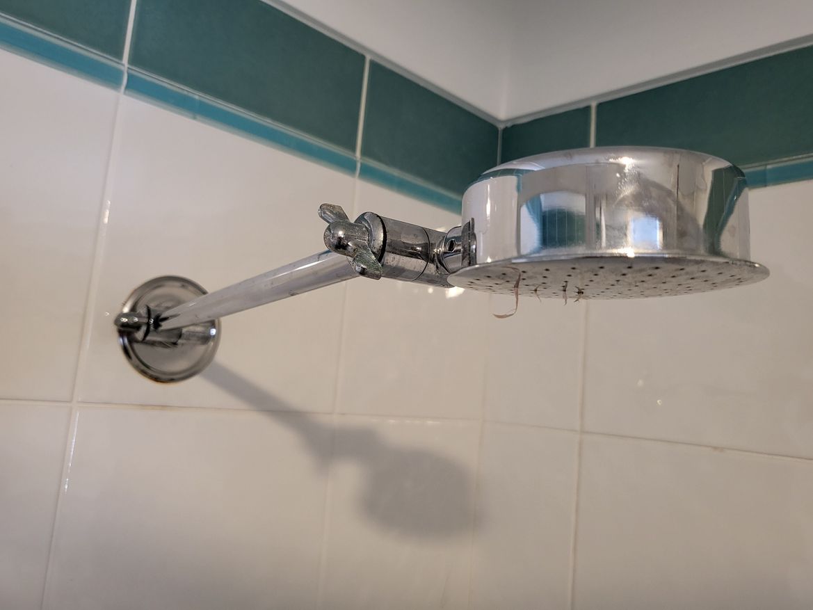

If that helps, this is the current shower head

The piece attached to your wall can actually be screwed off. I suggest using a Craftright 300mm Adjustable Wrench to turn the wall attachment anti clockwise to remove it. I also suggest having a look at this guide - How to change a shower head. You'll see a clear explanation of how to change your shower head into one with a flexible hose. I propose looking at the Estilo Chrome 3 Function Hand Shower & Connector Set, it comes with a multifunction head, flexible hose and is easy to install.
Hi Eric,
I've just done everything you suggested and working very well (and easy to do)! Thank you so much and Merry Xmas!
