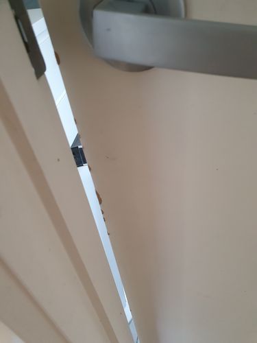

Hi
There r a few swollen spots appearing on outer side of bathroom door. Are they repairable??? If yes can anyone guide please
how to fix them.  M attaching a pic for reference.
Regards

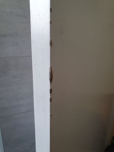

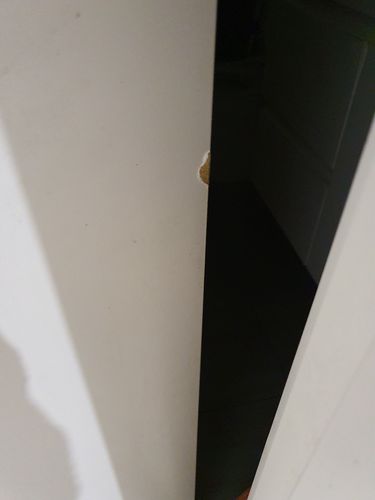

Hi Jason!!!
Thanks for ur msg. It is not vanity door . Ot is our bathroom entrance door. We r not sure why it is happening. M attaching another pic hope it will help.

Hi @arashid,
If the areas are swollen then it indicates water or moisture has penetrated into the MDF skins on the doors. You are going to need to sand the areas back flat, apply a undercoat similar to British paints 4in1 and then a topcoat of Aquanamel.
I note you have had a few different questions in regards to water damaged panels and doors. Is there an extraction fan in these bathrooms that is runs during showers/baths? The reason I ask is because the amount of damage you have is more than what would be expected in a normal bathroom. If there is extraction fans in place and running, you might need to look at increases their capacity.
