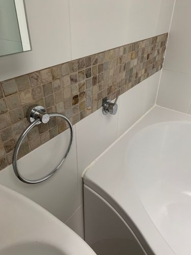

Hi, mates! My basin needs to change, new basin is a bit wider than older. So I need to remove the towel ring first. But how can I do? Thanks.

Hi Vica, I just installed one of these. There should be a small grub screw on the bottom of the base where it sits against the wall. You should be able to remove it with either a small screwdriver or Allen key. That allows you to remove the ring & base, leaving the mount where it attaches to the wall, which most likely will have a couple of screws for you to undo. Fairly easy 5 minute job.

Thank you !
