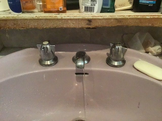

G,day spanner turners my bathroom taps have been over reamed and I can’t seem to explain to Bunnings staff the name of needed part,spindle and washers are all fine it’s the seat inside the tap that’s worn,have tried replacement sleeves these don’t work in this instance,please help kids are sick of brushing their teeth in the kitchen,cheers Krusty.

Thanks Mitchell they were the push in Kinetic sleeves,the original seat I think were reamed too far with the smallest tool as there are 2 sizes and now the seal becomes stuck in the recess but does not seal properly and there seems to be a break in the seat creating a channel for water to leak,I will try your suggested seal kit but can replace the bottom body if I have some direction with what to replace with,Great response,Krusty.

Hi @Krusty,
The copper piece that the spindle screws into is called a breech. It is likely to be similar to a Brassheads WELS 3 Star Forward Bowl Sink Set With 165mm Spout for a basin.
Cheers Mitchell I’ve been looking and asking for replacement taps this clears up the confusion for me and the Bunnings worker I will take measurements to be sure and head straight down for this purchase, thanks a lot Krusty.

G,day Mitchell,Taps from underneath are 200mm apart?maybe older set,Krusty.
