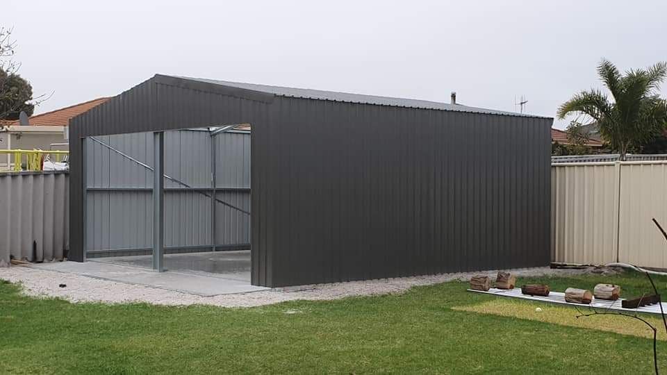

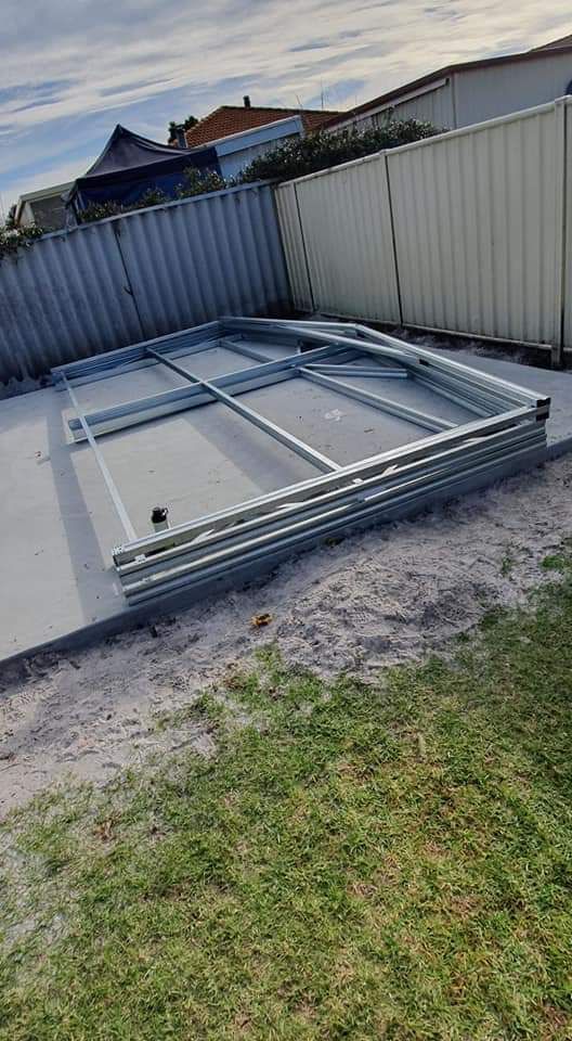

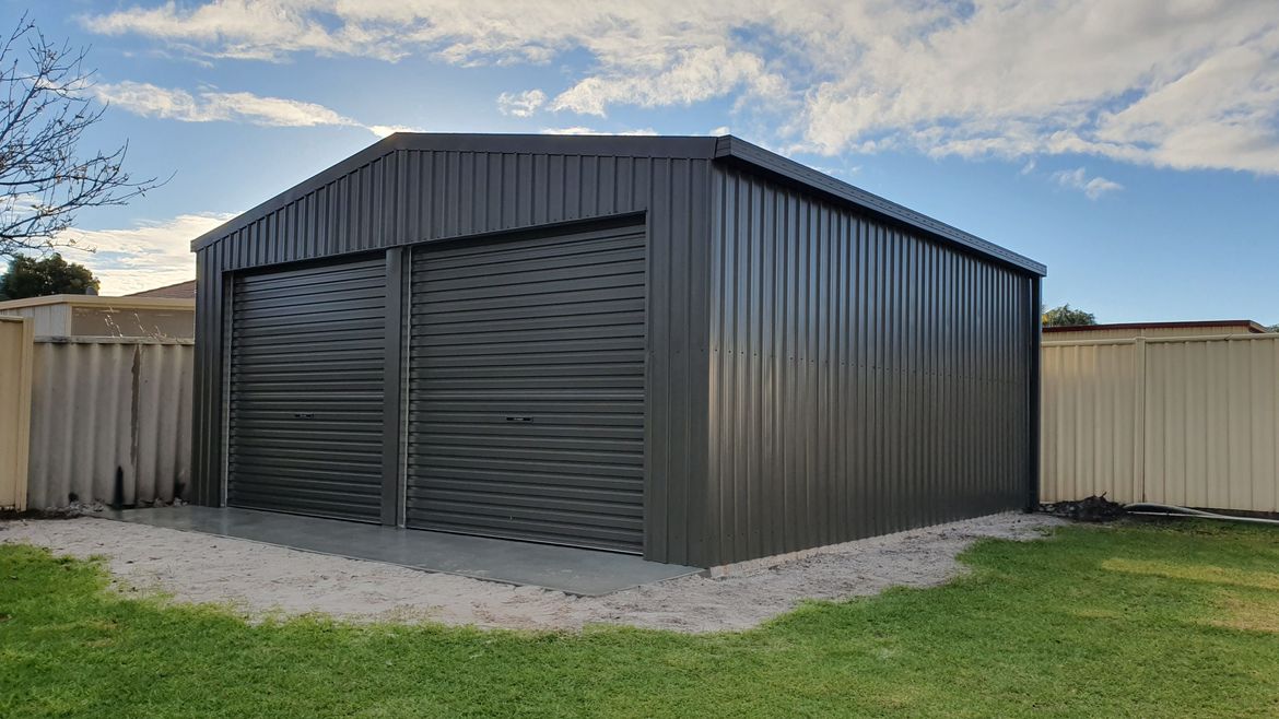

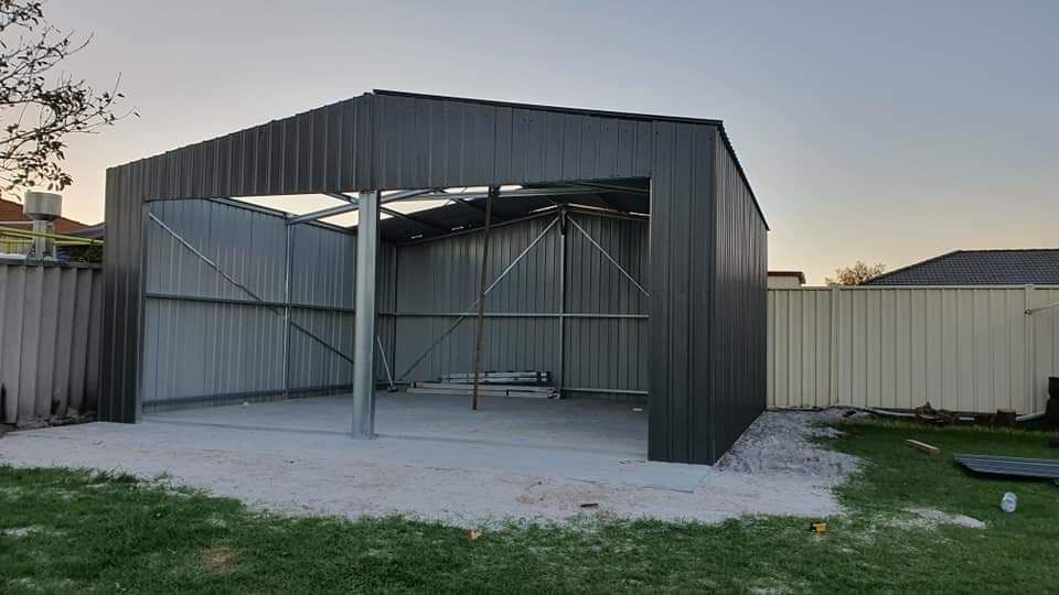

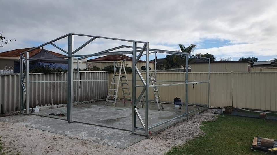

I havnt long finished building an Absco 6x6 garage from Bunnings.
It was one of the cheaper kits I found. Its probably not the best but I'd buy it again. For what it is it quite good. All the sheeting and flashing is all colourbond. The door are B&D plus it comes with all the paperwork foe the council with engineering and it's got an N2 rating. The whole build was pretty straight forward. I did most of it myself and just needed an extra set of hands to lift a few things.
Very happy with how it turned out.
