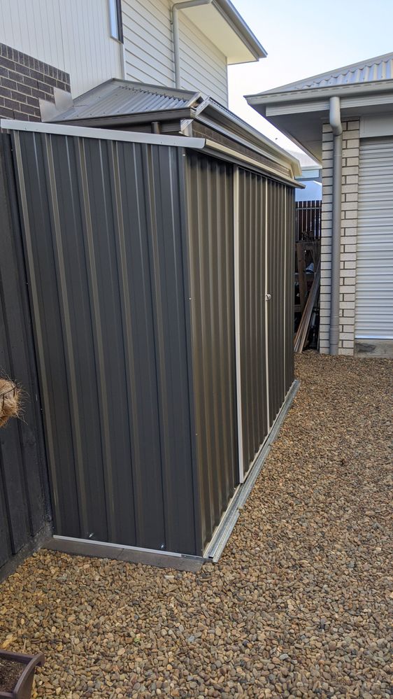

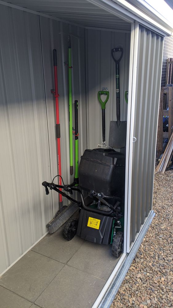

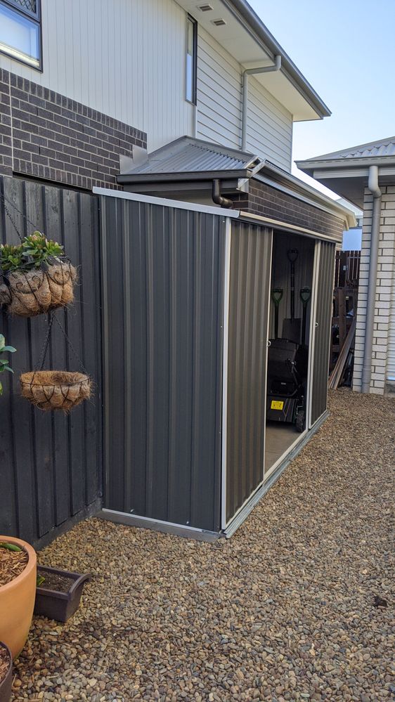

What a fantastic sized shed! It looks like there is ample room for all the garden tools and yet not encroaching significantly on yard space. Was this the shed you used Absco Sheds 3.0 x 0.78 x 1.95m Ezislider Double Sliding Door Garden Shed Woodland Grey, as I'm sure you'll have plenty of members asking?

Hi @MitchellMc , that's the one.👍

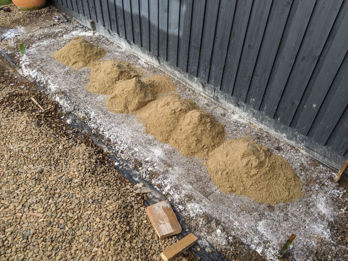

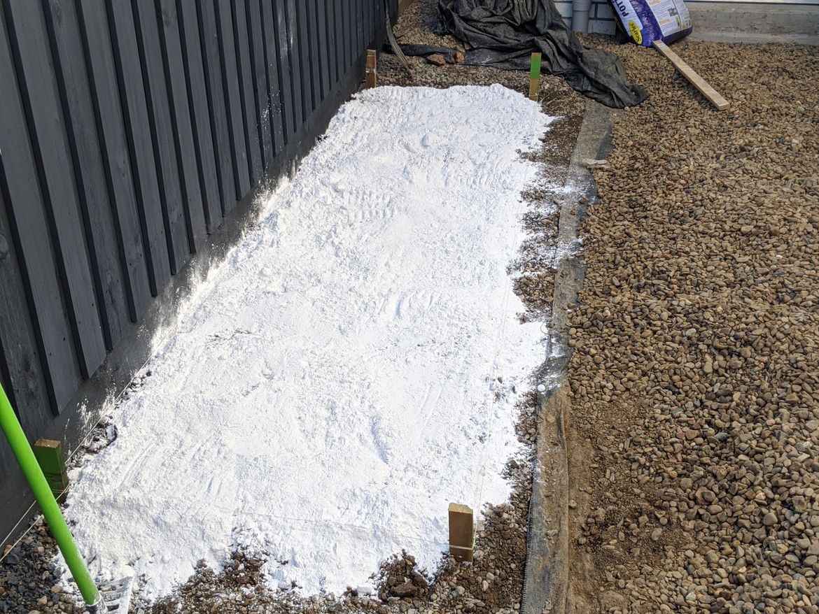

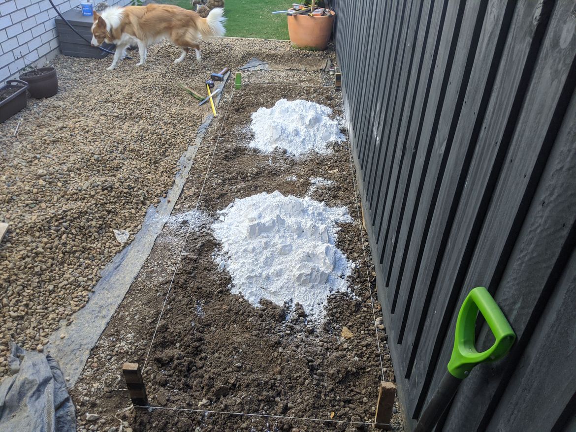

Hi BrendanB, what's the white stuff you spread after the crushed rock?

Re: Absco shed built on block pavers
Hi @pats6182
The white stuff is lime. The soil beneath the shed was clayey so I used lime to stabilise the clay and give it a bit of strength. Cement is another alternative, but it can break up if the soil is too clayey.
Thank you @BrendanB . I have the same issue clay soil. Didn’t excavate enough so this lime advice will help heaps

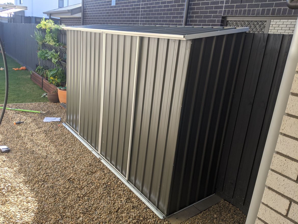

Are there issues building directly against the fence?
Hi @AdamDavies
No issues building it directly against the fence. The structure is actually quite light and so you and someone else could build it off the fence and then move it against the fence.
