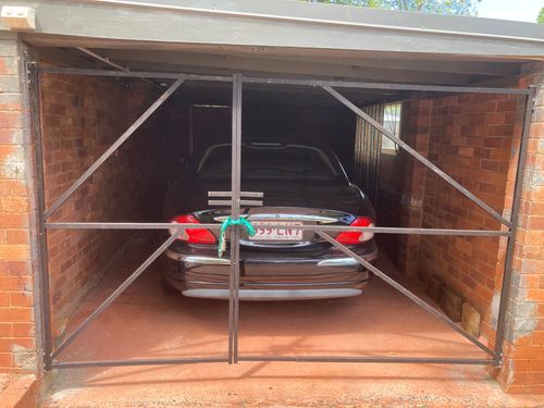

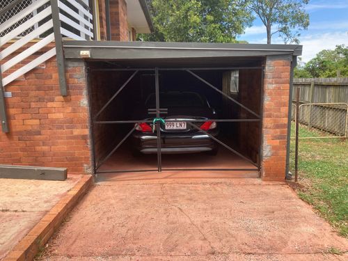

I have a brick garage attached to the side of the house.
I purchased two adjustable size gate frames from Bunnings and hung them.
I originally covered them with marine ply because I wanted to cover them with single sheets but after a couple of years it warped and was a mess.
So, I've removed the old cladding and now need to cover the frames with wood / synthetic slats or similar.
I'm a pensioner so need to do it as inexpensively as possible, consistent with a reasonable job.
I have the tools to sand rough timber and intend to undercoat and paint if necessary.
I have seen that 100 x 16 x 1800 treated pine palings (wet) are available but wonder how long I would have to wait for them to dry and if they would warp. Obviously I want something that remains straight.
The doors at present are 100 cm and 152 cm
The height from ground to roof beams is 184 cm so I thought that 1800 lengths would be o.k. with a 2 cm gap at bottom and top. I could alway put a draft or wood strip at the top if that gap is a nuisance.
I'd appreciate any advice as to what might be the best options.
Thank you in anticipation.

Thank you for your advice. I very much appreciate your help.
I wonder if you might just advise me on the width of the gap I should leave between the boards - 5mm ? 10mm or what would be best. Thank you.
Hello @nonsibicunctis
I generally suggest using the thickness of the panel (16mm for fence paling and 19mm for Merbau decking) as spacing, you can go smaller, but I don't recommend going lower than 10mm.
Eric, thank you very much for that information. I had thought it would be the smaller gap rather than the larger one so you have saved me from a significant mistake, I think. Thanks again - this is a great service and particularly for those such as myself who have no skills or training but are willing to or out of necessity have to, give it a go.
Take care. Thanks again.
Please keep us updated with your progress, we look forward to seeing your garage door frame covered up.
