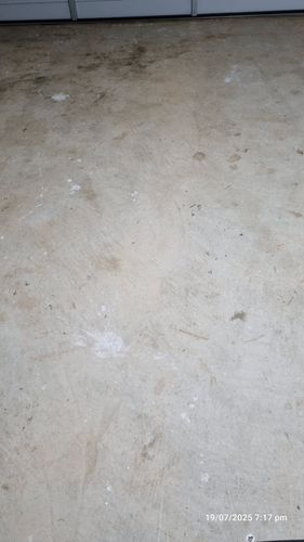

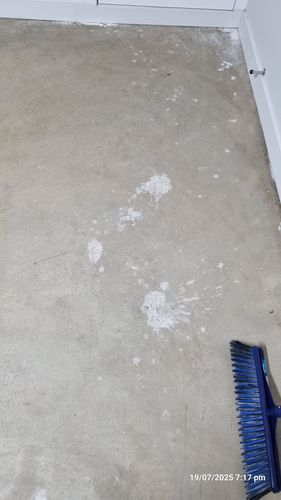

Thank you Eric, after cleaning my floor it still has some paint drop marks left(I tried diggers paint strupper from bunnings but no luck
). Is it okay to apply epoxy Slovent on concrete looks like in the image.
I attached couple of photos,
Re: Applying Epoxy solvent based for garage during Melbourne winter
Hi @jeevdevop,
If you have carried out the concrete etching, then you should be fine to go over the paint as it is likely deeper in the pores of the concrete.
If you have not yet carried out the concrete etching step, then I would suggest that this should be done. It should help to remove any surface-level paint and prepare the surface.
