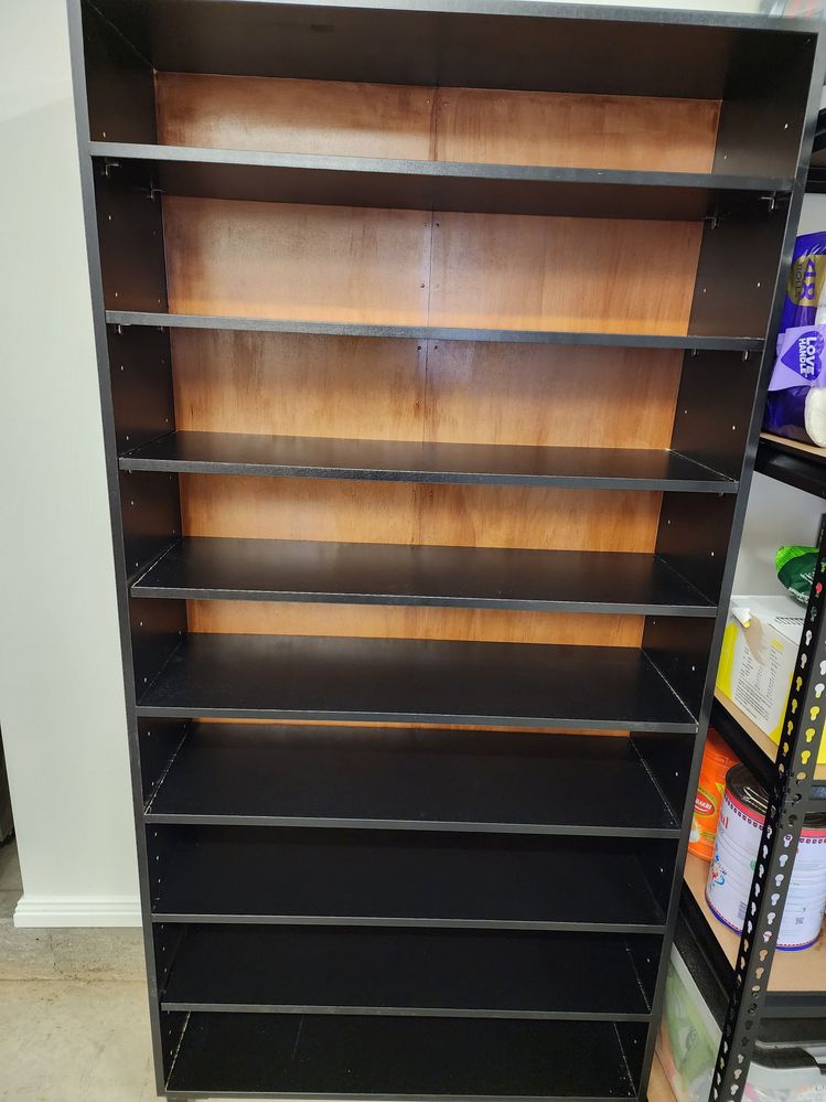

Built this custom yet simple shoe rack solution to add extra space for my wife to store her shoes. This was the best I could do with my limited knowledge and expierence. I'm glad my wife liked it and still uses it (although there was always this complaint that it is not closed so it will collect dirt !)

I should have used castor wheels, for easy movement of the rack (not that I have moved it since I put it in it's place).

- Measured the area and cut the board into four pieces to make a rectangle
- Cut the MDF panel to make the back cover for the case
- Painted the MDF panel with walnut stain and varnish
- Used glue and screwed them to make a rectangular case
- Attached the 4 legs
- Drilled holes to make adjustable height for shelves
