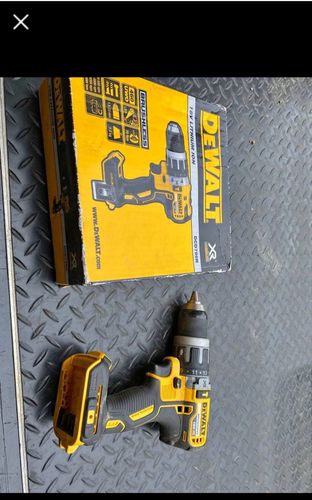

What battery for Dewalt XR17 DCD769N?
Hi i am planning to buy this DeWalt drill DCD796N XR 17 18V. Skin only. But I want to know what battery size can I use ? Is it ok to use a 6.0Ah or a 5.0Ah or  4.0Ah battery? And what charger model do I need to buy?
Re: what battery model and what will be the maximum amps i can use for Dewalt XR17 DCD769N
Hi @srik42,
That is still a current drill in the XR range, so will be compatible with the current batteries and chargers. If you were looking for a specific suggestion then the DeWALT 18V 5.0Ah Battery And Charger Starter Kit would be a good choice.
However, just remember that you can pick up a kit with that same battery and charger and the drill for $249 in the DeWALT 18V 5Ah XR Li-Ion Brushless Hammer Drill Driver Kit. That's only $50 more than the battery and charger kit, so the drill would have to be significantly less than that to warrant purchasing something second-hand.
Thank you so much Mitch! I was so confused between a 5 amps or 6 amps battery.
The 6 amp just runs for longer than the 5 amp @srik42. It's just a slightly larger battery that still has the same connection. You could also fit a 2.0Ah, 3.0Ah, 4.0Ah, 5.0Ah, 6.0Ah, 8.0Ah, 9.0Ah, 12Ah, or even 15Ah battery on your drill. Though, anything above 8.0Ah is getting a bit heavy for a drill. 5Ah is generally what most people run in a drill or even less if it's just for occasional use.
Thanks Mitch.
Nailbag
Home Improvement Guru
Hi @srik42
Like any cordless tool, you're not limited to the battery amperage. Simply the higher the Ahr the longer the tool will run with more power. But then it becomes a balancing act of physical size and weight and of course cost. I run 6Ahr batteries generally and save my 9's for my mitre saw, grinder and recip if I need more grunt and longer run times. 5-6Ahr will be ample for your Dewalt drill with a good balance of weight and run time. Use low gear for screw driving and high for drilling to increase run times.
