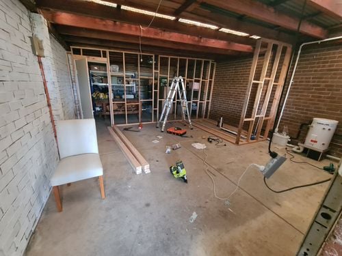

I've been thinking I'd like to change the flooring in my garage. It's currently concrete - old, grey and stained. The space I need covered is just under 30m2.
I'm tossing up between whether to just to an acid stain on it, or get floorboards & place those on top.
I'll be doing it with the help of my dad, but we both are new to this, so thought I'd come here to get some advice.

If this garage is going to be turned into something else and the vehicle will be parked outside, yes you can put Laminate Fooring in the garage. However, acid etching is technically a procedure that opens up the pores of the cement face to accept paint or epoxy. Specifically these types of products Dy-Mark 8L Slate Epoxy Coat Garage Floor Kit or White Knight Ultra Pave. These products are specifically designed to work in the garage.
But if you're referring to acid staining, I'm afraid it's not available at the store. But I've seen acid staining applied before and I recommend leaving the application to the professionals as it is an involved process. But between the two, I would suggest using Laminate flooring as it is a much better substrate to step on rather than cold hard concrete. Laminate flooring is an organic material and keeps its temperature nice and level. It does not go freezing cold and does not go boiling hot compared to solid concrete.
