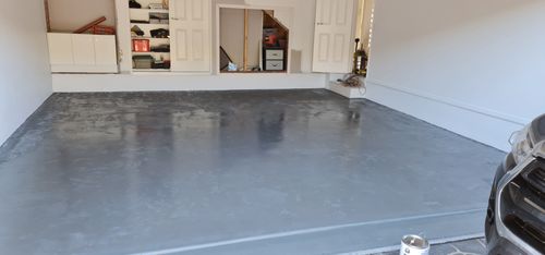

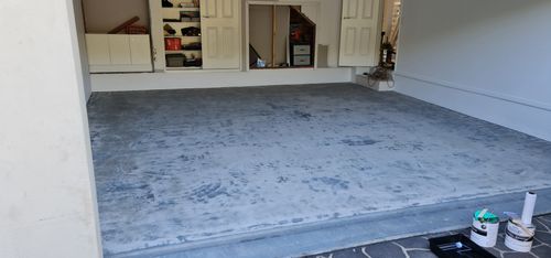

preparing the floor by grinding, quick vacuum, wash, then a wash with the Rocksolid etch
etch completed and dry reay for primer
Rocksolid Universal Bonding floor primer complete. Wait as per instructions to apply top coat.
Rocksolid top coat and vinyl fleck complete with one kit. Gave it a couple of days before walking on.
This job was completed 12 months ago. I can report unfortunately the hot tyres did lift the finish and it's slippery when wet. We are happy with how easy it is to keep clean.

Sorry to hear some areas are lifting with the hot tyres do you think it could be in areas where the old surface wasn't removed enough?
Some antislip thrown in the mix whilst mixing the paint would have helped with the slippery floor when wet but that's always the way of realising it after the fact.

That garage floor looks fantastic, I'm sorry to hear that you got some hot tire pick-up damage. I suggest placing some Matpro 2m Black Garage Floor Mat on the left and right of the garage during rainy days to help you with the slippery floor.
