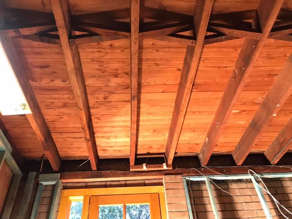

I wanted to keep the crossbeams and floorboards and showcase the colouring of the underside of the floor above. I also wanted to maximise the area as much as I could plus future proof it for refitting to other purposes (workshop etc)
With the sloping floor I decided to leave it as is instead of putting in floorboards to make it level. I would have lost a reasonable amount of height at the windowed end if I had done so.The slope didn't seem to be too bad.

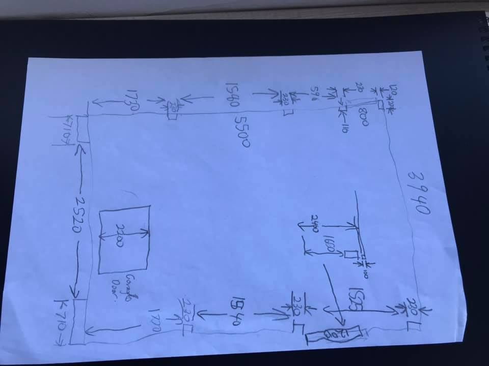

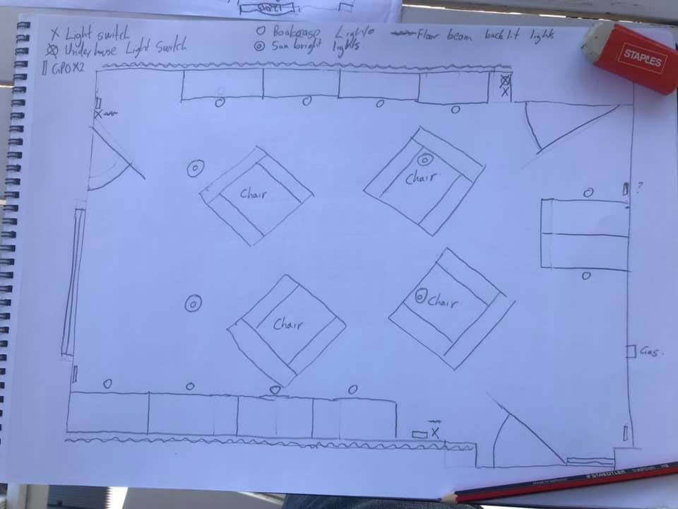

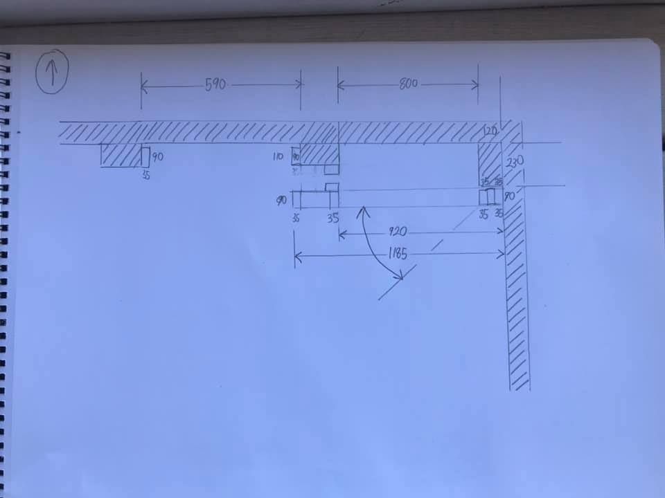

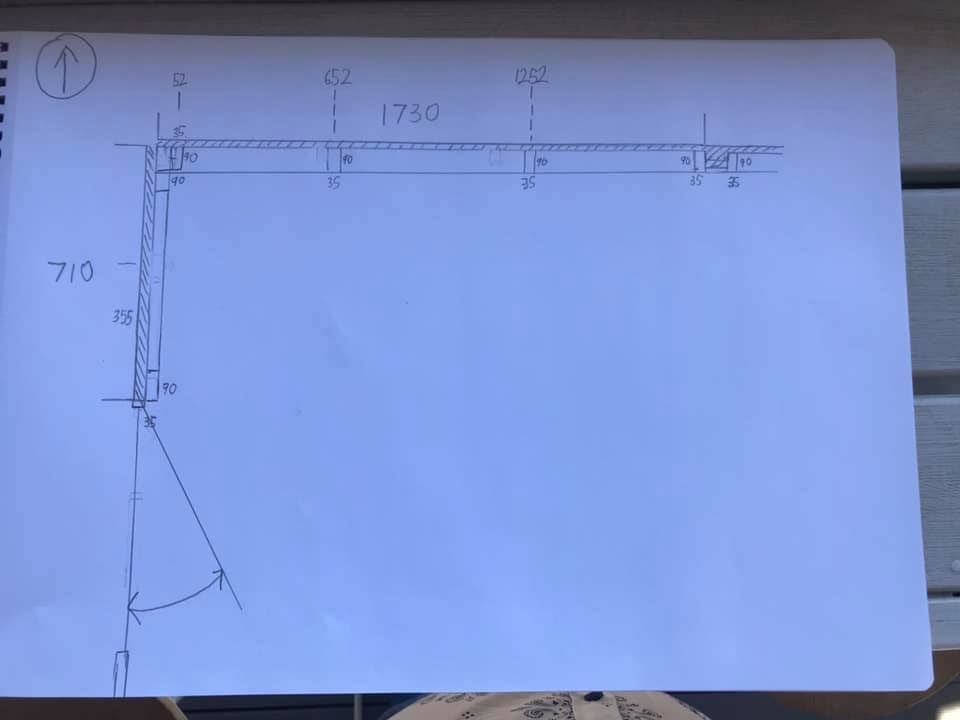

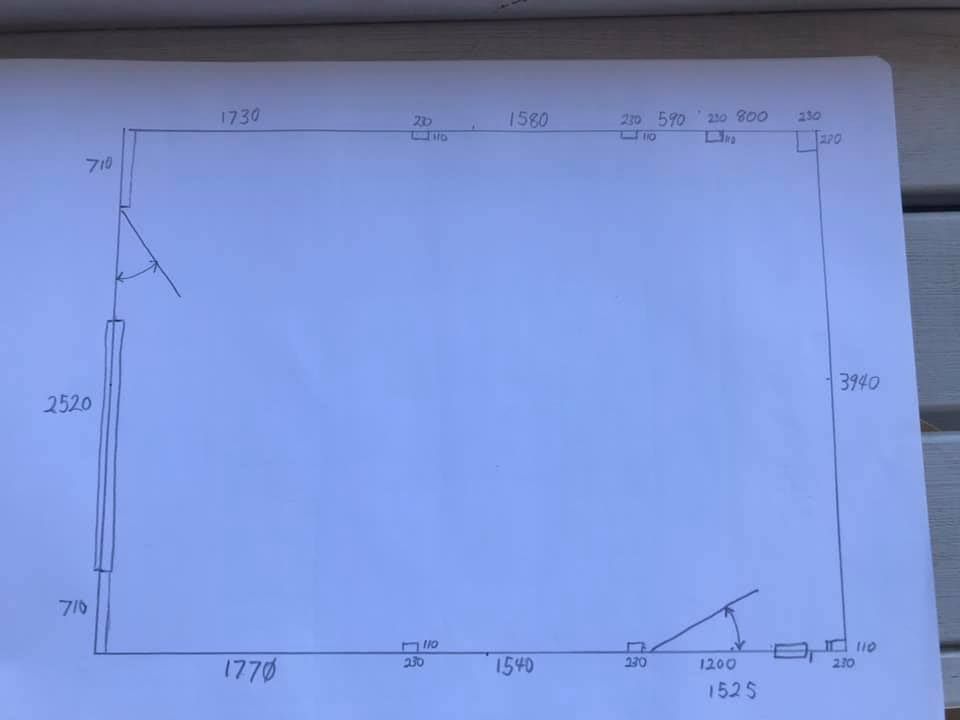

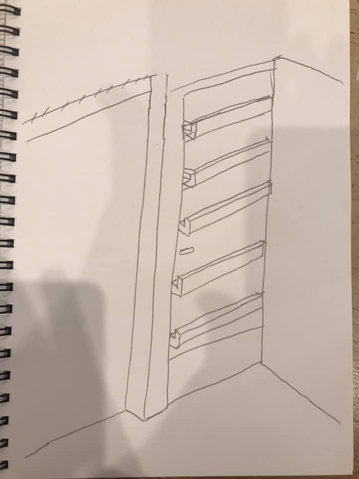

Sketching out my ideas helped prove the concept especially when it came to beams in the way and doorways that needed to be accommodated. Figuring out where I wanted powerpoints/light switches and overhead lights was another consideration. The Cornice was planned at this point as I wanted to have light to shine up into the overhead beams and structure.
First rough out of measurements

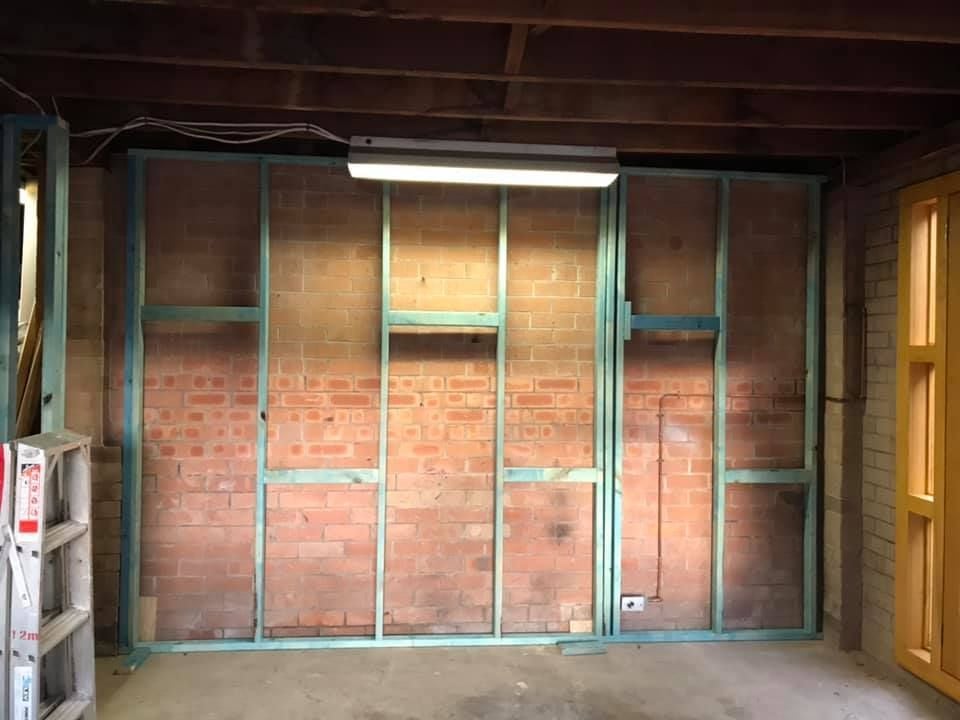

Working out where I would place the studs. I really wanted this informationin case i needed it in the future to run extra cables / services in.

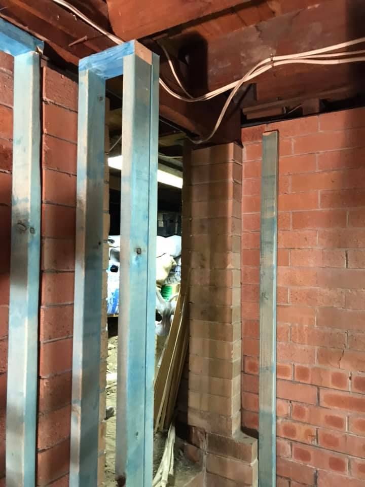

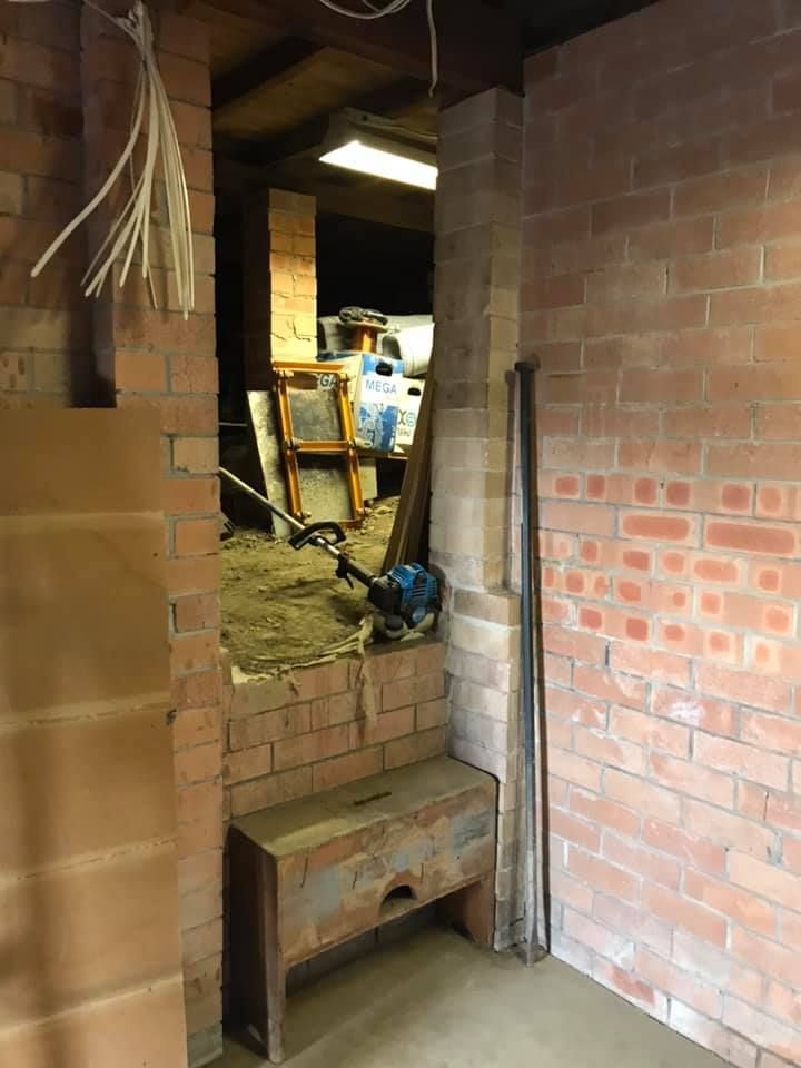

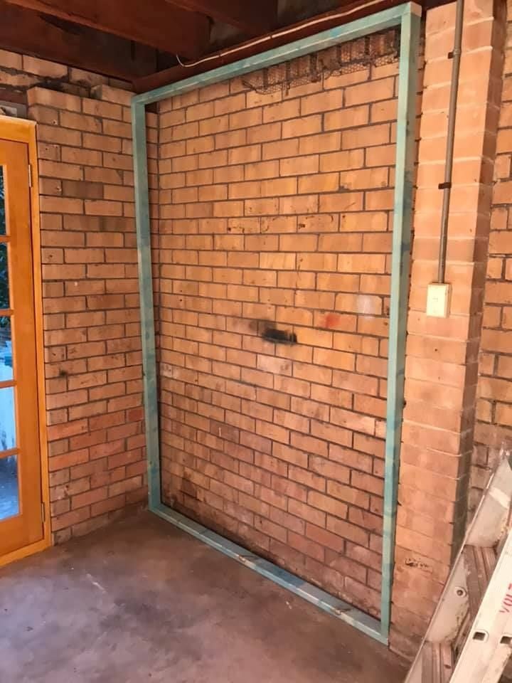

The door to under the house was a problem sorting out how to make it work and look like it fitted.

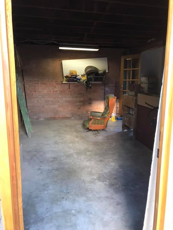

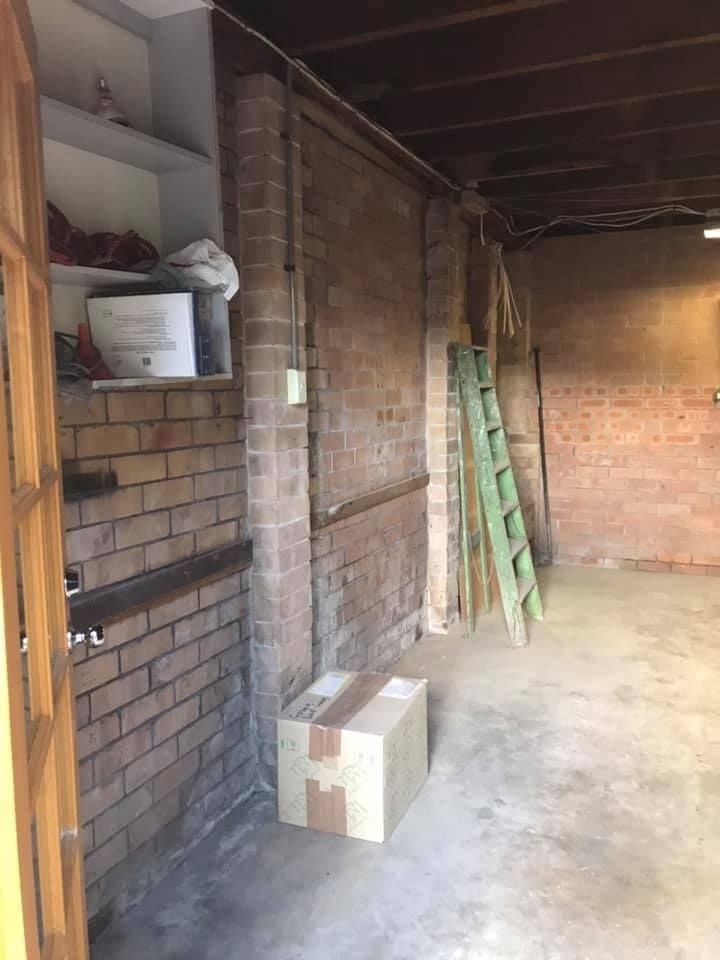

Before the room started

The doorway to under the house

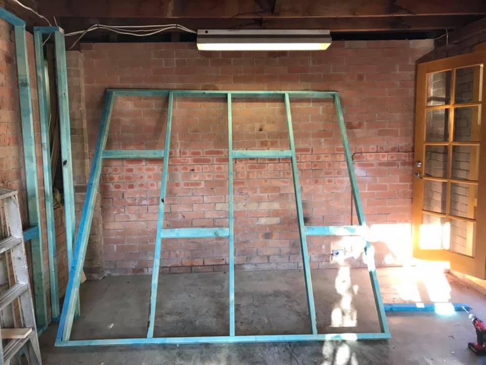

Putting the first frame in. Thankfully I only did the outside first then stood it up to see if I had managed to do it right. I hadnt. The floor of the garage slopes, about 30mm every 1m. So my frame was square... and I had measured the height from the closest point near the doorway.
After I had "adjusted it" it fitted a dream.

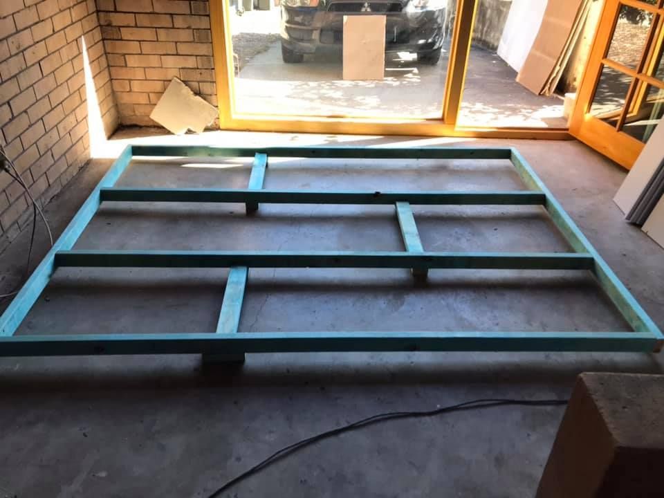

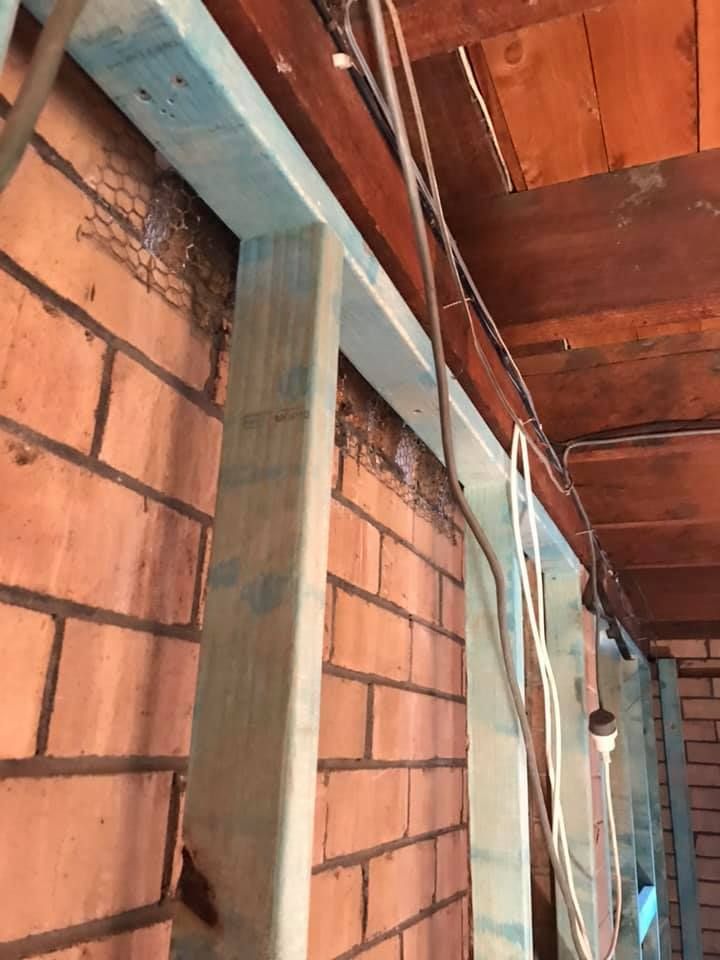

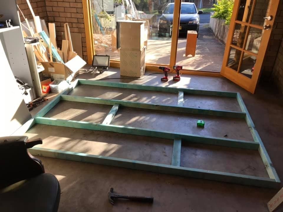

Making it up on the floor. Note the noggins are vertical oriented to allow for cables being run down the walls in future.

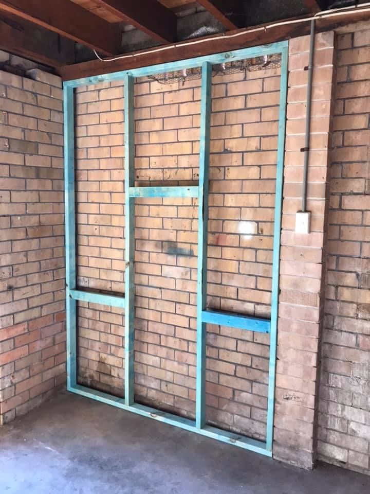

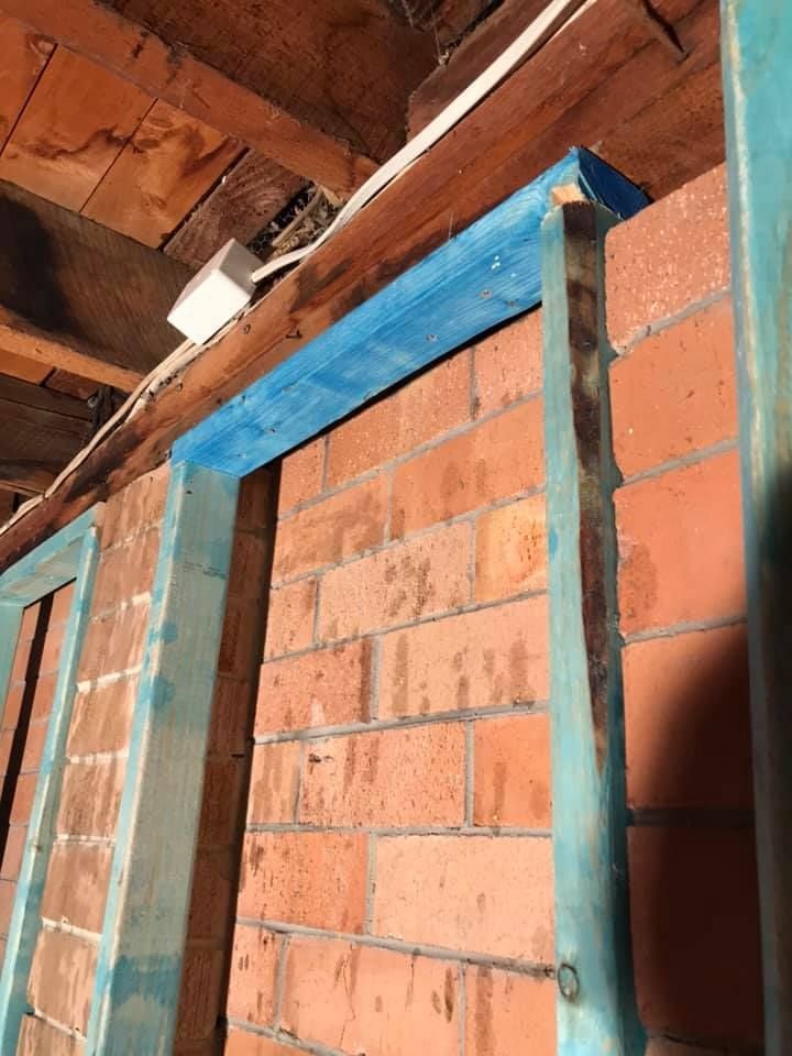

The second issue I ran into was the vertical brick columns were not true vertical. So I had to make allowances for them being out of true as I went around the room making frames up.

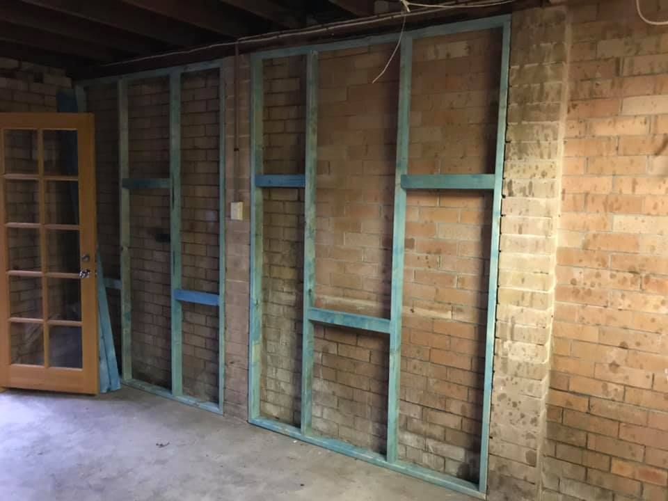

I could really see the shape of the room come through as I worked my way around the walls. One thing to note was drilling the anchor holes for fixing the framework to the floors. Make sure you clear out the hole of dust or better yet drill a little deeper to allow for dust in the hole. I snapped my socket wrench by trying to screw into the hole that wasnt empty. I knew it was deep enough and couldnt figure out what I was doing wrong. The hole was still a third full of dust!
Once I had done one frame the rest were easier.

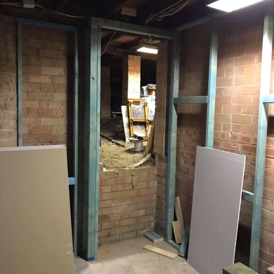

I was nervous about fitting out the timber studs to accomodate the doorway
Just slowly worked my way through it.

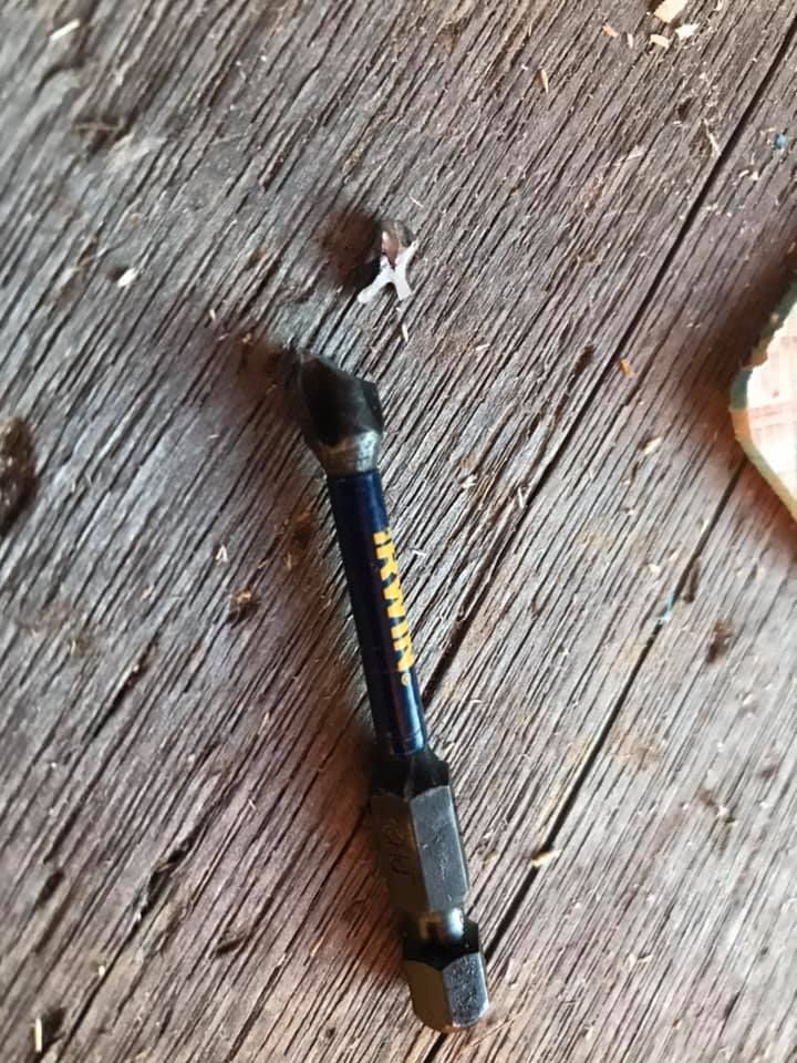

Surprisingly I snapped the head of the bit.
"Shrug" I am sure I was doing something wrong.

The back wall was longer and I hadnt really thought it through when I started one end.
I made it fit tho.

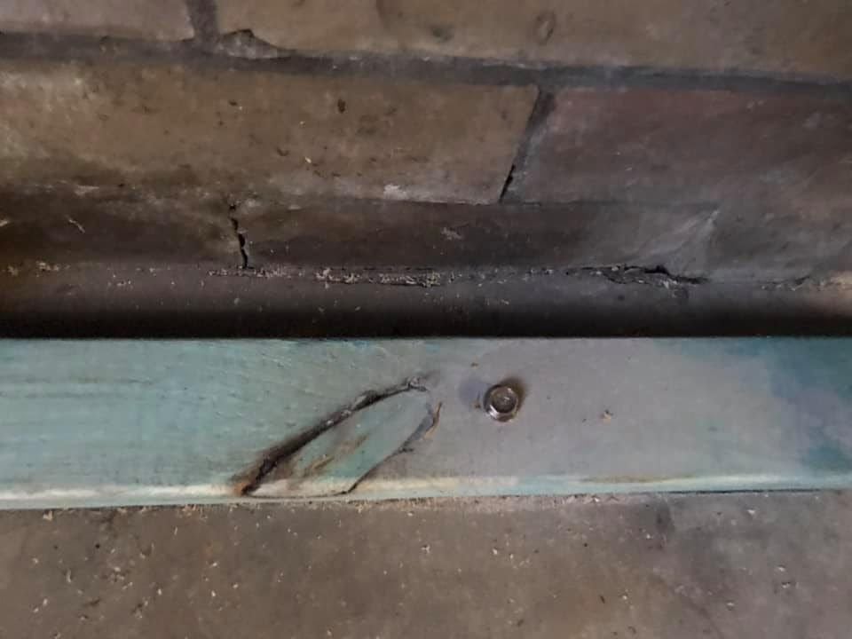

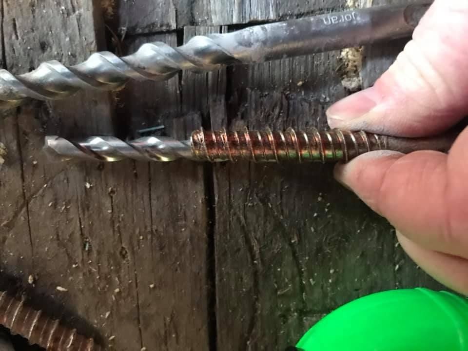

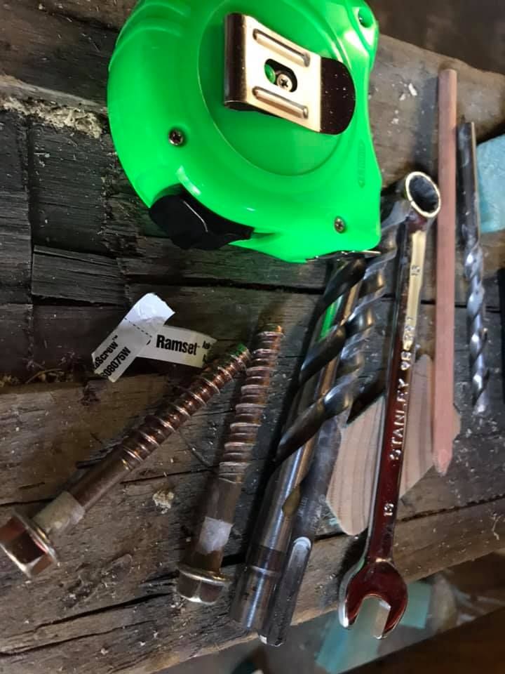

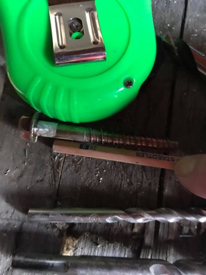

Ran into a problem, well a few problems really. Firstly I didnt have the right sized hammer drill bit. Secondly my Makita drill I have had for the past 30 years finally died with only a few holes left to drill. But most importantly make sure the holes are empty of dust when using the anchor bolts. Concrete dust doesn't compress too well.
The difference in height I found after I had drilled what I thought was the correct depth. The dust settles and the overall depth decreases.
It was a pain to figure out and yep I ended up at bunnings asking "Any ideas?" lol I am sure we all ask the embarrassing questions that make so much sense afterwards. The Bunnings person helped me out with some suggestions why and yeah their first suggestion was "Is the hole clear?"

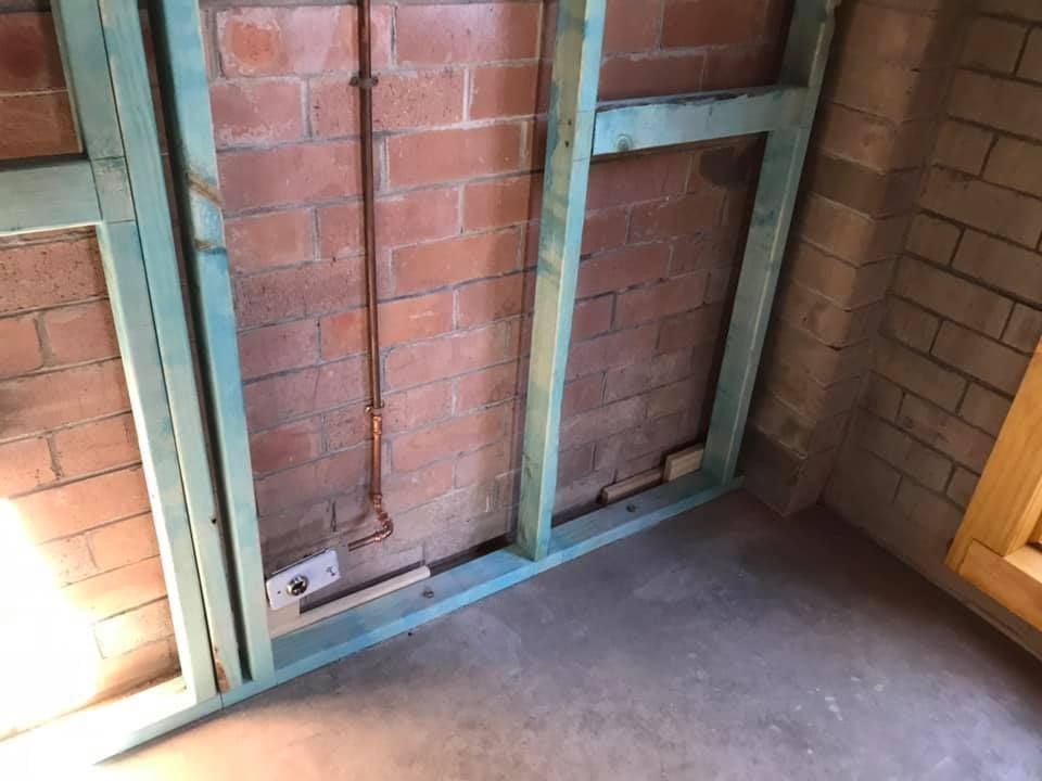

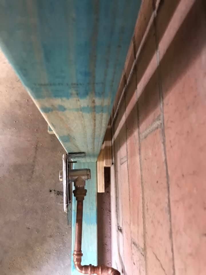

I put a gas point in as I thought it might be an idea. Make note you specify where you want the point as the first placement was 1m off the ground :surprised: (I do not know why the plumber put it there.
Finally getting down to the last segments. I did place the battens on their side (so there was a gap behind the timber to run cables etc)

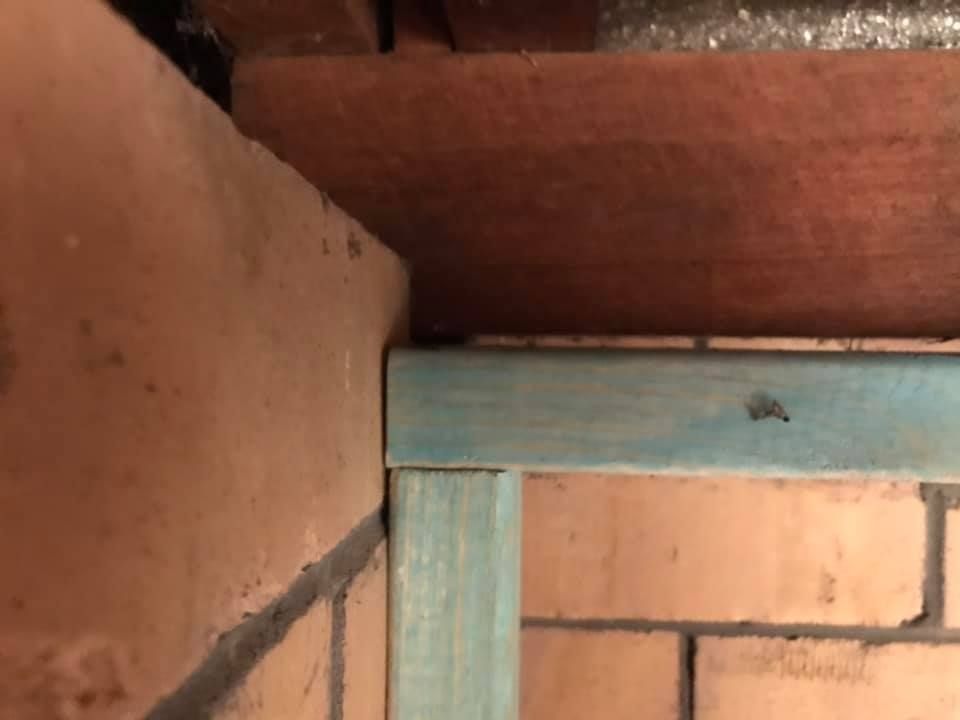

The timber supports for the floor above were different either side of the room. One side the timber was over the brick work and the other it was lined up with the brickwork.

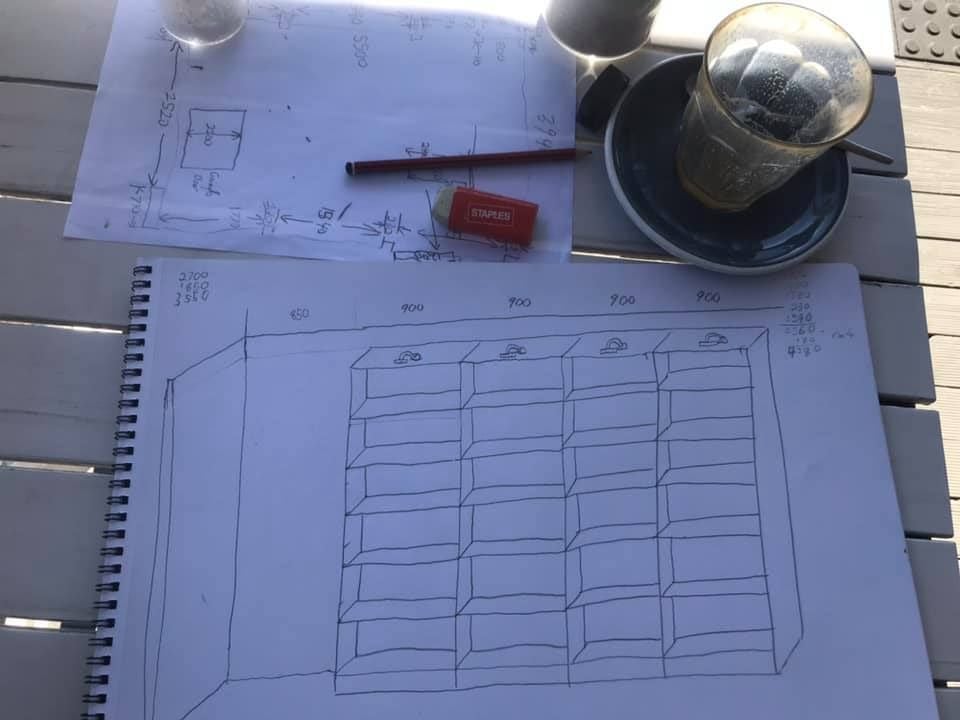

Nutting out the bookcase placement
Seeing what the room may look like and trying to maximise the bookcases.

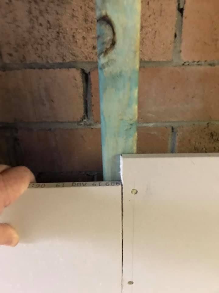

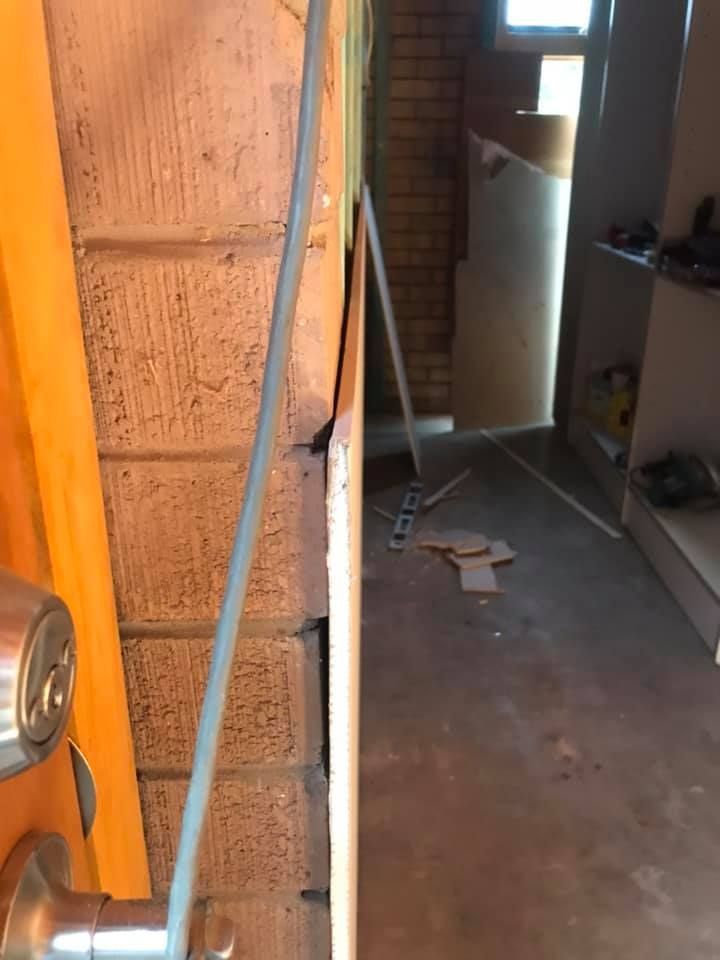

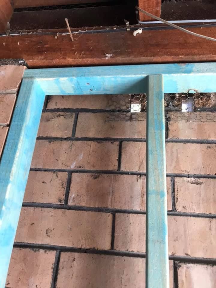

This was where I realised I had made a mistake in presumptions. If you look at the top timber beam on the brickwork it is overhanging. The other side of the room it is flush. When I put the plaster sheets up I ran into the issue of it not going over the beam as expected. I hid the overhang behind my cornice idea tho. (Next project)

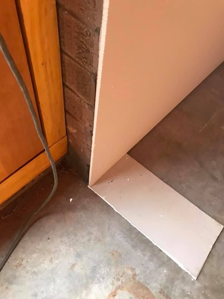

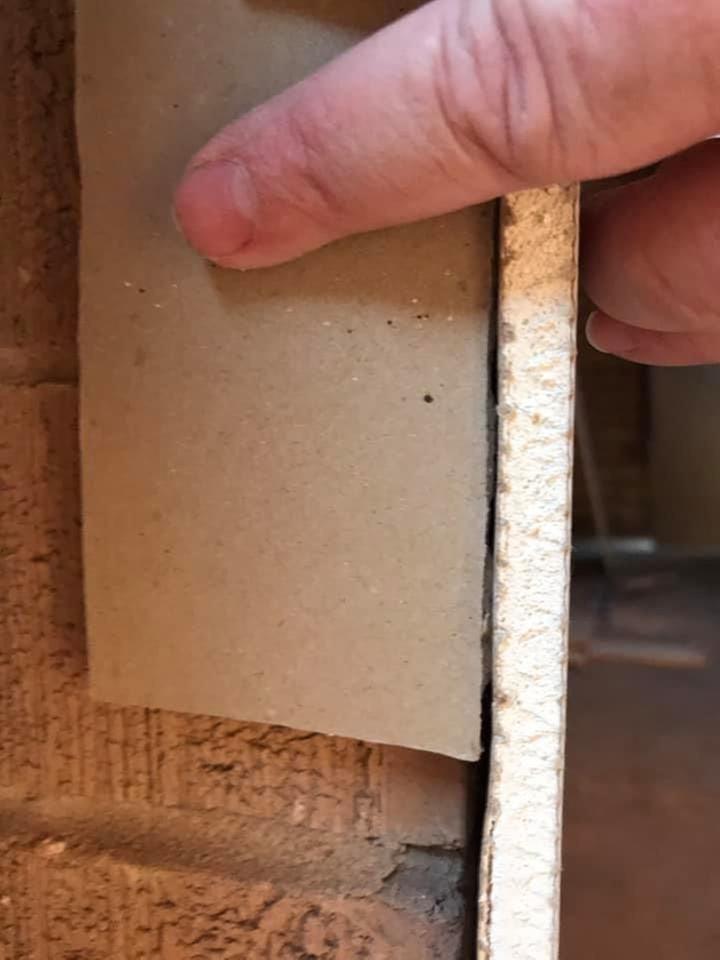

It was suggested not to run the plaster all the way to the floor. This was the way id been told to give that gap. It worked a dream.

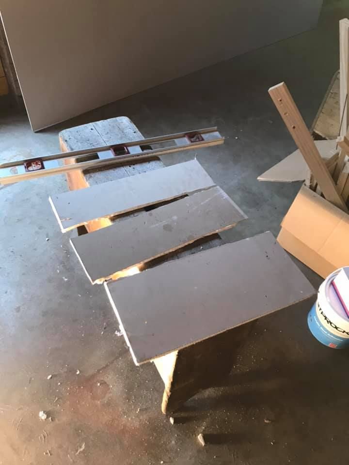

The far side of the sheet needed 4 pieces to make it level. so thats 40mm drop over 2.4m ish

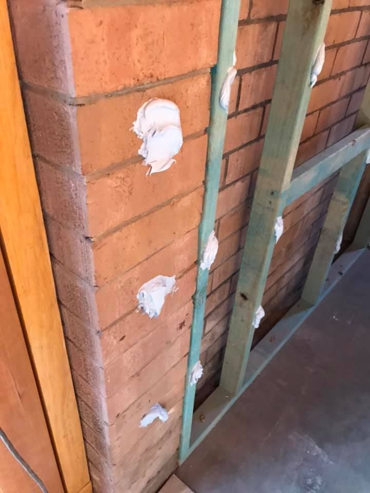

Putting goup on to stick the sheet of plaster to the studs before screwing them in. I also put it on the brickwork to do the same.
To show the tolerances and why I did the stud walls the way I did. I really wanted to grab every cm of space I could with straight walls.

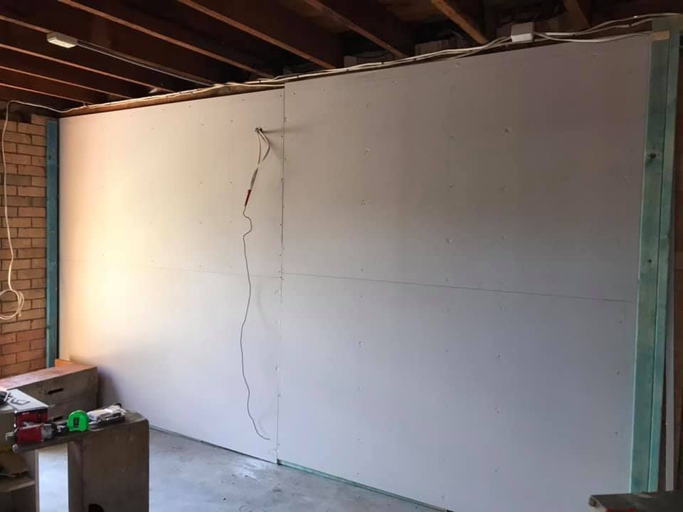

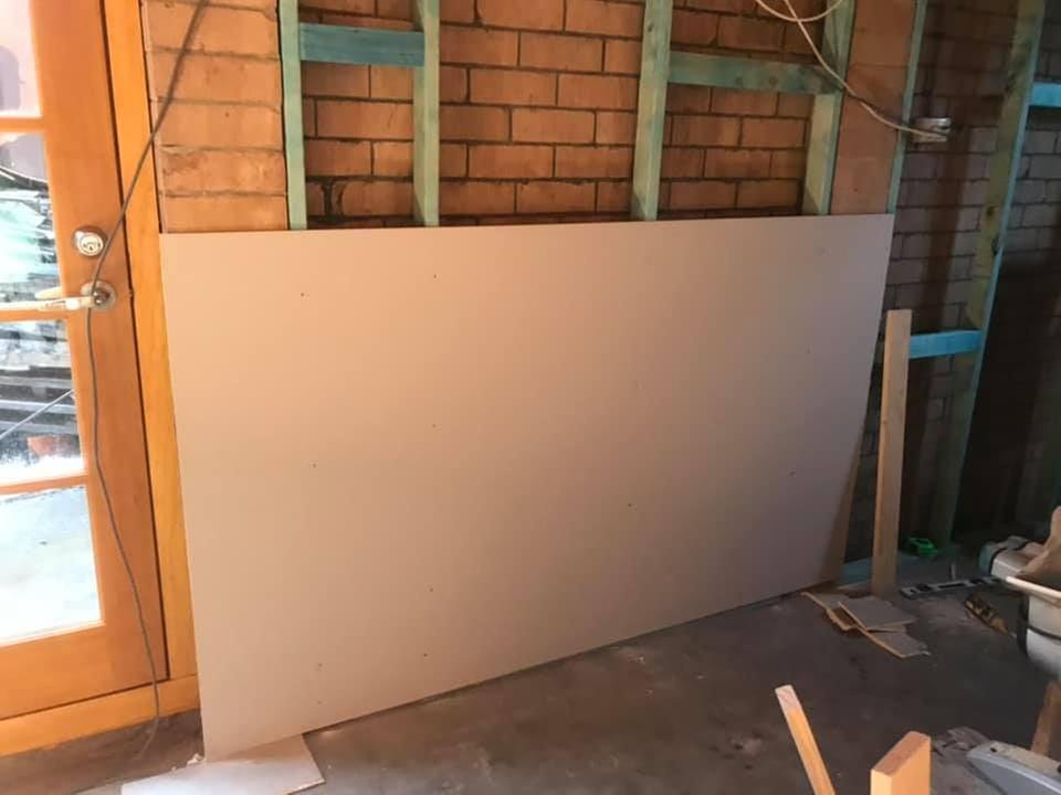

First piece in!

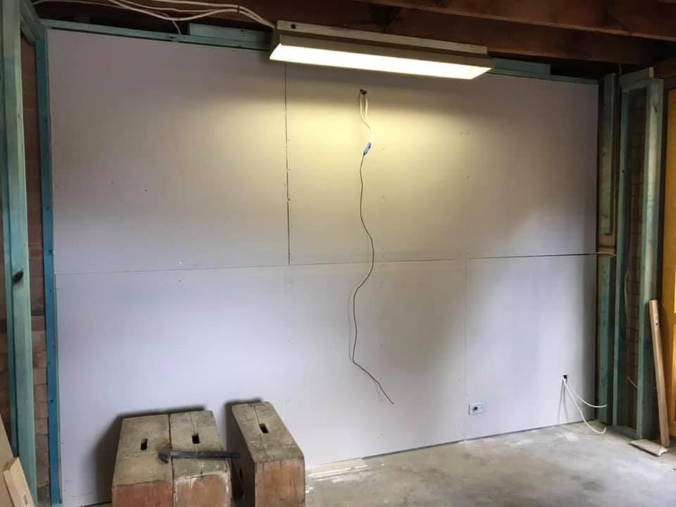

It went pretty much like I thought it would in my head.

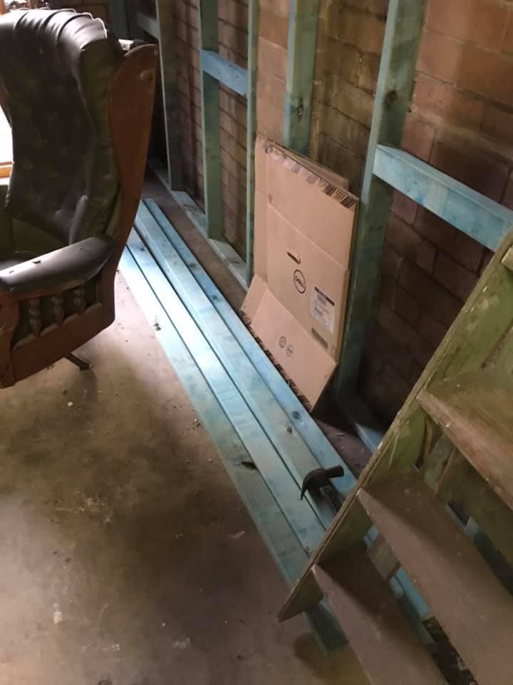

This is why the plaster should NOT be to the floor! I had a water leak and thankfully it didnt touch the plaster.
You can see how water soaks upwards.

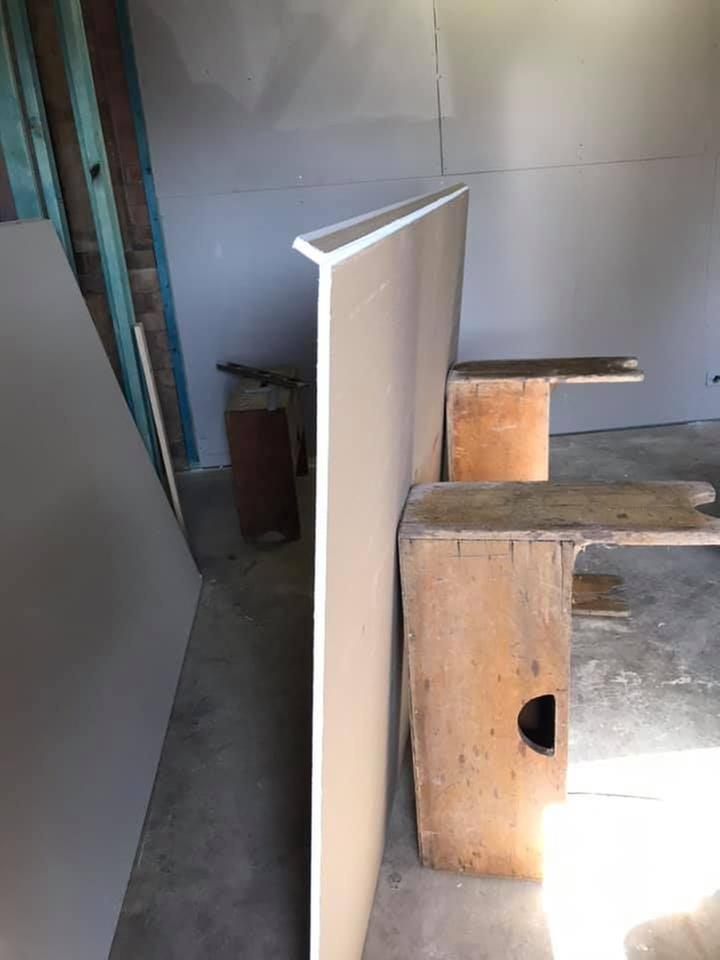

Prepping for the cut sheets to be fitted
Seriously easy to scour the back side of the sheet with a knife and then "snap" for a clean cut. I used a horse as a second person to hold it up but really didnt need to.

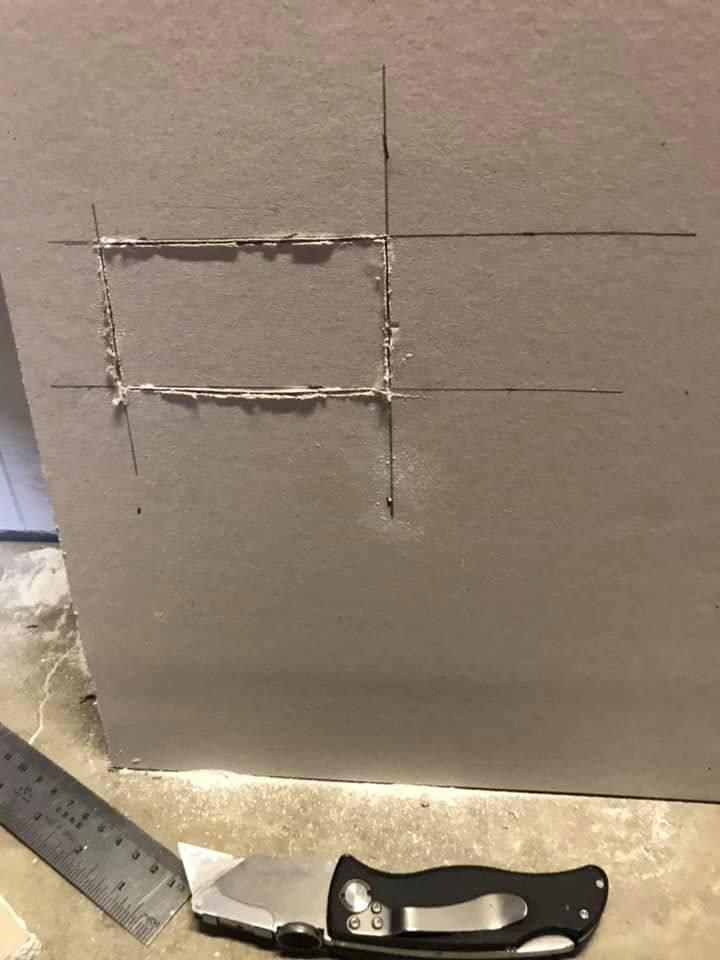

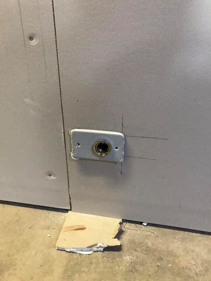

Had to work out where the pre installed gas outlet would be. It worked but would have been easier if I had the plaster join elsewhere and not so close to the point.
I was happy with how it worked out.

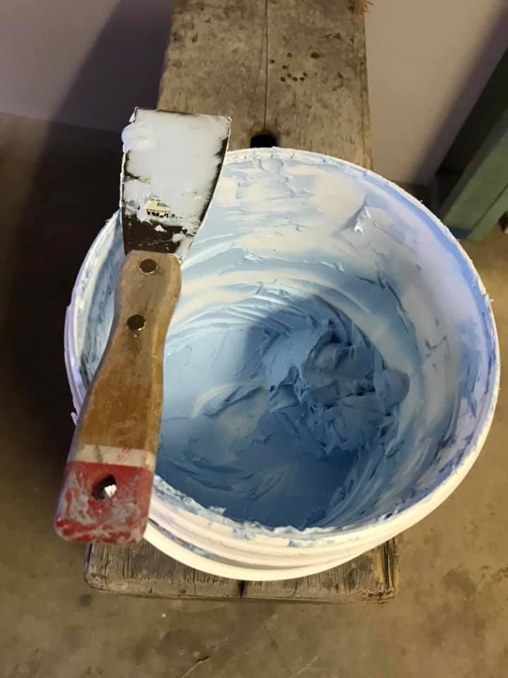

The glue "goup" compound. Cant believe I went through it all.

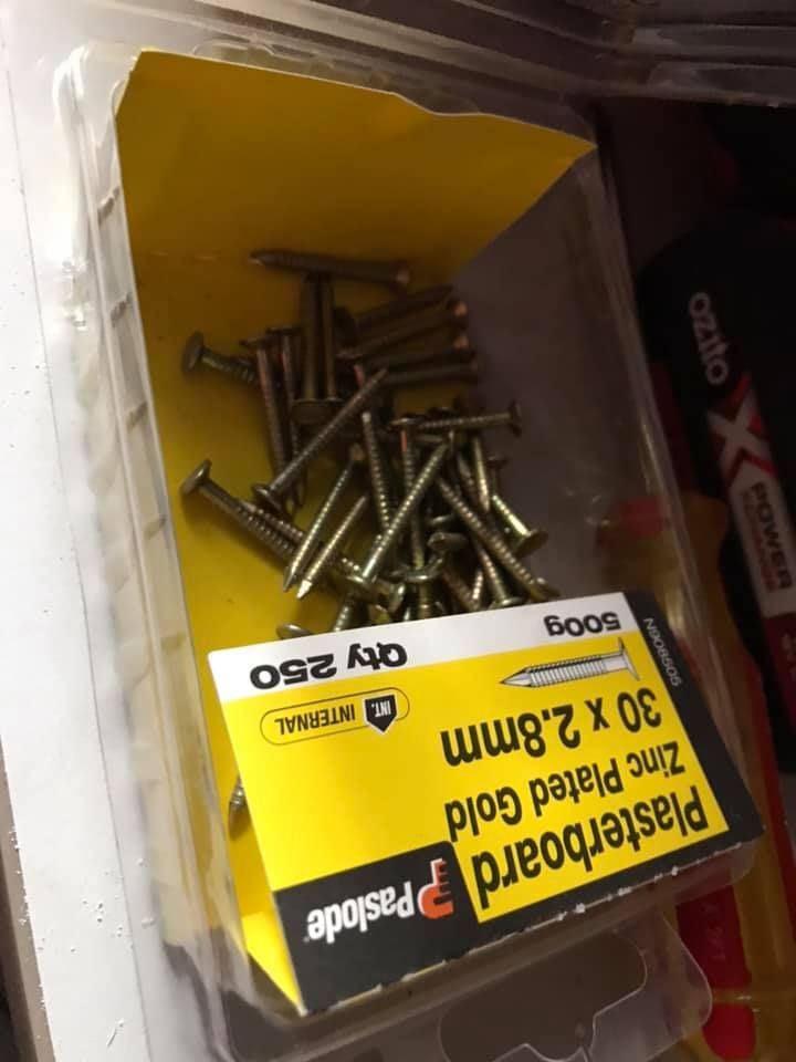

Just so I wouldnt forget what screws I used.

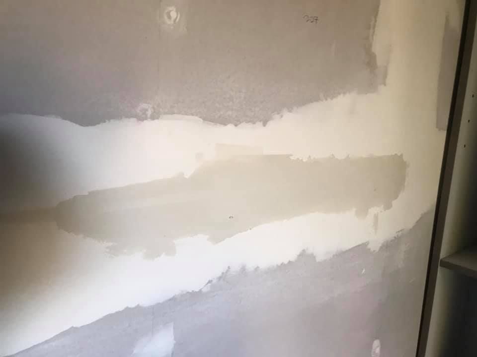

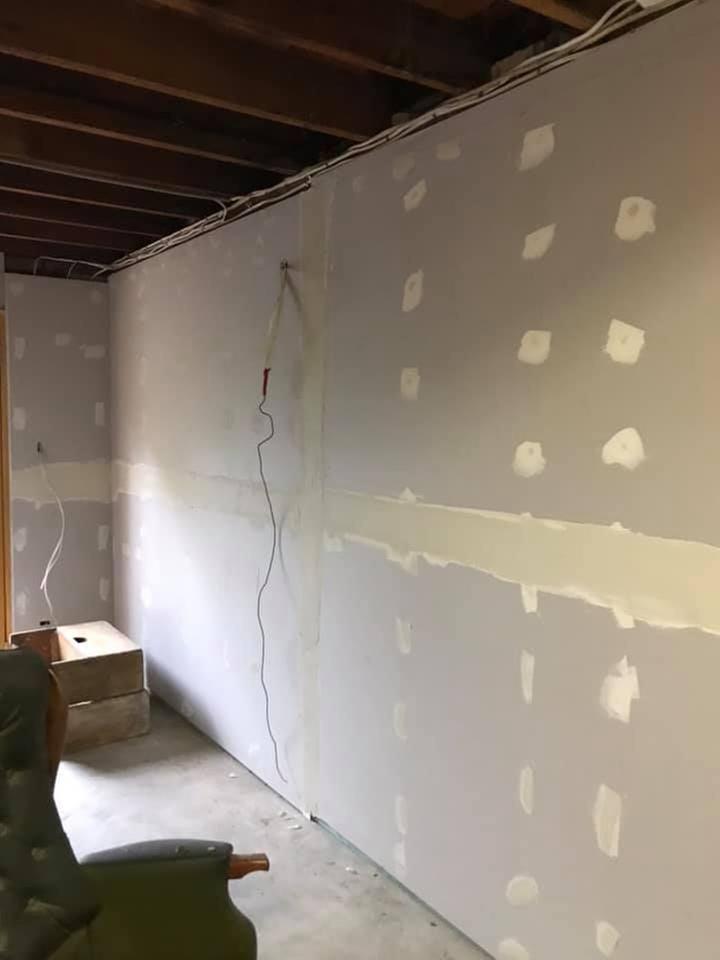

First run of the tape and plaster. make sure you put enough mud underneath the tap to be able to push into it.
Second coat making sure I had enough to cover it all nicely without being heaped.

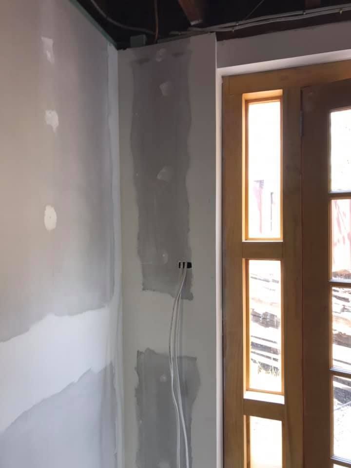

Slowly all being done and smoothed out.

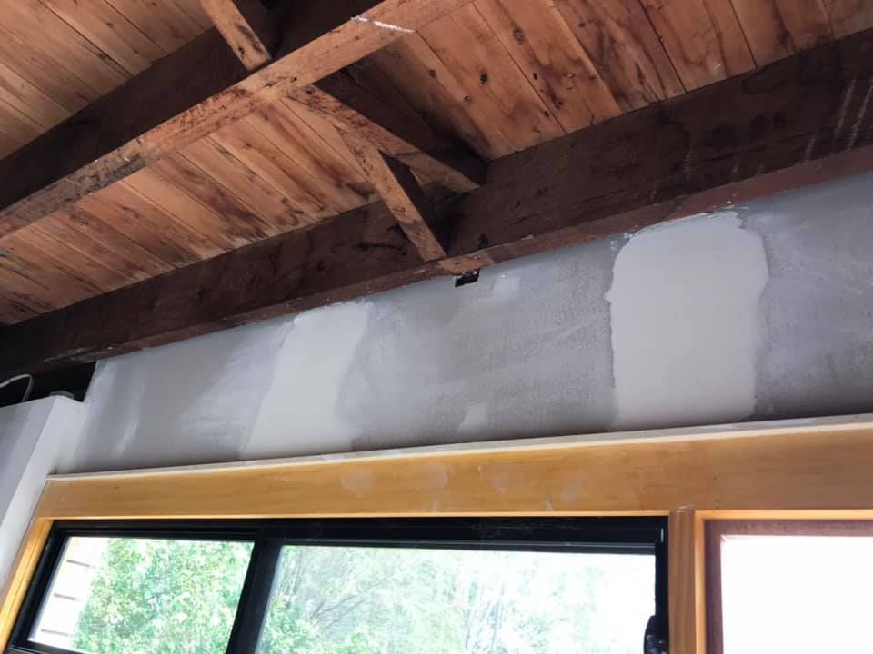

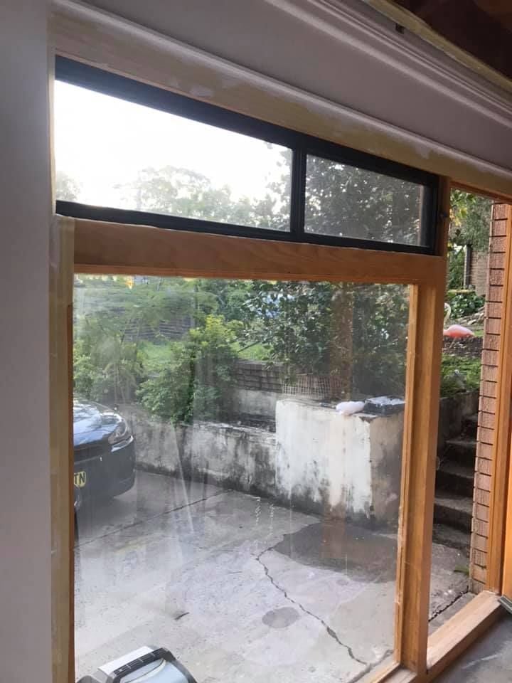

Above the door and main window. I should have trimmed the height down but left it high.

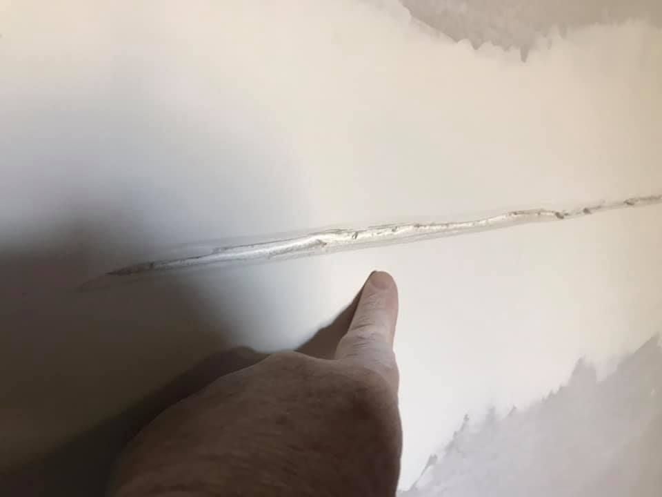

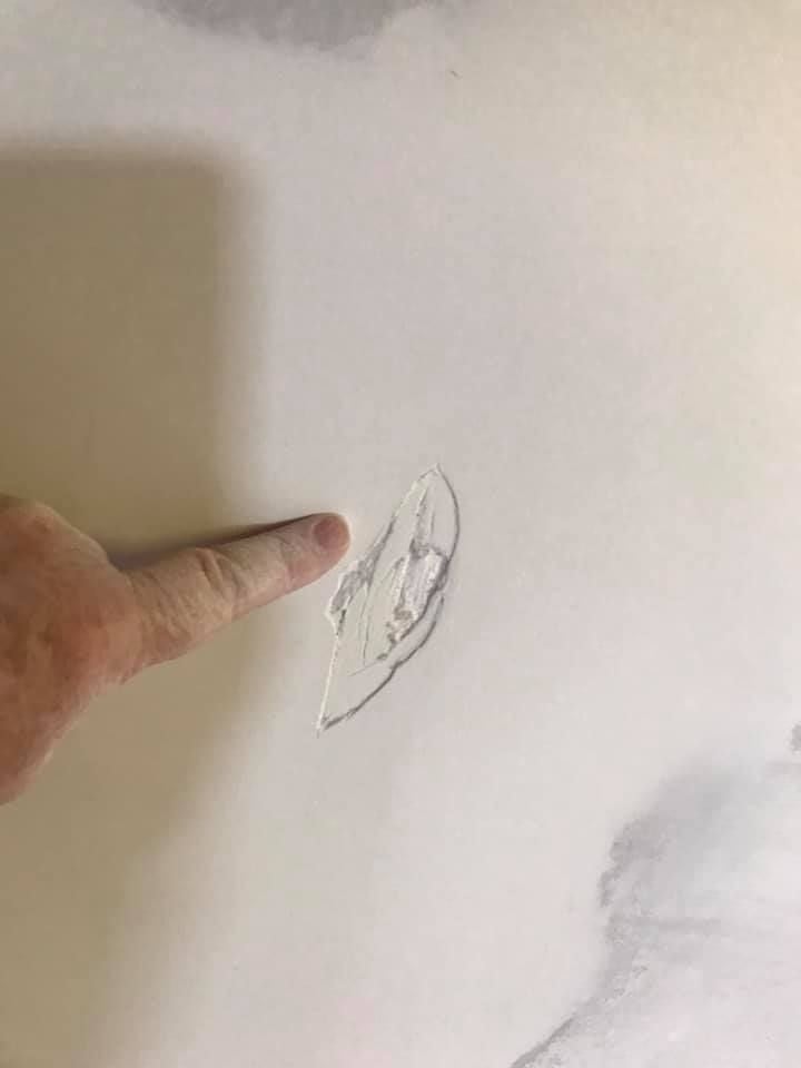

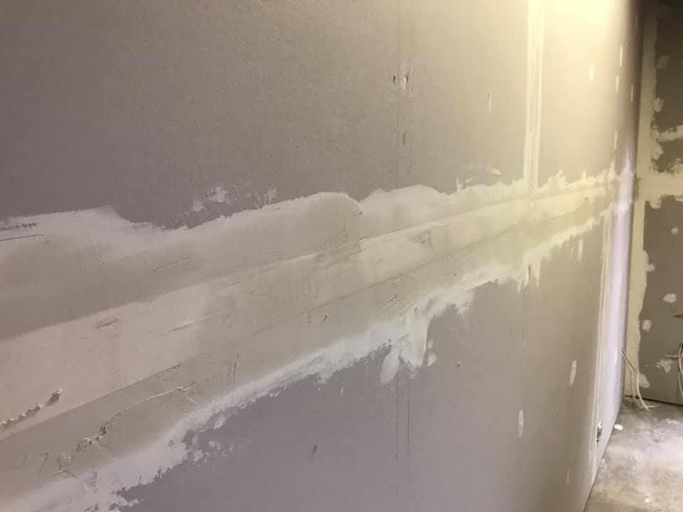

The issue of not using enough mud under the tape. It created a long bubble. I cut a V into it to fix it and relaid the tape.
Another "bubble"
After fixing it. The way I was told to and It actually worked :smile:

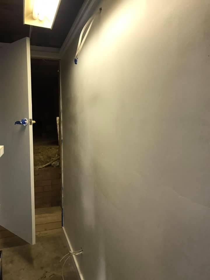

The painting was done after I had made up the cornice style I wanted and had installed the skirting boards. I will show this in "Garage lining for stud walls stage 2"

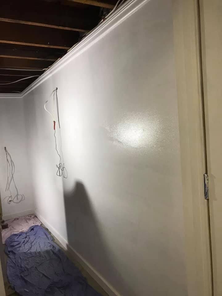

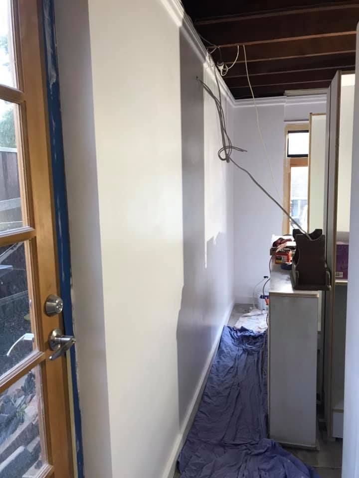

It was nice to get to the painting stage. The power still needs to be connected and lighting installed.
It was so nice not seeing any bumps in the paintwork after all that sanding.
It shone so bright during the daylight!
I was very happy with how it all came up. I couldnt take a photo of the whole room in one go as the bookcases were already sitting in the room. Looking back I'd say it was worth it for all the headaches I had during the retrofitting.

How did you get the concrete dust out of the holes? Vacuum or something else? I may be having to drill studs for a cupboard into a concrete floor and don’t want to have to spend much money on extra equipment.
Re: Garage lining for stud walls stage 1
Hi @MackaQLD
The standard method would be to use a vacuum and something like this Ramset 13mm x 280mm Hole Cleaning Brush. The brush will agitate the concrete dust so the vacuum can suck it up.
Allow me to tag @Dave-1 so he is notified of your question. He may have used a different method.
Dave-1
Community Megastar
Good Morning @MackaQLD
Thank you :smile: I was pretty happy with being able to do it myself. I "knew" what I should do but had never tried false walls before.
To answer the question, I blew a puff of wind down the holes with my eyes closed lol but yeah not the wisest as dust tends to go everywhere.
I made sure I over drilled the depth of the hole, by at least 25mm, run the drill up and down a few times until you see no dust come out.
Then sweep the dust clear with your thumb over the hole. Last bit, check with a cable tie to see if the depth is ok by sticking the cable tie down the hole, clamping it between your fingers and then hold it against the masonary screw so you can see how far you have gone.
