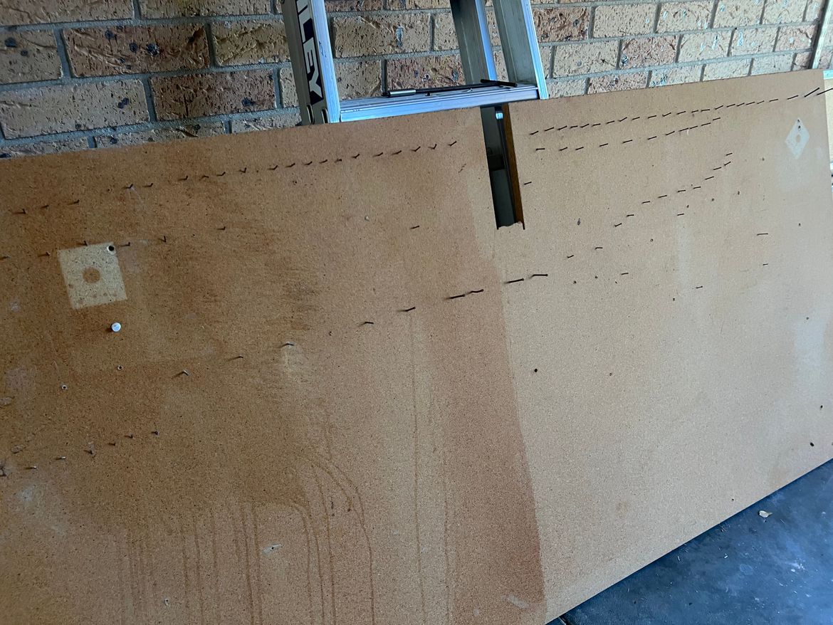

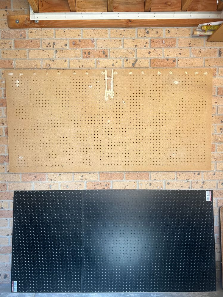

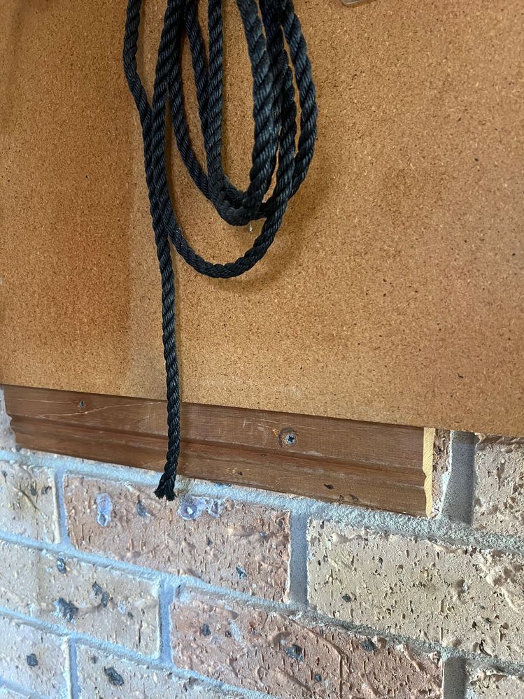

I started off by taking down all the tools of the board. Who knew we had 13 different tape measure measures? As it turned out, the board was hanging on by a literal thread - a scrap piece of molding and one screw in this middle. Once the very heavy board was down I patched up the holes and used scrap wood in the missing slot.
Needs a glow upNeeds a glow up
I don't know how it was hanging on by this tiny scrap piece of woodI don't know how it was hanging on by this tiny scrap piece of wood
Time to remove the nails before someone needs a tetnus shot!Time to remove the nails before someone needs a tetnus shot!

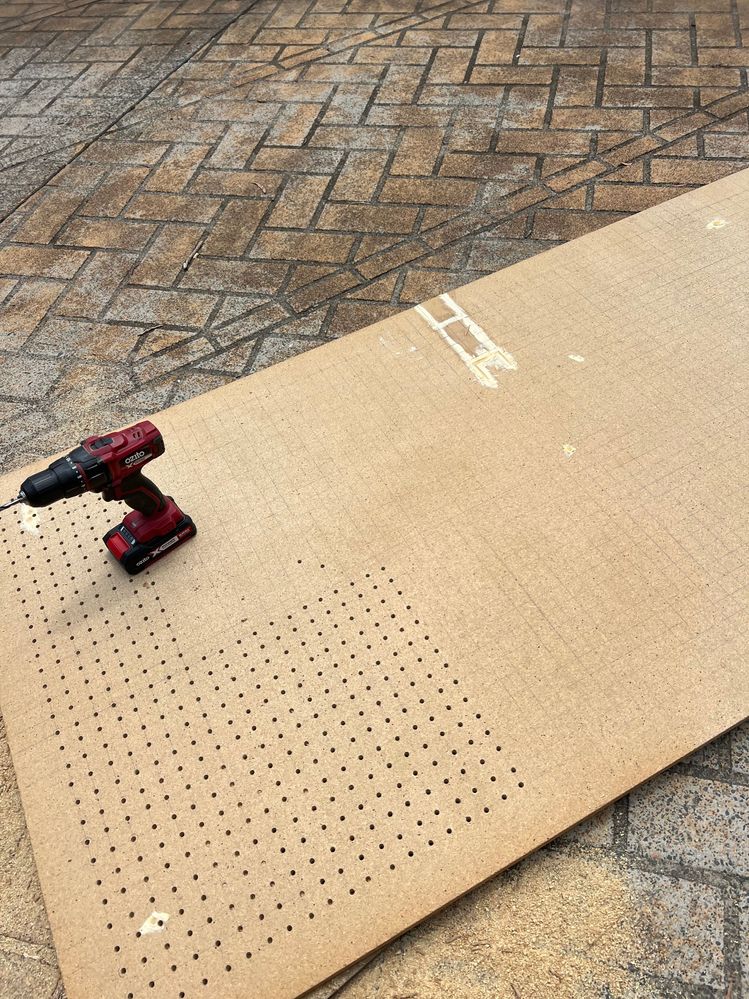

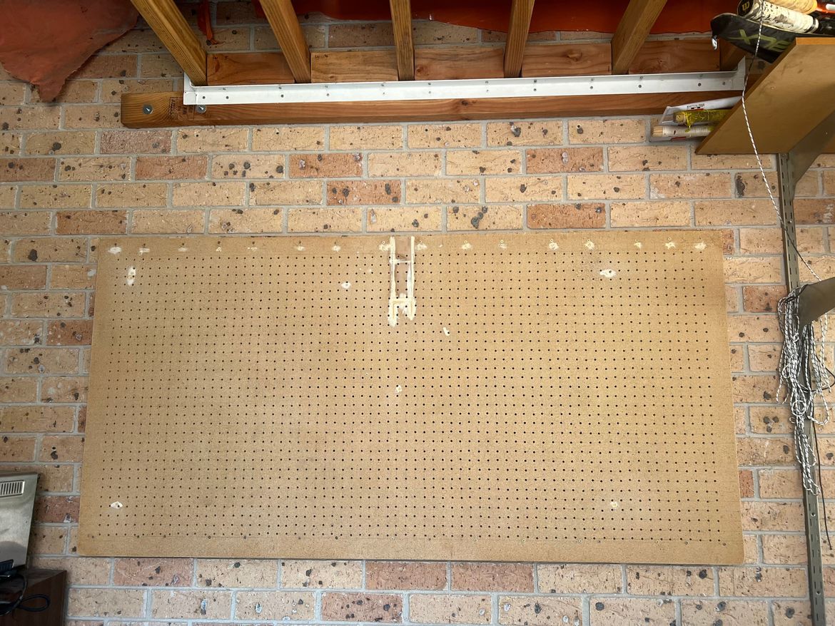

I spent the next few hours marking out every single hole - which ended up being over 3000. I spaced them out so they'd be 1-inch apart.
Patched up the holes and drew out where I'd need to screwPatched up the holes and drew out where I'd need to screw
Step 3
Endless Days of Drilling

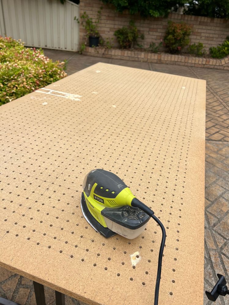

Then it was time to drill and very quickly I realsed it really wasn't worth it and I should've just gone and bought a new board. My hand was cramping and blistered and it took about 3 days to complete. I probably should've stopped early on, but my ego wouldn't let me and now I think I have early onset of carpal tunnel!
Not to be dramatic, but immediate regret. This was after day oneNot to be dramatic, but immediate regret. This was after day one
Can't believe I drilled over 3000 holesCan't believe I drilled over 3000 holes
Time to sand it all downTime to sand it all down

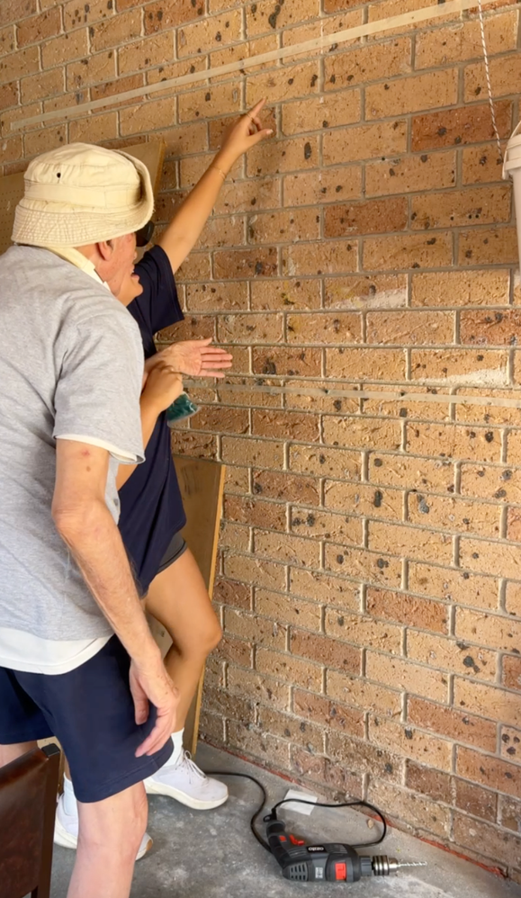

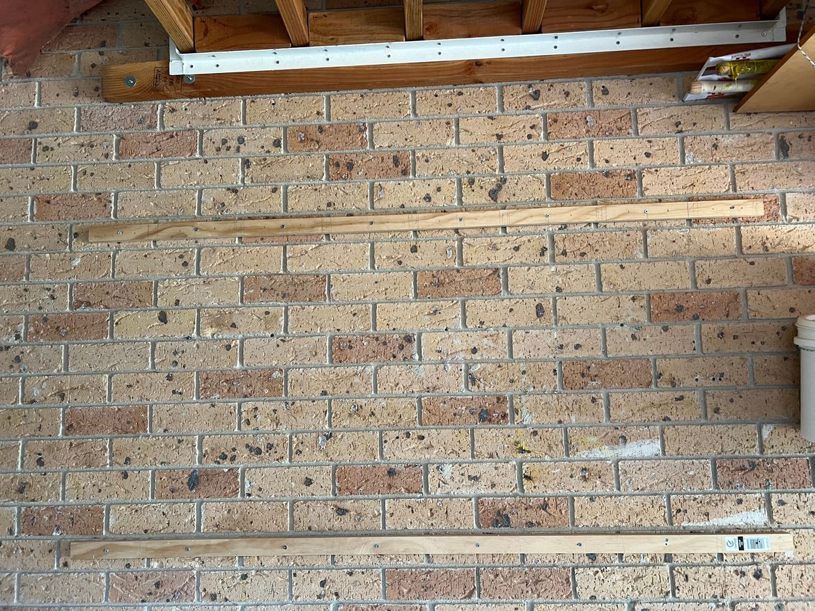

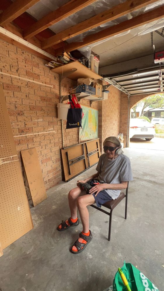

With my trustee helper, my 99-year-old grandpa, I installed two pine strips on the back along the brick for ultimate support. This allowed the hooks space to grab on at the back. Installing the board took four adults because it was that heavy.
Frame in placeFrame in place
 Always inspecting the workAlways inspecting the work
A little helper to install the boardsA little helper to install the boards

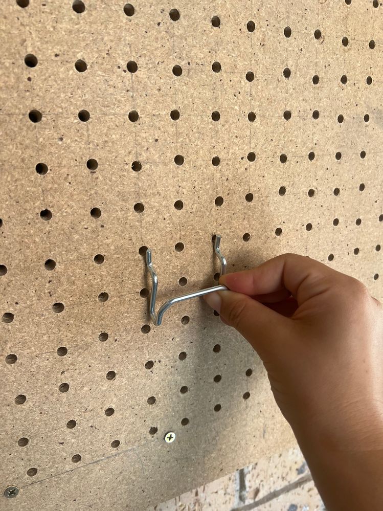

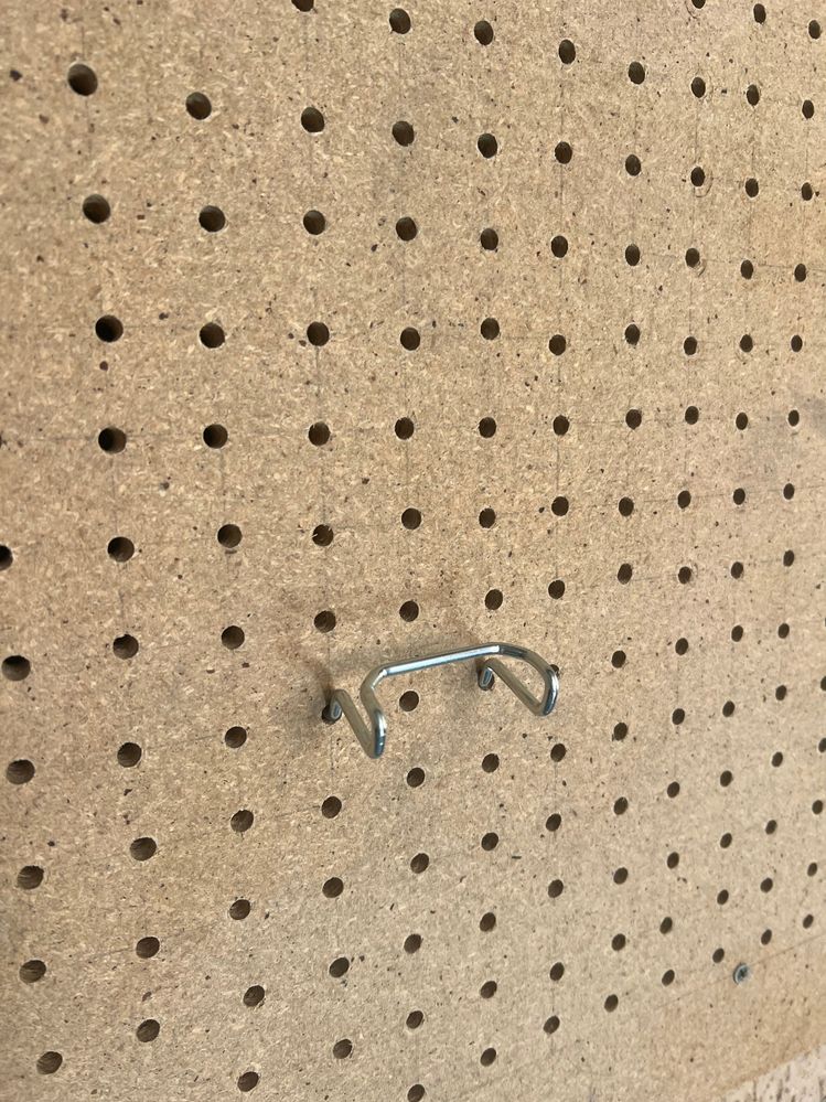

Despite my efforts of drilling over 3000 holes, as it turned out, it didn't work. You see, the standard hooks you buy are made for boards that aren't too thick. My one was about 1-inch thick - meaning no standard hook was going to fit. It was a frustrating lesson to learn.
Took 4 adults to put upTook 4 adults to put upOh no!Oh no!Oh no!!!Oh no!!!

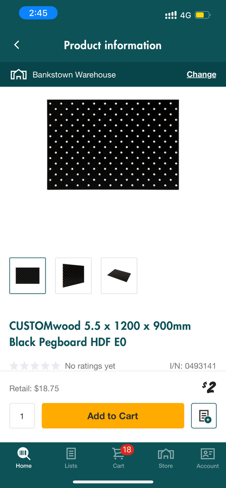

I don't know if it was good karma major win or a slap in the face, but the board I needed and should've got from the start, was on clearance for only $2. I loved it and hated it at the same time.
$2? Karma or a slap in the face?$2? Karma or a slap in the face?

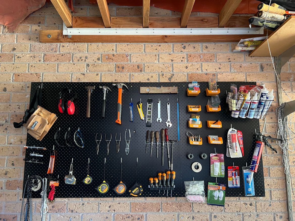

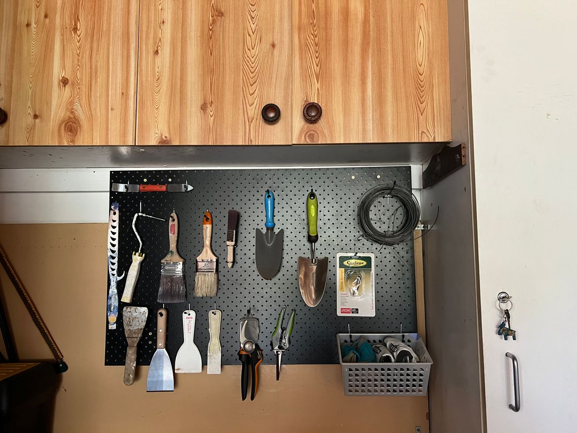

Form there, it was thankfully very easy. Because we already had the backing up, new pegboard went up with ease and then it was time to style. We had a small piece leftover so we hung that up in another area for painting/garden tools.
My mum now has an organized garage she loves and my grandpa has piece of mind that his tools will be looked after and there's plenty more room to add to the collection.
The old and the newThe old and the new
Much betterMuch better
Looking goodLooking good
Leftover boardLeftover board

Thank you so much for sharing your pegboard installation for your grandfather's tools. It looks very nice and should your grandfather decide to buy more tools there is space for a few more pieces. The best part of course is that it is now organized, and you can immediately tell if something has not been put back into place.
Again, thank you for sharing such a wonderful project.
