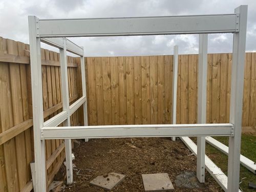

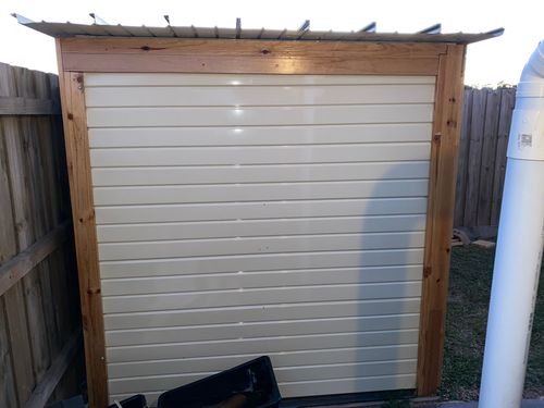

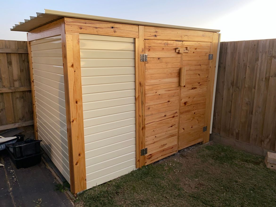

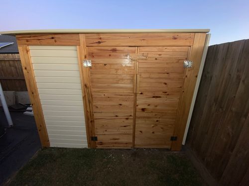

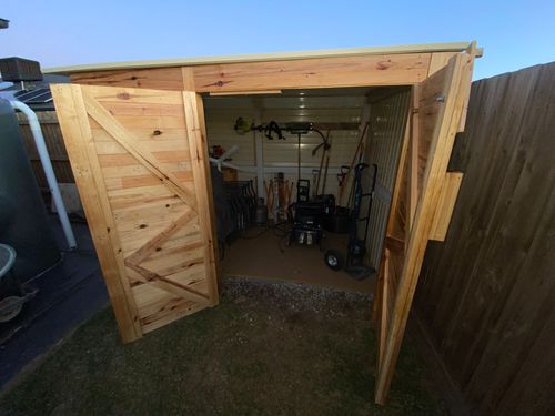

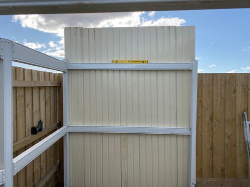

A simple garden shed that was built entirely from scrap Centenary carport components. I used 108x65 box beams as posts (although one is 158x65). Walls and roofing are made from centenary C-Deck and trimmed in wooden panels made from pallet wood. The doors are made entirely from pallet wood.
108x65 box beam (x5) surfmist
158x65 box beam (x1) surfmist
108x65 box beams for rafters and cross bracing beams.
assorted C-Deck panels.
pallet timber for door and for timber trimming.

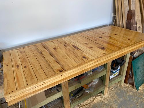

yellow-tongue flooring panels x2.
Afternoon @Arcc
Now that is a tidy looking shed! I love that you have used scrap carport materials! Serioulsy Its a freebie shed! ![]()
How has it stood up to the weather? And love the stirrups into concrete for the posts. Thats a wise idea!
