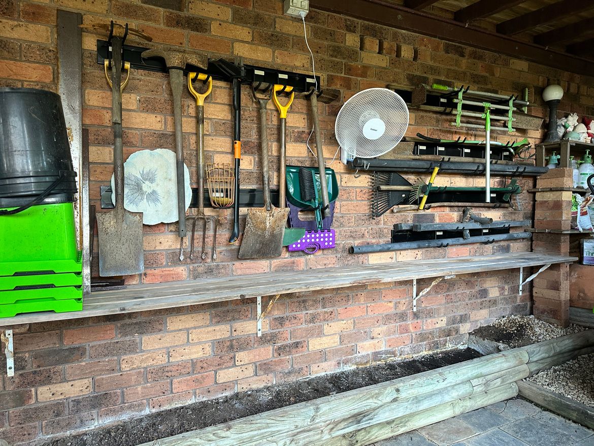

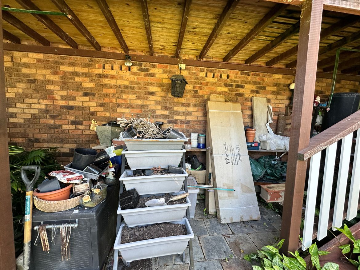

My first step at home was to clean out the storage area, ready for work. Here is the before photo - what a mess!
Once clean, I started installing one rack at a time. Each rack has 6 holes to mount with screws (two directly above each other at each end and two directly above one another. The racks come with really good quality screws and 8mm masonry wall plugs.
All four racks on the right side use two "Dual Utility Hooks"
It's important to note that the rails have a guideline of up to 100kg storage each but it does not specify the number of hooks used to satisfy that requirement. Many of my tools are my grandfather's and his were very good quality and heavy. The racks and hooks are incredibly secure and haven't slipped or bowed a millimetre since installation so I'm very satisfied.
Another important detail is installation of the hooks onto the brackets as the instructions do not provide clear directions. The hooks can be inserted anywhere along the length of the bracket. You slip the top tongue into the top groove at an angle, push the bottom middle tongue into the bottom groove with the two outside tongues at the bottom on the front of the groove, then pull the hook vertically downwards until you hear a click which locks them into position. It's important that the direction of pull is perpendicular to the rail otherwise the hook may twist sideways instead of locking. I found using small taps with a rubber mallet helped with alignment.

Thank you so much for sharing your tool bracket storage rack. It looks amazing and so well organized. It's good that you've taken a photo of the garden tool wall. There'll be no more guessing where the tools go to.
Again, thank you for sharing such a fantastic project.
