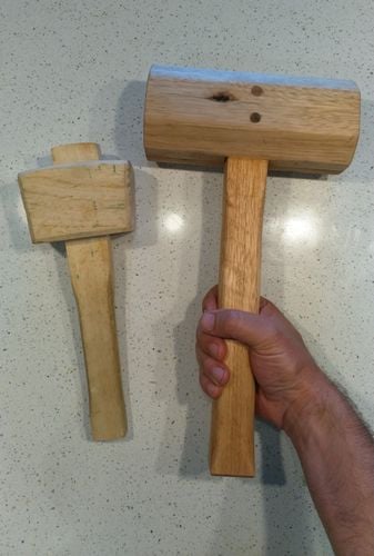

Hand made mallet
I was unsatisfied with the size and weight of the woodworking mallet I had (left) so I decided to make a new one. I slightly underestimated how big it would end up. Nicely weighted though, the head is full of tiny lead fishing sinkers for extra oomph

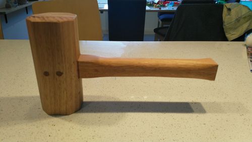

Plans for its use is basically everything you use a woodworking mallet for, chiselling, knocking in dowels and bowties,
As for how the weight was achieved, I basically followed this video, but instead of the head being made up of 3 layers, I used 2 and drilled about 70% through each with a 40mm forstner bit. I cut the slot in both sides for the handle, filled all 4 holes with sinkers and then glued the 2 sides and handle together.
