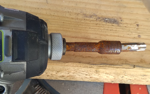

I have two of these saws in my collection and both are quite old and rusty as I keep them outside in an undercover workshop. I've just had a look at them now and mine have two different fixings. One is an allen key similar to @Tara86's, and the other is a standard bolt. Both un-screw by turning them clock-wise which is the opposite to a normal bolt. First, you need to ensure the power is off and you have removed the plug from the power point. You then need to lock the blade in position and I achieved this by placing a piece of timber under the blade and pressing the saw down onto it. For the allen key version, I cheated by using my impact driver and after about 20 secs of struggling it unscrewed the allen bolt. On the bolt version, I removed the guard on the side of the machine, attached a spanner to the bolt and tapped it with a hammer. This broke the bolt free easily.
