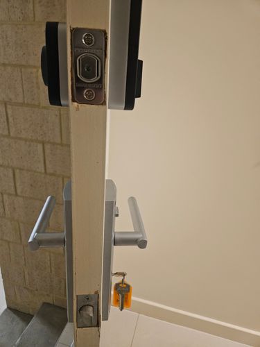

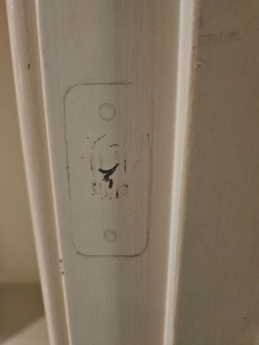

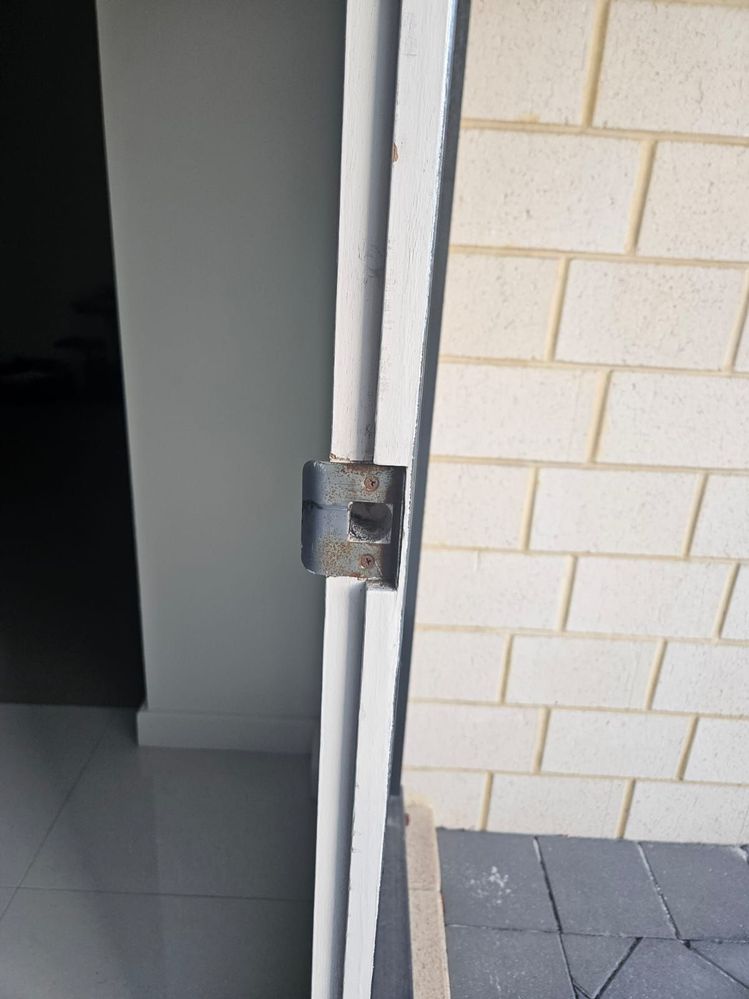

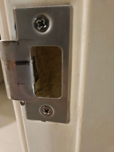

Now, I thought that the instalation of the deadbolt would be more strightforward in my front door, but I'm not so sure anymore.
Its a wooden door but it's a french or double door (I don't know exactly the difference) and I'm not sure what's the best approach here.
Please have a look at the pics below. The current latch has kind of a metal frame around it and I couldn't find something similar online for the deadbolt. Also, how can I cut the door frames like that to install the deadbolt?
