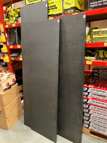

I went to purchase a Pinnacle Pegboard and got pretty confused, I want the largest possible size, and yes I have a standard MDF garage and not sure the size of the studs.
Can you advise if which one I can install inside a garage, some of them say they are for a Table install .
https://www.bunnings.com.au/pinnacle-1810-x-540mm-matte-black-metal-pegboard_p0147741
https://www.bunnings.com.au/pinnacle-790-x-1800-x-20mm-metal-pegboard_p0484534

Oh, Do i have to purchase multiple of Pinnacle 900 x 450mm Matte Black Metal Pegboard - 900 x 450mm - https://www.bunnings.com.au/pinnacle-900-x-450mm-matte-black-metal-pegboard-900-x-450mm_p0038055

Hi @JustinMcAbbe,
The Pinnacle 790 x 1800 x 20mm Metal Pegboard is designed to be installed over a bench with the Pinnacle Pegboard Bracket Set. To create the largest possible size, you would install multiple Pinnacle 900 x 450mm Matte Black Metal Pegboard - 900 x 450mm as per the video above.
The other sizes are designed to be used in combination with shelving units.
