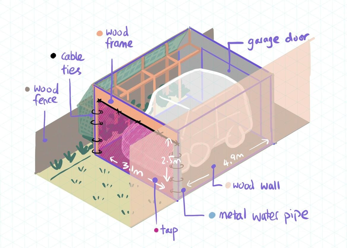

For context, my carport has a garage roller door at the front, wooden walls & fence on either side, and a temporary tarp fixture at the back. Here's a diagram:

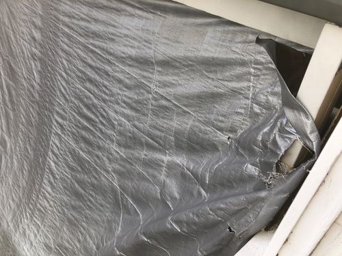

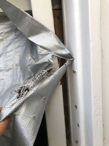

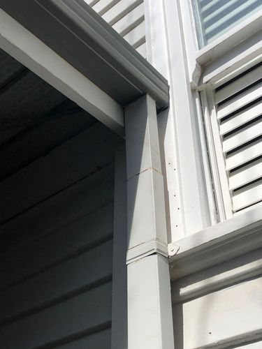

The main goal is to protect the carport from rain and weather. The current tarp has been fixed to the top of the carport frame and side of the house with wood screws. The top holds up fine, but the side has torn away. Here's a picture:

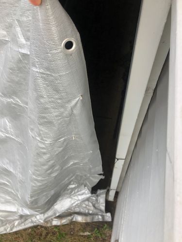

Eventually, I removed the nails on the walls and secured the side onto the metal pipe with large cable ties. This gives the tarp space to move in the wind but results in a lot of ruffle noise and unfortunately, my bedroom window is right next to it. I created extra eyelets in the tarp but they have also snapped in the wind. Also, the bottom is not fixed, so it keeps blowing and eroding away the grass in our backyard.
My question is - is there a way to fasten a tarp vertically taut onto 4 ends? These are the 4 surfaces to attach to:
Top: carport frame, wood
Left: side of house, wood
Right: carport pole, wood
Bottom: ground, soil and concrete
