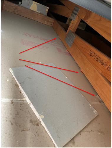

would you advise me if these photos show 1/3 or all fastener method?
Re: Installation of plasterboard

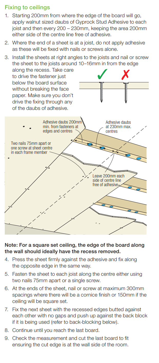

That looks like a bit of a combination @emmab1986. I've attached the guide for CSR Gyprock below. If it was 1/3, there should be dabs of glue every 230mm along the joists, and those in your image look too far apart for that. We can also see the mechanical fixings. There appears to be slightly more fixings than what would be used with 1/3, but not enough for all fasteners.
What I can say is that even if it might not strictly comply with either method, with the amount of glue and fixings used, I'm surprised it's dropped and failed like that.
From your photos, it appears that the sheet has detached from the joist as there is a gap between them @emmab1986. The sheet should be hard up against the joist. It also appears there are sections where the fixings have pulled through the sheet and the glue has let go entirely.

Hi @emmab1986
This is definitely a result of not enough glue. As @MitchellMc mentioned this is supposed to be applied every 200mm or so and the sheets screwed. The glue once set is actually whats securing the sheets to the truss joist not the screws/nails. Without glue the fasteners can't hold the weight of the ceiling sheets. This is something I had to rectify a few months back myself for a customer in their garage. I needed to apply glue and then use Acro-props to press the sheets hard up and drive in additional screws.
