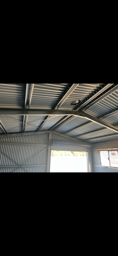

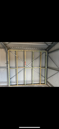

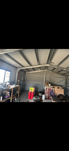

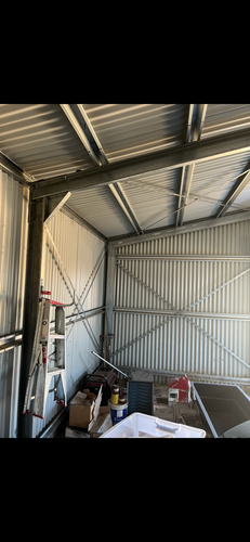

Hi EricL. Attaching some photos. I’ve made one frame up which basically fits the whole gap between the steel posts in the wall of the shed. My original intention was the have these frames throughout the shed, and was kind of hoping that because they were so tight to the steel frames, plus the fact that they would be screwed and/or bolted to the steel, that it may not have too much of a problem with expansion or contraction. I guess I need to allow for the probability that this movement of the steel is likely to happen, no matter what I do with my timber frames, but I can limit the amount of problem it causes the gyprock that’s screwed to the timber.
Hey Dave-1. I’ve attached a few photos to my reply to EricL above if you want to check them out. I will contemplate building the frames off the steel shed frames, but I’m wondering how much more difficult that will make it for me with regards to the ceiling. Because I’ll potentially not be screwing the timber frames to the steel that’s already there, how will this affect the span of the timber frames. Unfortunately my skillset doesn’t go any further than building the frames and screwing/bolting them to what’s already there. At least not at this stage.

Now that you've built a standalone frame, I'd be happy for you to connect it directly to the vertical steel posts. It will be best that the corner of this frame and the next be mechanically fixed together. That will add rigidity to the corner and help prevent flexing there. Since you now have self-supporting frames, the chances of cracking in the joints have been minimised.
I think you'll be fine attaching to the steel on the roof as long as you do the same as the walls and create a frame. With movement, the whole timber frame will move instead of individual timber lengths attached to the steel. Remember, even houses move with expansion and contraction, so a little movement will be fine.

Thank you for the photos and you are doing pretty much what I did with my lining in the garage. I agree with @MitchellMc's comment about the walls should be fine. The only bit I would sugest is not to wedge the frame in so tight (I did that a few times and it created an issue when I was trying to get things straight)
One other thing I found as I was doing the frames in segmants to fit between pillars and not a long wall was keeping them all level, top and bottom along the whole length. Frames on the own = fine, Frames with plaster on them, you need it straight. Looking at your steel posts, you have a plate at the top that will impact the plaster if you are worried about a purely plaster wall. You could just plaster up to the plate and then give it a straight edge and make it look like its meant to be
(The same way you make an edge for a corner or a span above a alcove say)
Instead of screwing the frames to the steel frame directly, you could use some steel straps between the timber and the posts. Gives it solidness without it being totally ridgid?
