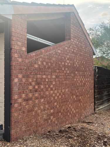

Is it simple enough to install cladding over existing brickwork on a street facing wall amid a garage, that is not attached to the house purely for cosmetic needs, can I slip all the flashing etc and just stretch to battens on the bricks

I dont see why not, tho I would have a look at your local councils website to find out what is allowed and how far from your fenceline/boundary line you can take something. I am thinking that with the cladding it shouldnt add much more to the walls width but council may have other rulings.
Factoring in the flashing and rails to support the cladding on a narrow face may require some figuring out especially if you are not familure with it. (I am not
) I would sketch it up, profile wise and work out the depth of the wall, height and how it will all come together. That will help with any "ohhh" moments when you go to instyall it.

It's not a major project to achieve. It would be a matter of fixing horizontal battens to the brick wall to secure the colourbond sheets to. This would be easier than fixing there sheets directly. Something like 70mm x 35mm treated pine would work as battens with 60mm roofing screws to secure the sheets. You would then need custom flashing made up from your local plumbing suppliers for all edges.
There sis a fair bit of work involved as well as expense. Plus the cutting of the sheets to match the wall profile and opening. Would something more simpler like painting the brick, and attaching a some form of feature panels and then a garden in front?
