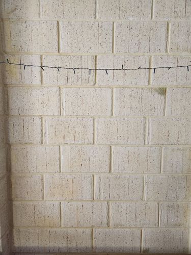

Im pretty sure the bricks I have are hollow core I believe image attached below.
Im thinking of like power and hand tool type of weight, probably my circular saw being the heaviest. Maybe a small cabinet for small cabinet or something along those lines.
Thanks
Re: How to add French cleats to a brick wall?
Hi @kelso101
Just to add to the suggestions made, I recommend using Ramset 300ml Chemset UltraFix Plus along with Ramset M10 x 130mm Galvanised Chemset Stud in combination with Ramset Multifit Sieve in the corners of the plywood. This type of fixing does not put any pre-stress on the brick's interior unlike Dynabolts. This means that once the adhesive cures it acts like it's part of the brick and the only stress on it would be the load of the plywood sheet and tools.
You can then use wall plugs or Dynabolts for the centre part of the plywood. Using a combined fixing strategy of screws and adhesive it should be strong enough to hold your tools and a small cabinet. I strongly suggest drawing it on paper first so that you can estimate the size of the panel and number of screws you'll be needing for the project.
