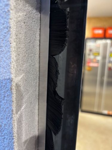

I have a main double width panel garage door and at the rear, a single roller. I used this product along the top of both. The roller door gets a lot of weather and wind. I solved that issue by installing the same product in-between the vertical guide track and wall of the garage. The brushes follow the profile of the roller door perfectly during operation and close with no impedance. Since then, I get zero weather coming in and just a very slight breeze on very strong wind days.
