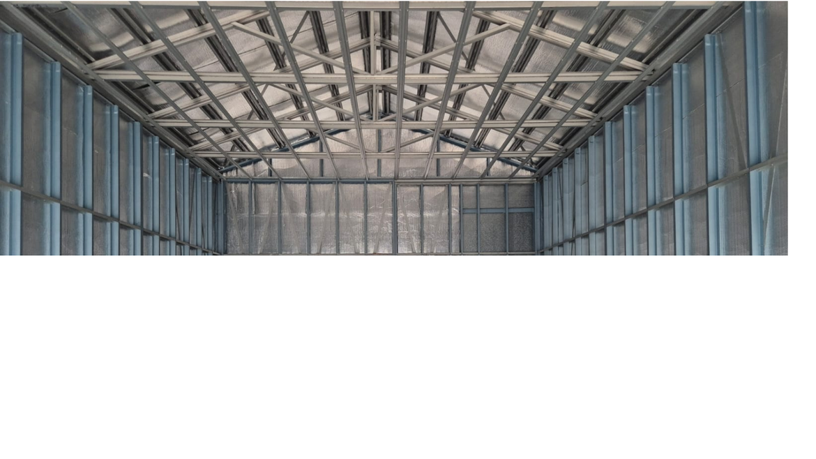

Was looking to put insulation in this shed ceiling before gyprock, can I use poly strapping to hold the insulation in place, if so how would I affix to the steel frame? And should I be affixing to studs or battens ?
Thanks for any advice

Thank you for your question about installing insulation in your steel-framed shed.
It should be installed on the battens, so the insulation is in direct contact with the back of the plasterboard sheeting.
You can use Zenith 8G x 20mm Galvanised Button Head Metal Screws to fix the strapping in place. These screws are very low profile and do not cause any bulging in the plasterboard.
