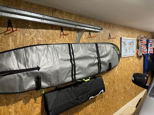

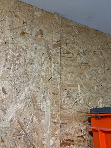

OSB board has a sealed and an unsealed side, unless the supplier has changed at Bunnings @MitchellMc ? See side by side photo below. I wouldn't paint it as the point of using OSB is to see the timber pattern. Otherwise just use plywood.
It can be butt-joined together and if you have any gaps you can make up your own cover straps with an off-cut. When cutting the board, do so face down to reduce splintering on the sealed side. Also be VERY careful handling the cut edges as the splinters bite in very easily.
