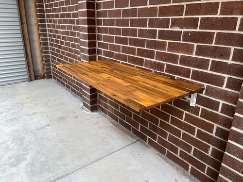

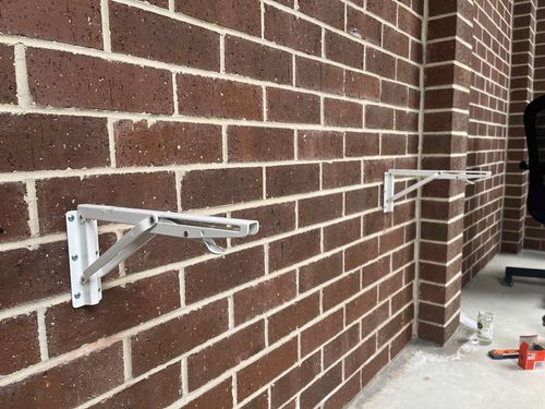

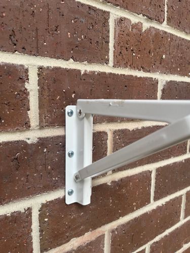

Thanks to your help I managed get this done! So I ended up totally wrecking the first masonry drill bit I used for the first two holes. I started with the 8mm bit from a Ryobi multi-bit kit. I pressed too hard and without stopping, so heat ended up rendering it useless. Did a bit of googling on masonry drilling, and discovered I should be moving the bit in and out as I go and applying firm but minimal pressure so that the hammer function can do the work.
Once I knew how to manage the drill properly, I bought a second bit from Bunnings and that fared a lot better. You recommended the Full Boar, but I ended up getting a Sutton 8.0 x 120mm masonry bit after chatting to a staff member. Took my time instead of putting my weight behind the drill and it got there slowly but surely with 18V ONE+ Hammer Drill. I also sprayed some water in the hole and dipped the bit in water every so often.
I positioned the brackets about 750mm up as I'll be using the bench from a seated position. I mounted the Teak Acacia Panel using Zenith 8G x 15mm timber screws (instead of 200mm as I thought these might crack the panel surface after lining them up.)
I'm happy with the result overall. I'd say a couple of points I could've considered better –
  • Leave a little space between the panel and the brick when mounting, as the unlocking function of the brackets is a bit stiff with no breathing room.
  • The brackets only extend 315mm along the 600mm panel's depth. While the panel is stable, there is some flex on the unsupported half of the panel when resting your forearms. For my application (light craft work) this is fine, but if you wanted better stability I'd find some deeper brackets.
  • I could have marked the points to drill with pencil on tape. Marking the brick and soft mortar directly made it far more difficult to trust my measurements.
Thanks again! I'll use the measuring and anchor techniques you taught me to install shelves next.
