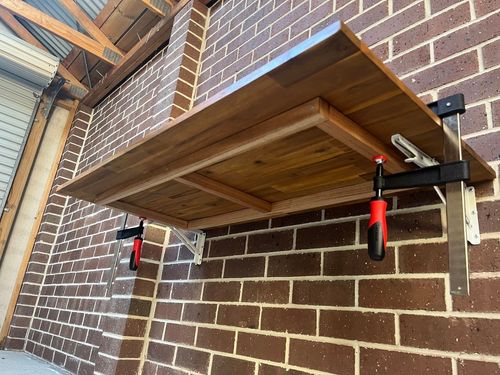

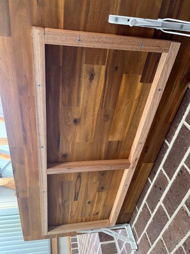

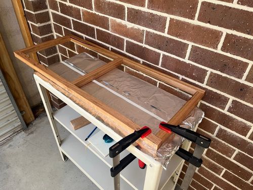

Thanks for the advice and mock-up on reinforcing the bench I put together! It's definitely added the extra stability I was after –
A big lesson for me was drilling pilot holes first. This made connecting the support piece a breeze.
I drilled a screw into the 30x30mm hardwood without pilot holes on a test piece and it split straightaway.

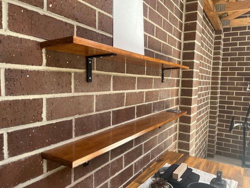

So I've added some shelves above the desk that I'm pretty happy with how they turned out.
I got some 1200mm wide timber pieces and stained them with Cabot's water-based interior stain and varnish.
