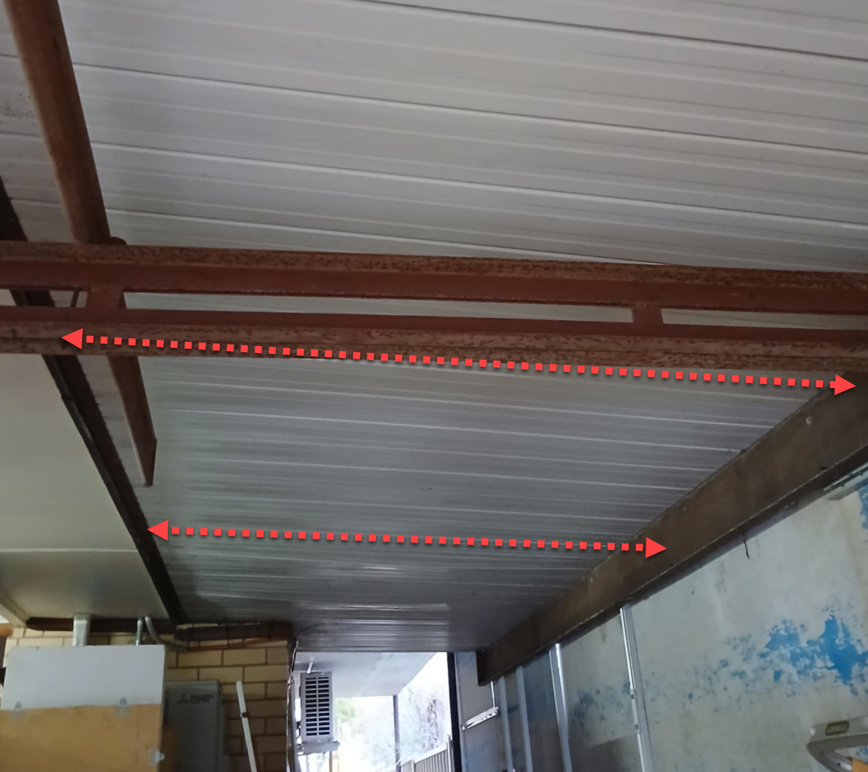

that is the underside of the roof.

As @JacobZ mentioned, the light battens would be fixed to timbers fixed to the sheets, spanning from thew left eve house facia across to the carport facia.

Yeah, you're going to want to run some timbers across from the timber beam to the eave.
You could use some 70x35 framing with some angle brackets and timber screws to fix it in place.
This method will avoid any drilling into the roofing sheets which are not designed to support any weight.
