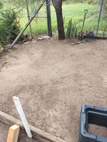

I just want to put up a small tin shed,what is the cheapest way to do this please,

The tin shed is 6foot x 8 foot.
Could I just lay some Crusher dust and level that off to put shed on,?
You could do that if you wished, @Maria1. It wouldn't be a recommended base choice from a shed manufacturer, but at least that would give you a floor that wouldn't get muddy. As I mentioned, without a solid base to bolt the shed down to, you run the risk of it blowing away in high winds. You might be able to use some ground screws to secure the shed.
Did you already have the shed or were you looking the purchase one? The closest shed we'd have to 1.8 x 2.4m would be the Absco Sheds 2.26 x 1.52 x 2.08m Zinc Economy Single Door Garden Shed. You might like to take a look at our range of economy sheds.
