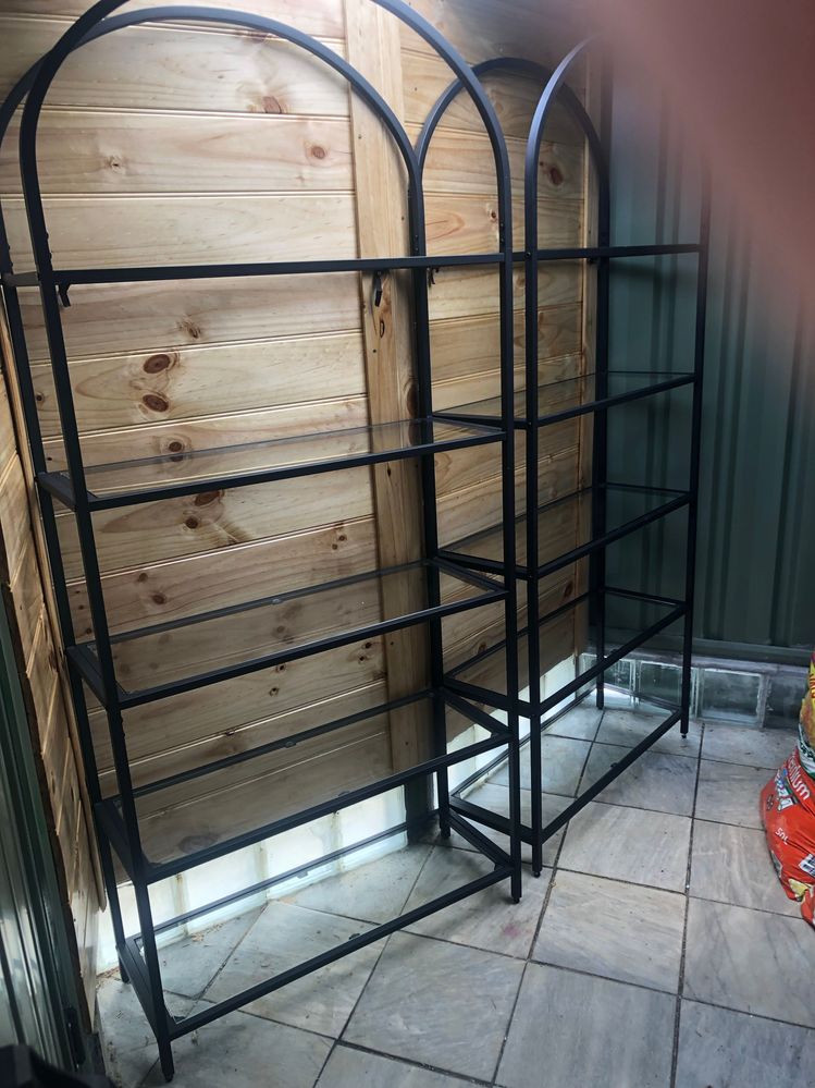

Photo of ship lap I used in my shed horizontially as I mounted to posts (vertical not rails horizontal) so picture this pattern vertically
I would buy the 5 meter lengths I couldnt find it on bunnings web site.
