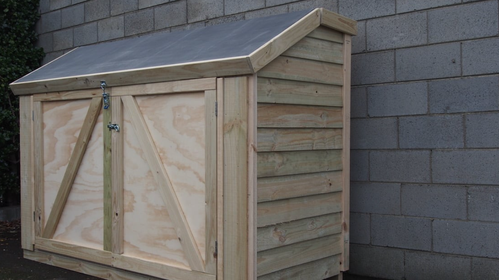

I'm looking to further solidify my plans to build a bike shed.
I have had a look through a couple of other examples in the group, particularly your plans for the Pool Pump Cover which I've based my construction on.

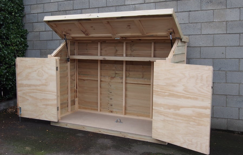

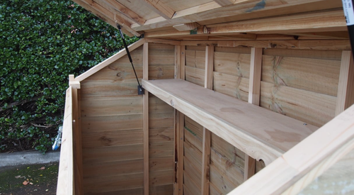

This has been my inspiration, I like that it opens up so wide for bike access and also allows for a handy shelf for helmets etc
Size will be approximately 2m long, 1m wide, 1.5m high.
Framing - use treated pine 70 x 35 for studs and frame
H4 treated pine bearers for the base. It will sit on a gravel pad. What size bearers do you recommend? Was thinking 3 that run the length of the shed.
Yellow tongue board for flooring (I know it is only water resistant, but it should be fairly well protected from the rain.
Possibly Weathertex weathergroove panels for the cladding?
Roofing - not sure about this, something that is flexible enough to only require 1 piece to avoid any joins?
I really like the idea of a roof that opens like this, so you get easier access for your bikes.
Thanks for your help, any advice appreciated

It's not really designed for this purpose but something like this Ultimate Flooring Multi Purpose Rubber Mat would be flexible enough to allow the roof to open, while being resistant to water. The only other thing I could think of was CAgroup 1000mm x 20m Malthoid 2 Ply Bituminous Felt, but I'm not sure how well it would stand up to the movement at the hinge.

Thats a nice storage box for sure. My head went straight towards the thin rubber matting you see in the back of vans/utes for the roofing for some reason, mostly because its flexible and potentially you could have it go over the top of the hinge join as well for the roof. I would liquid nail it to the timber of the roofing. Plus a few of the rubber washered roofing screws just to be sure in the corners..
