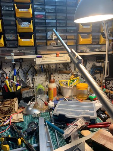

have had trouble getting into the draws in front of my desk, so after you gave me the Idea I made this yesterday.
I used a pole I saved from my daughters old clothe ironing stand that adjust in length
and bent and welded 2 bits of aluminium together to make the hook. It works super
Hi @Super_D
That is such an impressive device. Have you considered putting a rubber strip on the inside lip of the square "U" channel? I'm just worried that if the box is too heavy it might slip out of the grip of the hook. But I suppose the bottom pusher prevents that from happening.
Thank you for sharing such a fantastic idea.
Thanks EricL, I can try a strip of rubber, and see how it goes. thanks for the tip.
