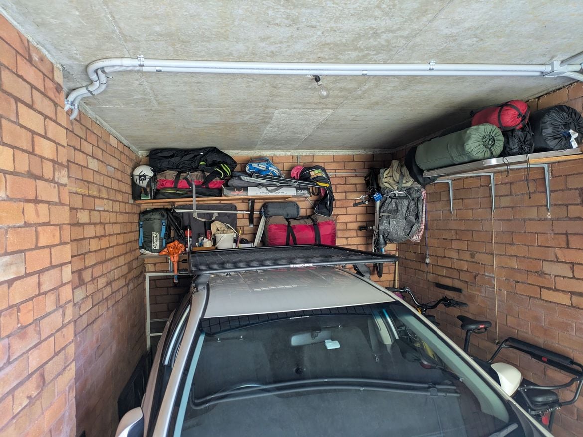

I'm piggy-backing off another thread here which has inspired me to attempt to build a free-standing mezzanine storage in my single brick wall lock-up garage in a strata building, as a replacement for the very basic shelves left from a previous owner.
The Initial response given by JacobZ in that thread made a lot of sense to me and I've sketched out a few options based on the information provided about span tables and deck planning.
The space I have to play with at the rear of my garage has a width of 2860mm and depth of ~2600mm. The ceiling is about 2600mm, so I'd be looking at shelf heigh of ~2100mm. The mezzanine would be entirely for storage, and the total live weight of storage items would typically be 150kg - mostly consisting of camping gear and roof racks.
There is no option for a centre bearer so the joists will need to span the full width of 2860mm. I have flexibility with the length of two bearers, with the only constraint being that they must be less than 2600mm.
The garage has my car and bicycle parked next to each other - it is pretty tight as it is - so I would prefer if the posts of this structure were narrow, or at least placed in such a way that they aren't getting in the way.
I am 194cm tall so ideally the joists would be at least 1950mm off the ground so I'm not banging my head all the time.
