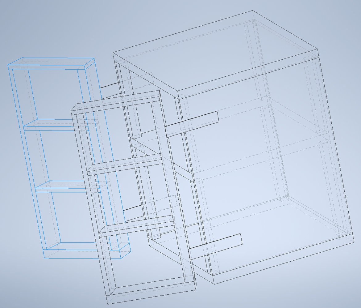

I’ve done a model of it (I’ll be building the unit in two pieces, with one stacked on the other) the bottom unit will have castors and each door will also have a castor to support it. The hinge mechanisms might need to be something like gate hinges so the axis of opening is at the front corner of the door, not the corner by the cupboard bit. This is because I want the cupboard door to open with them being no wider than the unit. My quick diagram shows the hinges in the wrong place for now, but what you suggested is quite similar to what I imagined. I’ll update my drawings to include the hinges in the right place. I think I’ll also make the doors thinner (maybe 120 mm deep instead of 200).

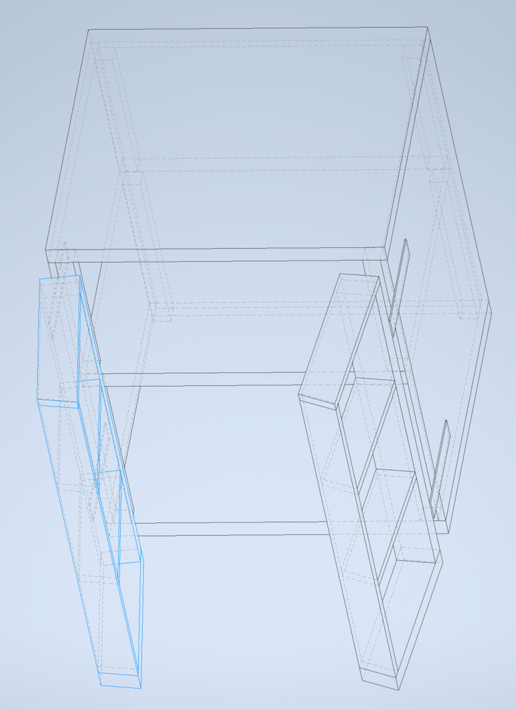

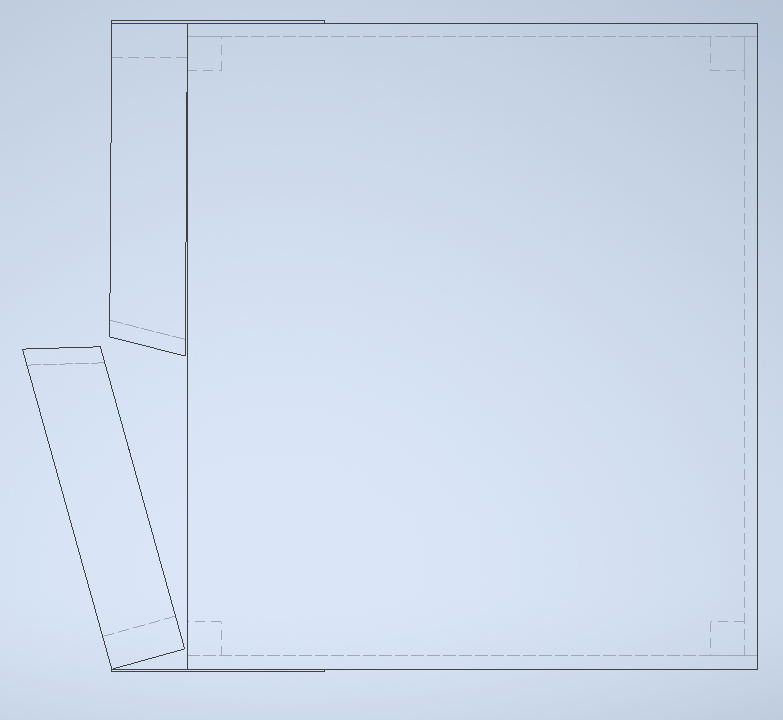

Here's an updated drawing with 'hinges' roughly in the right places. I've put 50mm * 3mm steel bars on the sides which will have hinges attached to the end, to allow the doors to open within the same width as the cupboard itself. The faces of the doors that face eachother are at an angle so one door has to open before the other, but at least they open without being jammed in place by having the hinges where they are.
The drawing shows the doors to by 89mm wide which matches lengths of 89mm * 19mm pine - I may use offcuts of the 40mm pine board for these parts depending on how the boards need to be cut and if there's enough board left for this.

Hi @grantburrows,
I've run some tests in 3D-design software, and I believe that if standard hinges are used and placed where they'd typically go, even with the 89mm thickness of the doors, they are not going to jamb when opening. Yes, if the doors are hard up against each other, they'll bind, but my experiment reveals that even a 1mm clearance between the doors would allow them to open. They jamb at around a 210mm thick door with only a 1mm gap between them. Maybe have a play and see if you get a similar result, as it would be good to do away with the current hinge system and angled door edge. I could be completely wrong here, but it's worth checking.

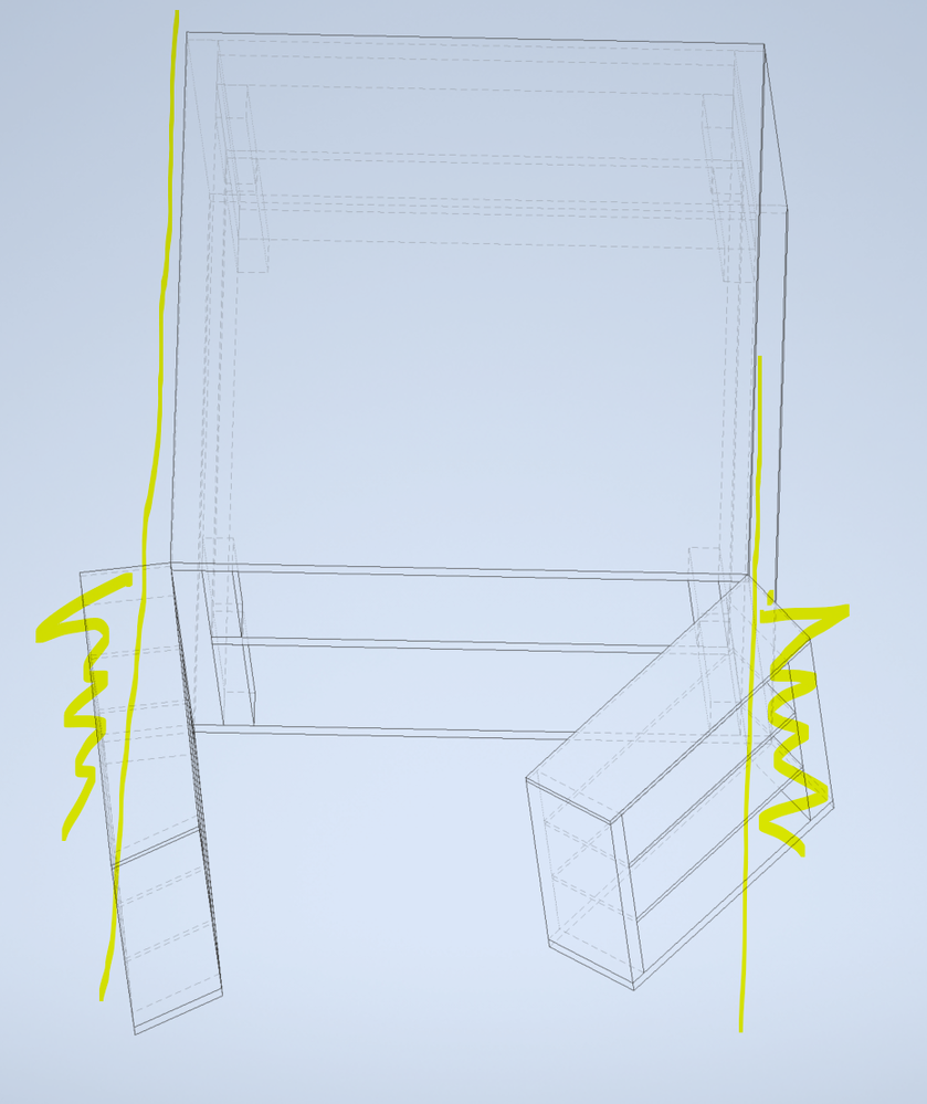

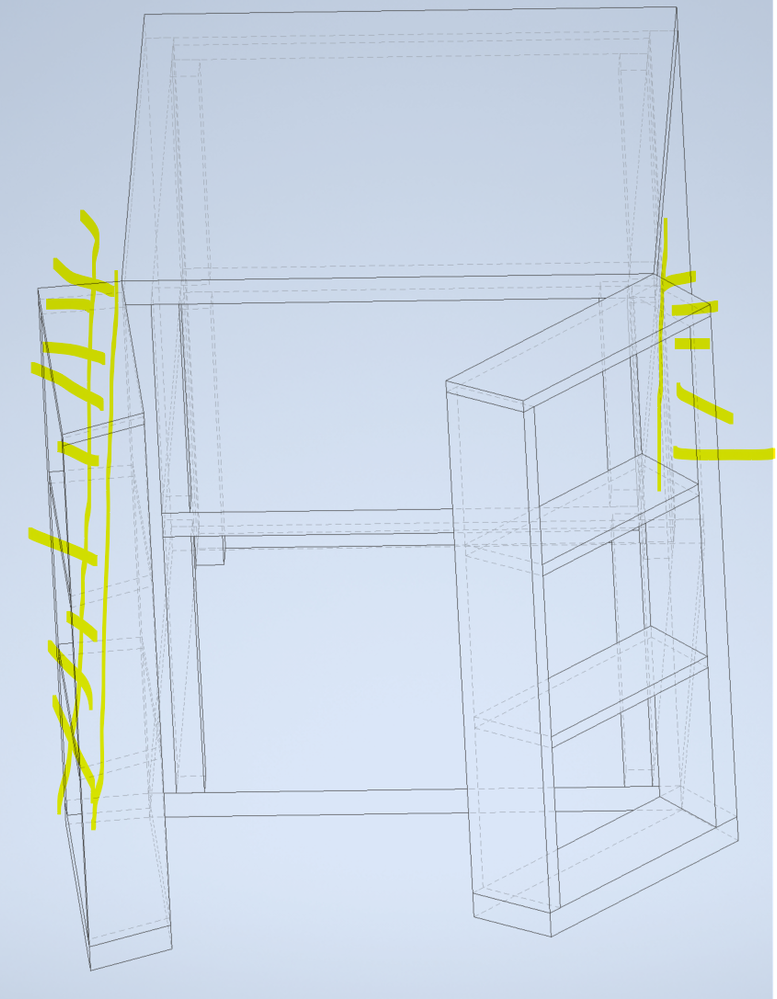

My problem is that the cupboard is almost the same width as my storage cage and there is only about 10-20mm of wiggle room to wheel the cupboard in and out. there isn't room to open the doors much wider than the width of the unit - so my first drawing with the hinges mounted in a conventional way, won't work - I've included new drawings with yellow lines showing the bits of the doors that would hit the sides of my storage cage - imagine the width of my storage cage is shown by the yellow lines - note the top pic shows the doors will open to 90 degrees without hitting the sides of the cage..
design with crazy hinges but doors open within the space available
the doors will hit the sides of the cage when open
conventionally hinged doors cause doors to hit sides of my storage cage
Oh, ok, @grantburrows! I didn't realise the doors couldn't open wider than the width of the cabinet. The hinge location was as per your second image.
