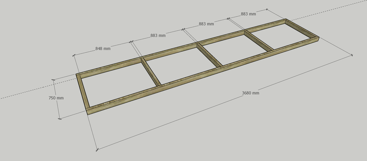

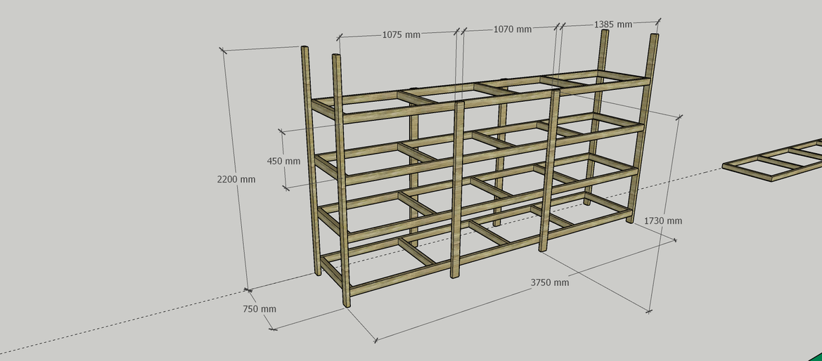

Please give me some time to draw up a sample frame, I will post it here as soon as I finish it.
Hello @Revi

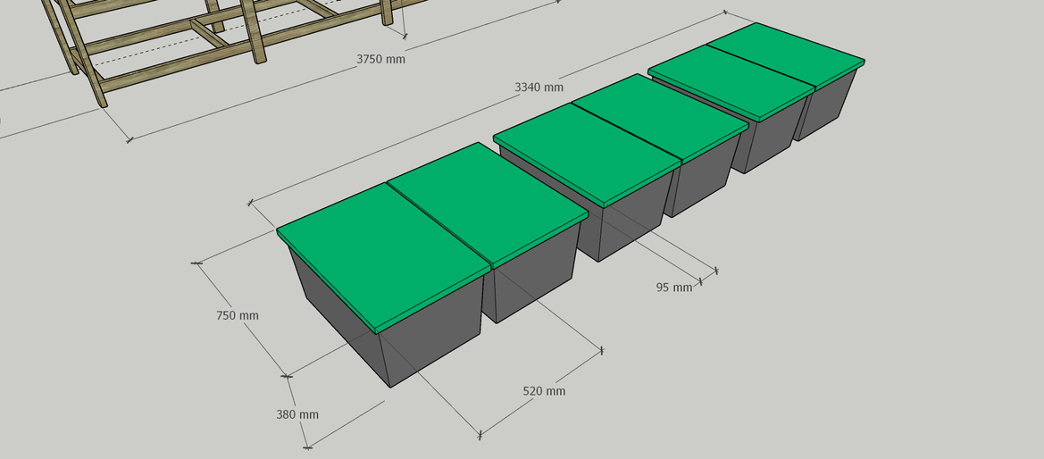

Thank you for your patience. I've placed some images below to give you an idea of what the timber shelves could look like. The frame is based off the All Set 100L Grey And Green Heavy Duty Storage Container With Flat Lid. It comes in different sizes, so I recommend visiting your local store to see which storage container suites your needs. I maximized the timber frame based on the measurements you've provided, but please adjust them to your needs.
I recommend using Zenith 10 - 8 x 100mm Galvanised Countersunk Rib Head Timber Screws - 50 Pack to anchor the timber frame together. My best advice is to drill pilot holes to prevent cracking the timber and prevent snapping the heads off. However, for the legs in the middle I suggest Zenith 10 - 8 x 65mm Galvanised Countersunk Rib Head Timber Screws.
