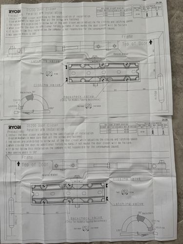

I went and grabbed one so I could work it out for myself.
Here are the install instructions for both left and right-handed installations.
If you are finding the arm is pulling in the wrong direction, you would simply flip the unit over and change the orientation of the face plate.
You can see in the instructions that the backcheck valve, labelled BC on the unit, is on different sides depending on the orientation.
There's a good chance your holes are in the wrong location which would mean you need to alter the screw locations based on the measurements in the above plans.
Try flipping the unit over and let me know how it goes.

Hi Jacob
Thanks for the instructions. Different to what was in my pack as mine is mounted on the door jamb but while I can't find a template I should be able to work out where it should be so will see what I can do.
