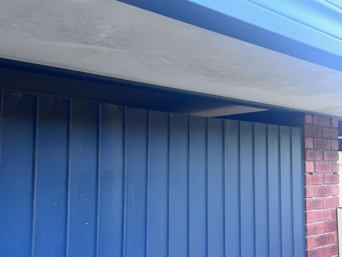

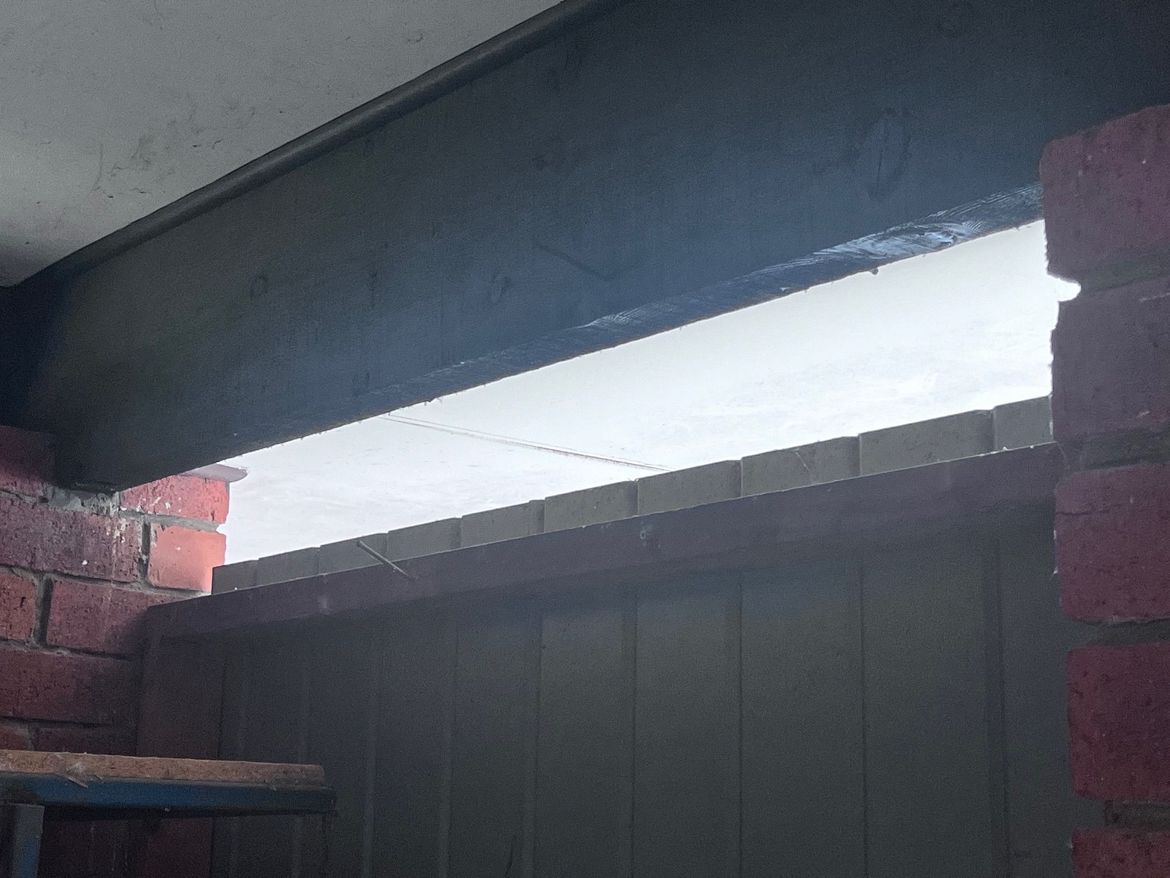

Hi, I've recently moved into a new home, and I've got a shed that has a rather large gap between its walls and the ceiling. The space has a shared roof with the rest of the house and is supported by brick piers framed out with wood and external cladding on two walls, and the other two walls are brick. As a stop gap measure, I've thought about expanding foam, but I'd like to eventually plaster the walls inside and potentially use the space as an office.
Any advice or suggestions would be greatly appreciated.

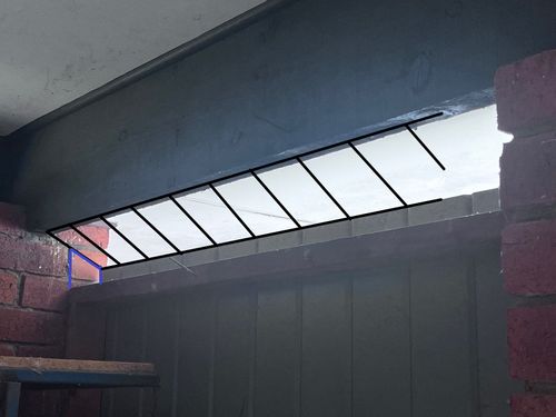

Hi @artizan,
Timber at the ends secured with brackets.
Roofing with same profile go's under at the top and overlaps at the bottom.
Cheers

Thanks Alan, really appreciate the suggestion, and for illustrating what I'm looking at. I'll give it a crack!
