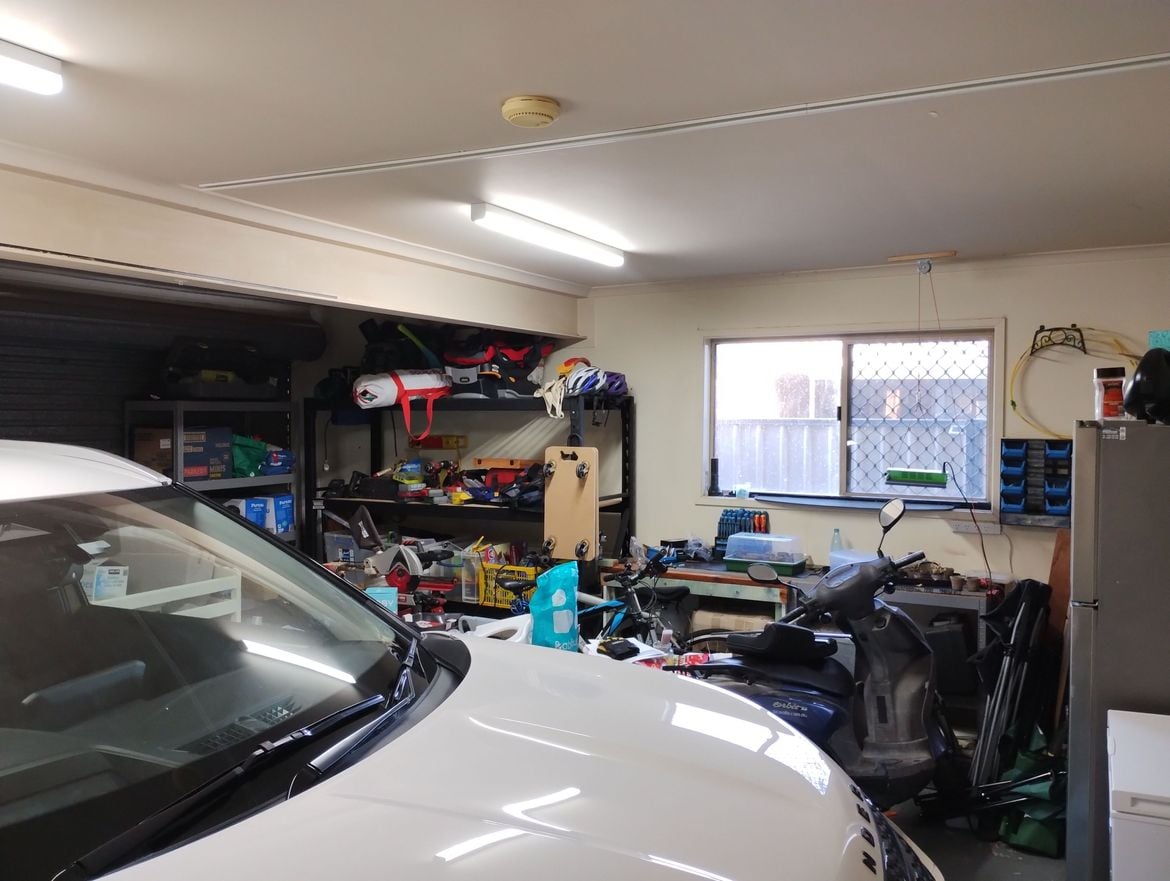

- Current garage 6 x 6m located immediately below master bedroom to be used for craft room and office.
- The floor of the garage is part of the main slab; council-approved plans show has waterproof membrane under the slab and original termite treatment.
- External Walls are brick veneer, with FC sheet lining, internal wall boundary to house. Stud spacing is 600mm
- Internal garage walls to house are also FC lined with stud walls at 600m
- Single existing window approx. 900 x 600mm in external wall.
- Height floor to ceiling is 2490mm. The ceiling is gyprock.
- Single entry door from garage to house with 75mm step up to kitchen/dining area.
- External drop from garage to path is approx. 25mm

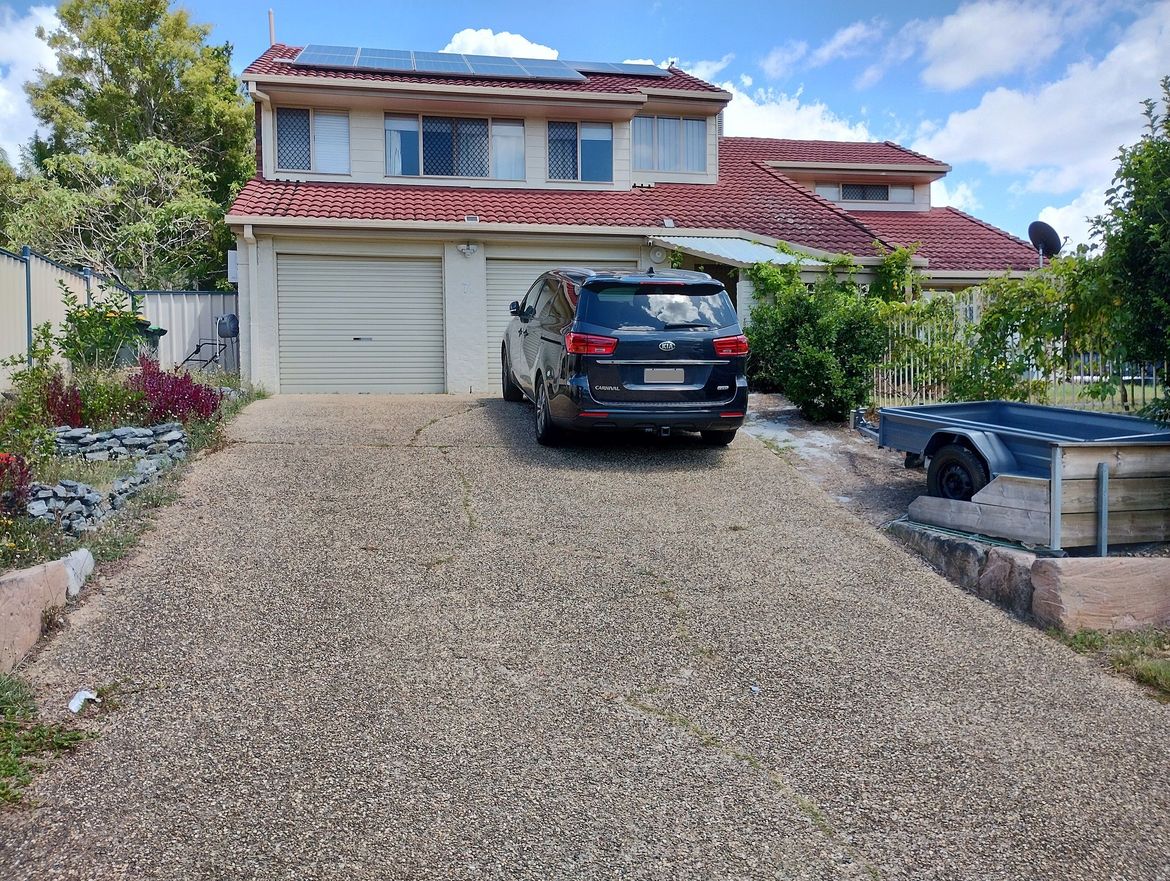

- Two existing roll-a-doors 2410 x 2100mm will be replaced by aluminium sliding doors of the same dimensions, or fixed walls/windows to provide >>10% room area light into room.
- The house is on the high side of the street, and the driveway drops away rapidly from the front of the garage

Not sure what to do about height of garage floor at current rolla door entry, as I think there needs to be a drop to the outside to prevent water entry. Could perhaps put a single brick height with damp-course and waterproofing at the bottom of where the existing garage doors are, and then either build a new wall/windows on top of that, or a wall with sliding aluminium windows in it.
Another option is to create a new floor in the garage to meet the existing floor height from the house. Could say, anchor 70x35 MGP10 H2 framing timber to the garage floor in a grid pattern (450mm centres?) and cover with yellow tongue flooring? Then have this butt up against the single brick barrier mentioned above?
Have I missed anything?
