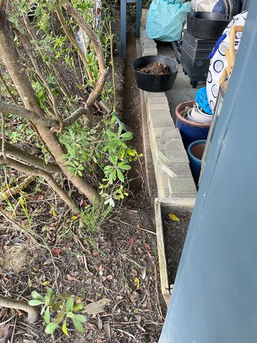

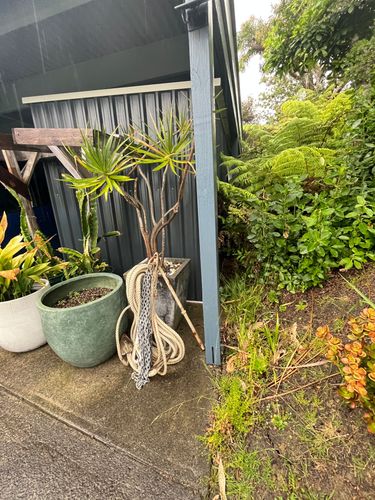

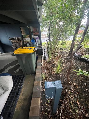

My home is on a slope, so when it rains my carport floods. I need to find a cost friendly solution for this. I have already started digging a channel on one side, but it has gotten hard due to root systems. On the other side I haven't even tried, as it is full of vegetation, so I wanted to reassess my options. I am concerned that on the vegetation side I wont be able to create a slopped channel to redirect the water as there is pavement from the drive.

Nailing your drainage is the first thing you'll need to do, and the channel you have started digging is a good start. In an ideal situation, you would excavate all the land around the structure so that it sits below the foundation and slopes away from it. In your situation, this doesn't seem possible, but excavating the soil so it is further back from the structure is going to be vital. Ideally, the soil should sit at least 100mm below the top of the concrete slab on all sides. On the side that is currently full of vegetation, it looks like you might need to install some retaining walls to hold back the soil in order to achieve this.
Once the soil has been removed and retained, you'll want to install drainage, such as drainage channels or french drains, which transport the water to a location elsewhere, preferably a stormwater pipe that connects to your council stormwater system.

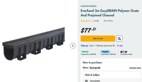

You have started digging which if fine so let's do some step-by-step drainage planning - including costs.
The first thing we need to decide is the type of drain so the proper trench can be dug.
Drain Choice:
@JacobZ suggested the Everhard drainage system and having used that on many jobs - I agree.
Forgetting the stainless steel version leaves us with a choice of two - compact or regular.
I recommend the regular 3M length.
With your budget in mind I would like you to estimate the number of 3M lengths required and is the cost OK to proceed.

- Drainage needs to be sorted to the maxium amount possible, otherwise all yoru work will end up with water inside. @JacobZ mentions that the drainage should be 100mm below the slab. I whole heartedly agree with him. I did NOT do that for my retrofitting and then had to come back and escavate a large chunk of earth/clay/piping. Fixing water ingress issues in garage shows how I fixed my issue.
- Sketch your idea out first and then accurate measurements of your garage and what you want to do. Floor to ceiling should be 2.4m if its less then you are going to cook in an oven 😕
- The drainage needs to go somewhere away from teh garage and preferably into the stormwater system or reuse within your yard.
- Retaining walls for both sides that you have soil against, preferably with an air gap between them and the building. The roots/shrubs/trees will have to go or plans changed to accomodate them. Gabion Wall to stop water ingress to garage
