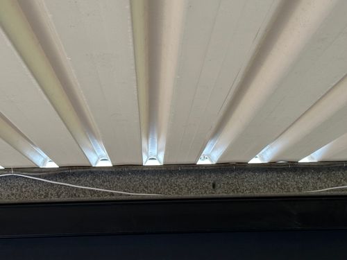

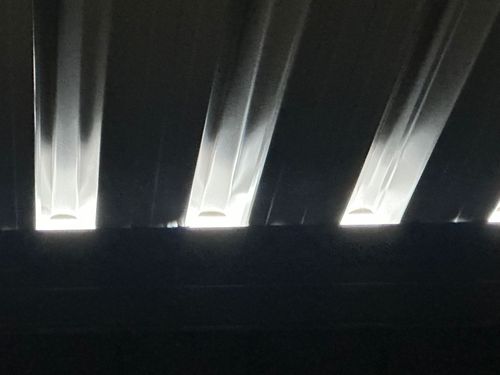

I have a new veranda. It is enclosed on 3sides one side open. On the side where the gutter is. There is a gap that lets in dust and large amount of light. How can enclose this

Ideally, it would have been best to install a profiled foam strip similar to the Suntuf Black Greca Foam Infill before screwing the roof sheets down. Now that it is installed, you could take these strips and cut the sections out, which should closely match the openings. You can compress the foam and push the sections into the gaps. Alternatively, you could use expanding foam, but cutting the black infill strips into pieces would give you a far nicer appearance.
