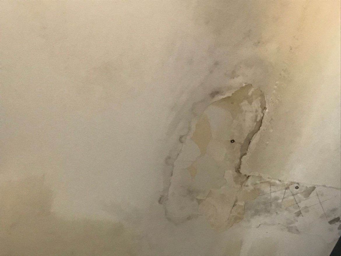

I need to repair my garage ceiling , could you Please tell me what materials and steps to fix the ceiling
this is the damage and please find attached photo

First, you will need to take a paint scraper and remove any loose material from the area. You should then follow that up with sanding the area with Flexovit 100mm x 1m 180 Grit Painted Surfaces Sandpaper Roll to remove any uneven surfaces or residual flaking. Next, take some Spakfilla and a plastic joint knife and apply an even coating over the area. Go back over that area once dry with the sandpaper to remove any excess Spakfilla or imperfections. To seal the area I would recommend Zinsser 1l B-I-N Primer Sealer Stain Killer as not only does it prime ready for paint, but will block that staining from coming through the topcoat.
Once you have followed that method you can choose your own preferred ceiling paint to apply over the area.
Here's a helpful step-by-step D.I.Y article on How to patch plaster which you might find of assistance in the process.

Could you please update us with an image on what the area looks like now that you have prepared it? You might need to build the Spakfilla up in thinner layers as possibly too much is being applied at the one time. You can try the CSR joint compound, but it is a very similar product and will also need to be applied in thin layers.
Try working on just a small area at a time, fill the deepest areas first and allow them to dry. The product needs to be applied in thin layers (less than 3mm) allowing the previous one to dry before starting the next one.

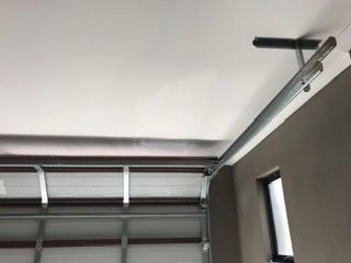

Sorry about the very late update of my ceiling repair, it was not too bad for my first time, thank you very much for your advice

Looks great @Maymay. Well done and thanks for sharing.
