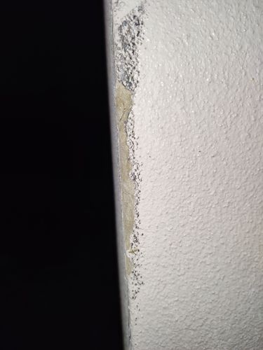

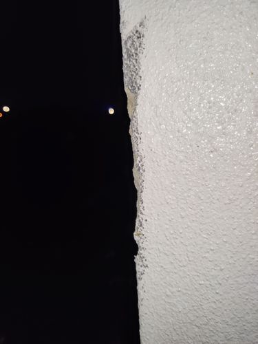

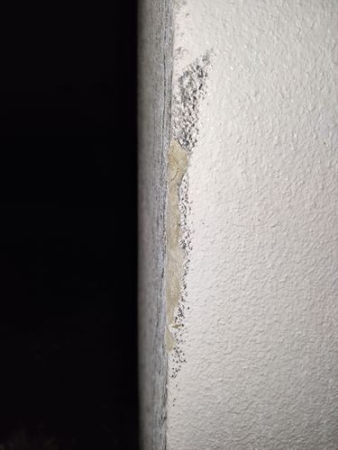

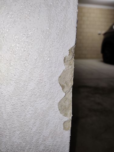

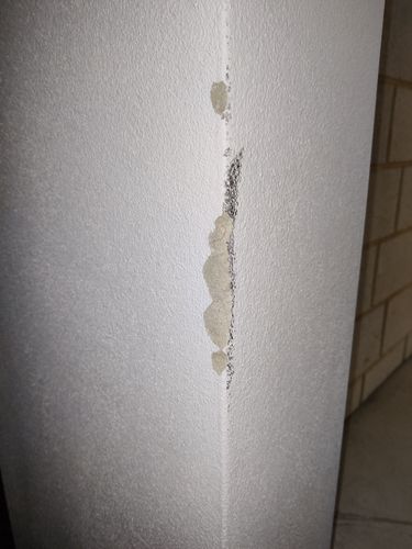

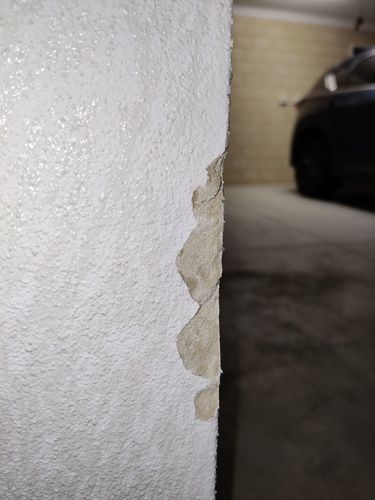

My partner was driving her car out the garage and she accidentally damaged the wall.
Please advice me how to fix a damaged wall or should I get a professional to do it.
Does anyone know how to fix it?
Thanks.

Welcome to the Bunnings Workshop community @Bhope. It's a pleasure to have you join us, and many thanks for the question about repairing your wall.
This certainly looks like a repair that you could attempt to do yourself. Obviously, engaging the services of a tradesperson is always an option.
I'd advise using a pre-mixed product similar to Poly 500g Exterior Masonry Poly. You'll need a scraper or Craftright 100mm Joint Knife to apply the filler. The 100mm width will help you establish the corner's square edges again, which will be the key to an unnoticeable repair.
You should find this step-by-step guide useful: How to render corners. It shows a similar process to what you'll be doing, except theirs is a new wall using a corner beading. Once dry, you can sand your filler to the exact shape of the corner, but try only to use just enough filler to form the corner. Too much, and it will be a pain to sand back off. Once the areas are filled, apply your exterior paint. Whilst the paint is still wet, take the end of the bristles of your brush and stipple the surface to texture it. This will blend the repair in with the surrounding area.
Please let me know if you have any questions or need further assistance.
