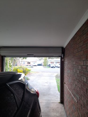

Hi looking for a quick fix for part of garage ceiling has fallen over roller door. Probably due to vibration of door going up and done everyday. Any ideas looks like it needs lifting back up maybe glueing the rest of the carport is ok.

Thanyou jacob yes. I corner has fallen onto the roller door and has been grinding on roller door there is hole on top. I will give this a try.

Looking at the photo I would say the roof sheet has dropped, which is why the cornice is only slightly cracked. This is evident when you follow the line of the brick mortar line.
A few months back I had to resolve for a client the same issue albeit the ceiling was hitting the roller door. Basically the plasterboard didn't have enough or any stud glue to the truss and overtime the screws couldn't support the weight of the screws.
If you have a tiled roof, you will need to remove a few to access the area above to see if this is the case with yours. More involved if your roof is colourbond as a sheet and top flashing will need to come off.

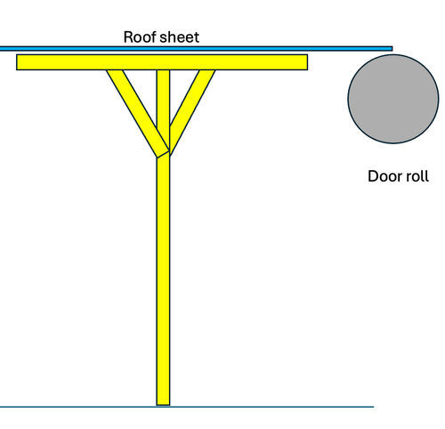

The batteries in the stud-finder were flat (of course) so, I then knocked through the top of the roof sheet a few thin nails to mark where the joists were from inside the garage. Then I applied a stack of stud glue in various spots where it was missing.
I had already prepared (and this is what you can use a temp fix) a T-prop. Which I first rest up against the dropped section of the ceiling and then tapped it at the bottom with a mallet into place. The T-prop was slightly taller than the internal height of the roof so it pushed the sheet up.
This made a few of the old sheet screws popped through incorrectly. I put new screws in and patched the areas of the old screws. Put the roof back together and left the prop for a few hours and the job was done.
I had the timber to make the frame. But you can hire an Acrow-Prop for less than $10/24hrs. You will still need an off-cut of timber to rest across the top so the top of the prop distributes evenly. The timber yard usually has free off-cuts.
