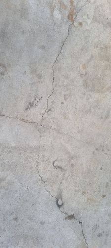

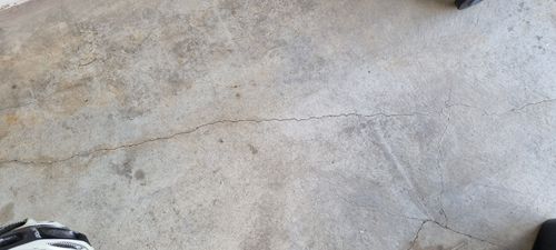

This time it is my garage, there are quite a few big cracks on the floor (as can be seen in the images), I want to understand how can I fix them, is there something similar to 'no more gaps' for floors
. Or is there a better way to fix these, I am open to all the suggestions.
Thank you.
Hi @PeteSam,
To fix those cracks, I’d recommend using Gripset Betta 1L Concrete Crack Filler. It’s designed specifically for this kind of job and is a great go-to product for repairing cracks in concrete floors.
Try to apply the filler neatly just within the cracks, avoiding spreading it too far onto the surrounding surface. Once it’s dry, you can lightly sand it back so it's flush with the surrounding concrete. Leaving excess filler on the surface can actually make the cracks more noticeable, so a tidy application makes a big difference in the finished look.
