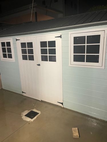

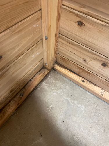

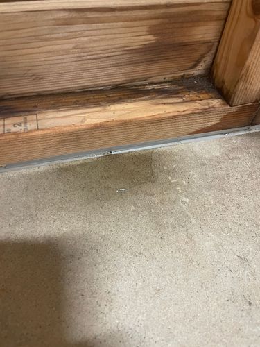

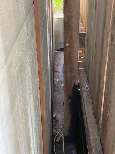

Hi everyone, am after some help ASAP! I have a cedar wooden shed that’s on a concrete slab however the slab wasn’t perfectly level and as a result the water pools at the back and seems to be either transferring under the silicone (might be a small cut or crack in it) or via the wet slab outside/the wet timber. Consequently the timber is very wet a lot of the time and a lot of water comes into the shed. I did silicone the inside and as best as I could on the back but there is only 30cm of room (if that) as the back of the shed is up against the boundary fence. Any suggestions as to what I could do? Happy to unbolt the shed from the slab and fix it that way if need be. Pictures attached below. Thank you!

Any shed placed on a concrete slab will likely leak under the wall; this is an extremely common issue. To explain further, a shed slab needs to be created specifically for that purpose. The slab must have an elevated portion for the shed's footprint, and then directly outside the walls, it must drop away slightly so that any water that falls on it can't seep under the walls.
You'd need to seal the exterior side of the wall at a minimum. Sealing the interior only stops water from seeping under the wall and coming inside, but it leaves the wall susceptible to soaking up the water, which is the case here. This guide offers a solution to preventing water creep under walls: How to waterproof a shed floor.
Since the slab is sloping towards the shed, I suspect this will be a bit of a battle to overcome. Adding an aluminium angle as per the guide above might provide enough of a water stop to prevent water on the slab from accessing the wall. Installing the angle in such close quarters might prove difficult, though.

I was thinking of a small awning at the base of the wall next to the fence, maybe a 40mm piece of aluminium to take the water away from the base but still think it would hit the slab and pool back towards the timber base.
Second thought was enlarging the eave of the rear of the shed to keep the water off the wall, maybe even having an eve with a gutter at the top of the fence level so you can access it for maintance. That way you stop the water running down and pooling.
How uneven /sloped is the slab? Does the interior need to be dry? If it dosnt then raising the shed onto some non porous material by even 1cm will stop the seapage along the timbers. Just looking through your photos again, there dosnt seem to me much of a gutter to the roofline? Could you install one to capture the roof water and funnel it away from the slab?

Hi @cjl1989 is it feasible to unbolt the shed from the slab, and raise it off the slab with chocks of timber or spare bricks. Then fastening siliconed 25mm square gal tubing all the way around the shed's footprint and then fix it to the tubing. Underlying low points could be packed and siliconed. A big job, but would prevent the timber shed from water damage and solve the water ingress. Shed doo opening ramps are viable to stop the trip hazard on entry/exit.

Hi everyone, your responses were amazing. Managed to follow the guide sent by Mitchell and no leaks whatsoever even with all the pooling that I was getting at the back of the shed. Getting behind the shed was fun... but managed to get it all sorted. Many thanks!
