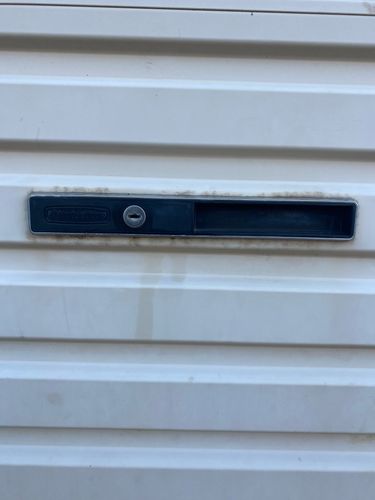

Hey I just fixed a roller door and the lady owner has no keys,I believe there’s a code on that lock somewhere,so question is does Bunnings cut keys to that code
Hi @jackndiane
The code identifies the type of key to be used, but it does not indicate the cut to be made on the key. If it uses a traditional twist to lock system, it might be compatible to either the Liftaway LA132 Universal Garage Door Lock or the Liftaway Front Fix T-Handle. If you can take the old locking handle with you to compare it to the ones available at the store, that would be the best way to make sure that it will work with your roller door.
Thanks Eric it’s kind of like the LA132 and the piost here say it’s a poor design don’t buy it so I will have a look around
