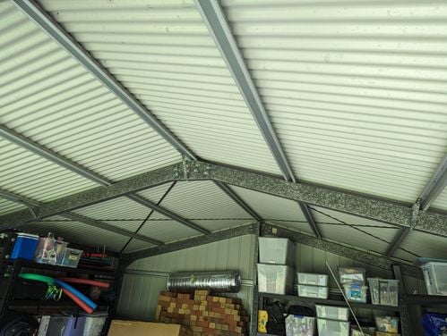

Hi, I have a 6mx4m double shed with steel frame.
I am slowly setting it up as a gym space and want to hang a 6ft heavy bag approximately 50kg from the ceiling.
I also have a TRX mount that I also want to hang from the ceiling.
I'm happy to add framing to the ceiling.
I want to maintain the structural integrity of the shed while being able to hang both items.
I am looking to use this mounting piece door the heavy bag
I was also thinking of adding a spring between the bag and the mounting point to reduce vibration.
I've seen other posts stating adding wood into the C channel beam and then bolts through to that to share the load.
Ultimately I just don't want the shed to fall over so structural integrity is my main goal.
As for mounting location I was either thinking in the C channel beam in the middle or adding additional framing in the back half of the roof.

It's good to know that you've had a look at some of the discussions regarding hanging a boxing bag. The amount of pressure being applied to this sports equipment is no joke. That force will then travel through its structure and onto where its hanging.
Your steel roofing frame has been designed to hold a certain amount of weight which includes the purlins and roofing sheets. Hanging a 50kg bag should not be an issue but reinforcing it to handle several hundred kilos of force is another matter.
I propose building a timber frame between the posts of your steel shed. The timber frame can be reinforced with steel angles and anchored onto the shed's posts. I then recommend attaching an Everlast Foldable Boxing Fitness Training Heavy Punching Bag Hanger Black or RTM Heavy Duty Punch Bag Wall Bracket onto the timber wall. You can then hang the bag onto these hangers.
The force generated by your punches and kicks will get absorbed by the timber framing and greatly reduce the force being transmitted to the sheds steel posts.
However, if you are still keen on hanging the bag onto the roofing frame, I suggest engaging the services of a structural engineer. They will be able to suggest the type of steel reinforcement needed to hold the bag and absorb the force being transferred to the bag.
Let me call on our experienced members @Dave-1, @TedBear and @JoeAzza for their recommendations.
Sounds perfect I am going to go ahead and reinforce the shed wall as suggested and then get a mounting bracket for the side.
I am going to solve my TRX mounting hook problem by just bolting my squat rack into the ground and using the pull up bar off that to mount it so that it doesn't tip over.
